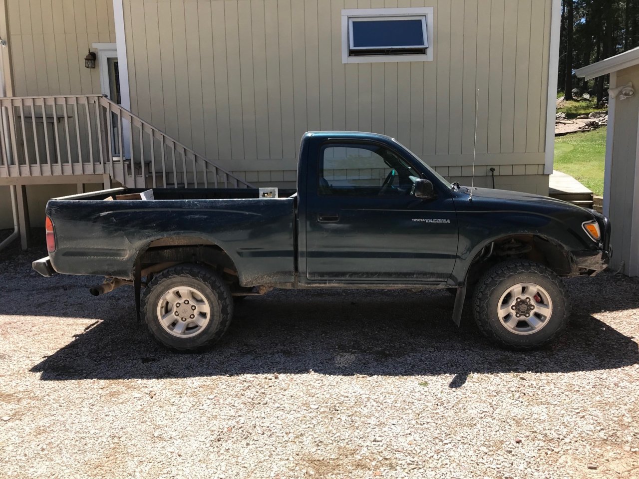

    The spring removed was the 3rd spring from the bottom as per the fine folks from wheelers offload, fairly straight forward removal REALLY made a difference. I have to scrounge for the pics but will post when I do find them.

    I did not take any pictures of the truck when I first put the suspension on, only after the leaf removal.
