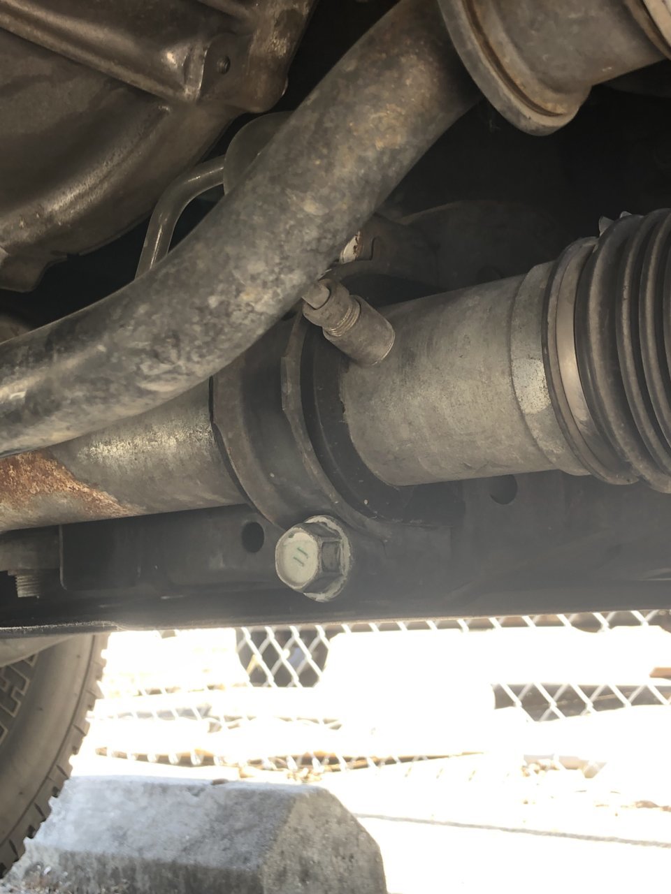

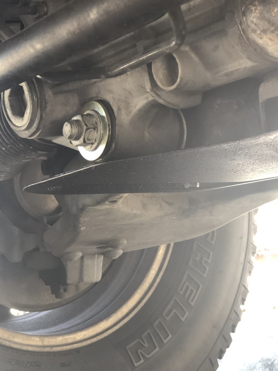

    Specifically, which bushing did you replace? And are they properly torqued with washers ?
    Be sure there are washers in front and rear in first photo
    And I’m assuming you replaced the bushing in the second photo since that one is easy.
    Since there is 1/4” clearance you should see movement down below if you have a friend move the steering wheel. Tighten those bushing screws up and see if your clearance is reduced

    First pictures bushing came already came new with the rack and pinion. the second pictures bushing/clamp got reused.

    As they wear you're able to tighten them down in order to maintain a good steering response.. Eventually they need to be replaced.
    Should verify those bushings are secured down nicely
