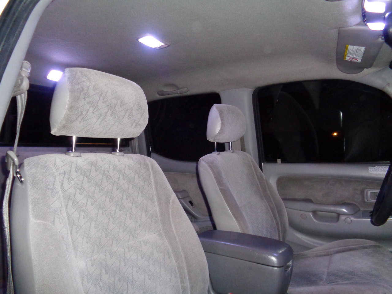

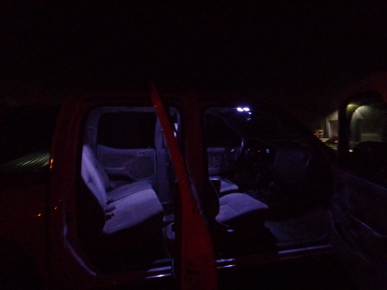

    I put a map light dome light combo from a limited 1998 in my 2003. I would look for one in the wreaking yard. Get all the wire you can with it. It has the two map light switches along with a door switch between them. Now I have tundra wiring, but you could fish power from the dome light. When I got my truck I was not happy with the lighting. Just the center light would come on. Now I have this when unlocking my doors and opening them.DSC00493.jpg DSC00495.jpg
