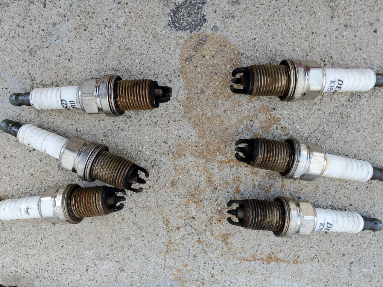

    Okay before I could make around the corner it started to misfire and same code came up. Went ahead replaced the spark plugs and factory wires. Wires are real nice as they come loomed with all the fittings. When pulling the ngk wires I noticed cylinder 2 slipped out with no resistance. I tried pushing back in but it wouldn't sit. Anyway after I replaced the plugs and wires it's running smooth again.
    Those are the plugs that were pulled out. Cylinder 5 plug had oil on the threads. Would that be a sign I need to replace the valve cover gasket? Thanks again.
