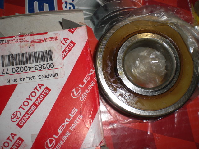

    I am wondering if anyone can confirm that new OEM Toyota rear wheel bearings are sealed? I am looking at having to have a passenger side rear axle seal done and my understanding is that if the gear oil has leaked past the seals to the brakes and gotten on the brake shoes that not only do those need to be replaced but the wheel bearing as well. I recently watched a video and Have had other people tell me that the gear oil can get into the casing of the wheel bearing and wash away or deteriorate/contaminate the grease that lubricates the wheel bearing as those are lubricated with grease not oil. So it can cause the wheel bearing to develop play overtime which would cause more wear and tear on the seals causing them to leak prematurely. Local shop is telling me that those wheelbearings are sealed so that they can check them but it’s not absolutely necessary to replace them as long as they are still OK. This is contradicting what I have heard can anybody verify that they must be replaced or not? Thanks.

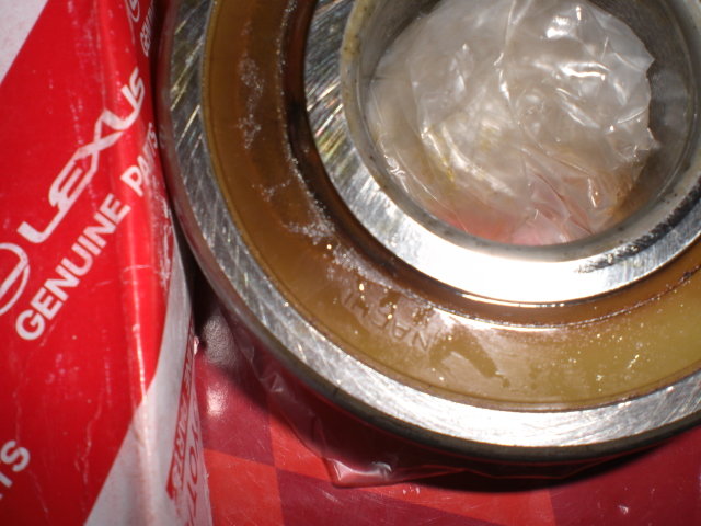

    No, its sheilded, but not sealed.
    If that gear fluid gets to the outer hub....it has to go around that big bearing (unlikely), or tru it...

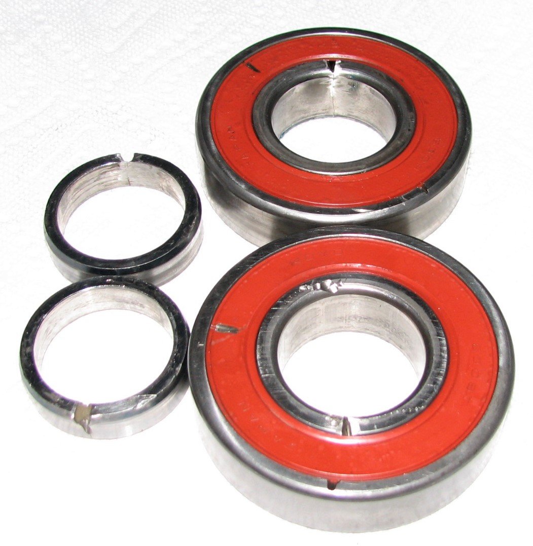

    The OEM rear wheel bearings on my '97 V6 Taco 4x4 were sealed, not shielded. The clearance on a seal is normally much tighter than a shield. I learned that the hard way on the low hanging idler pulley bearing on the V6. But if you bath a sealed bearing in enough gear oil/dirty water/etc., the bearing will probably become contaminated & fail prematurely. When a press is not available, I simply split the old rear axle bearing/keeper off the rear axle (as shown below) and gently hammer the new bearing/keeper back on the well-greased axle using a split bearing/keeper as the driver. And as previously mentioned, McGeorge has been great to deal with for OEM parts. But occasionally, I do find a better price elsewhere so shop around before buying.
