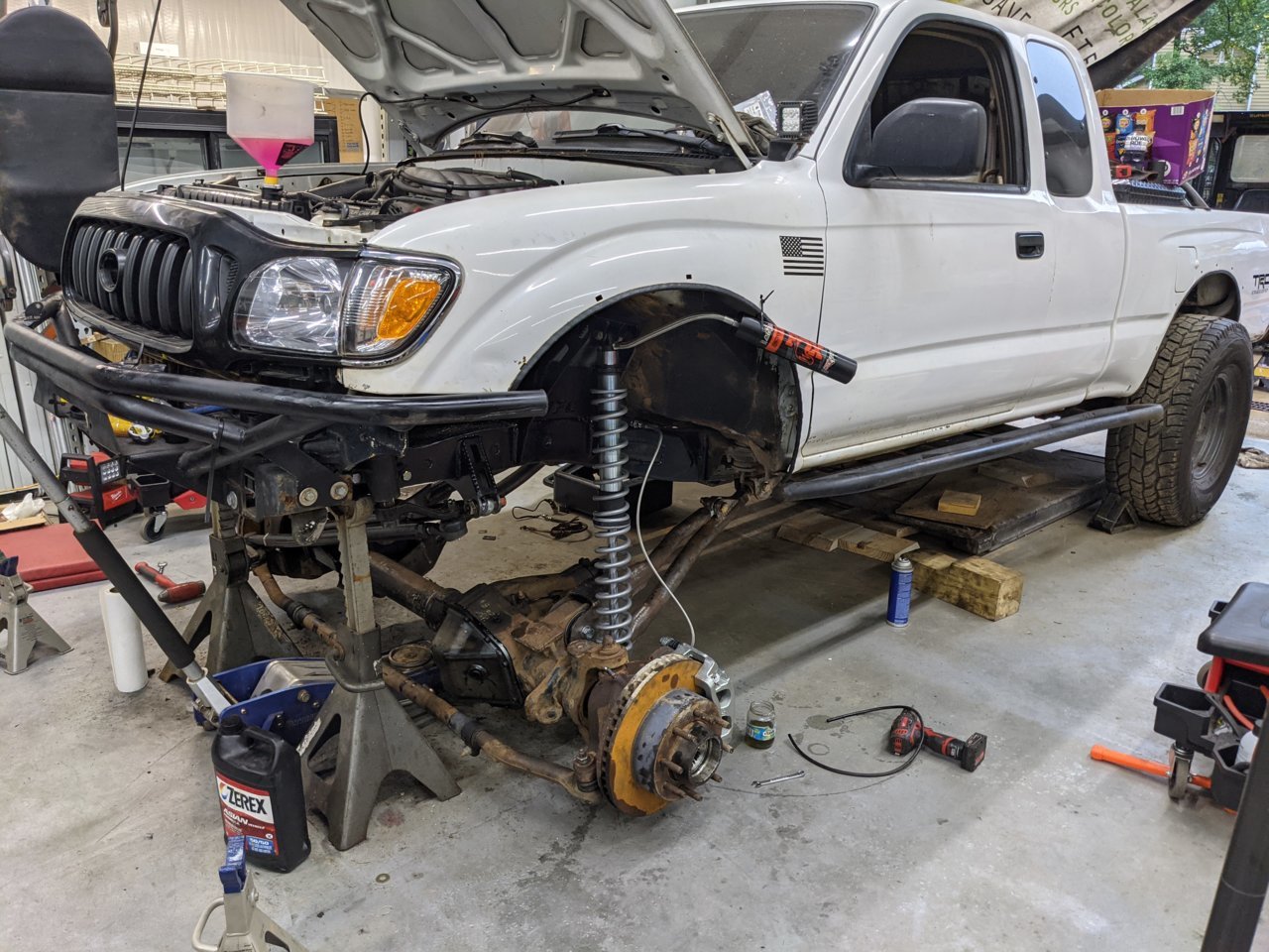

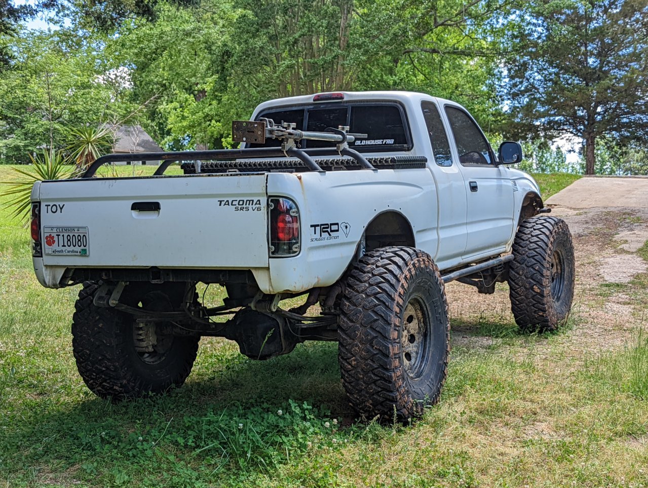

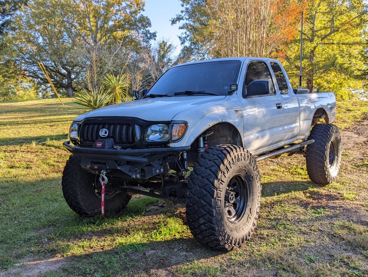

  15. Jul 20, 2022 at 1:20 PM
    #35
    suttonkb
    suttonkb GO TIGERS!
    Sep 25, 2011
    #64119
    1,915
    Kevin
    Clemson, SC
    2003 Tacoma SAS incoming
    Finished up the sas for now using the super duty axles. Gotta eventually weld on the histeer arms and redo the bumpstop cans but it works great and drives 80 down the highway with no issue.
    mtnkid85, Fernando, ShimStack and 7 others like this.
