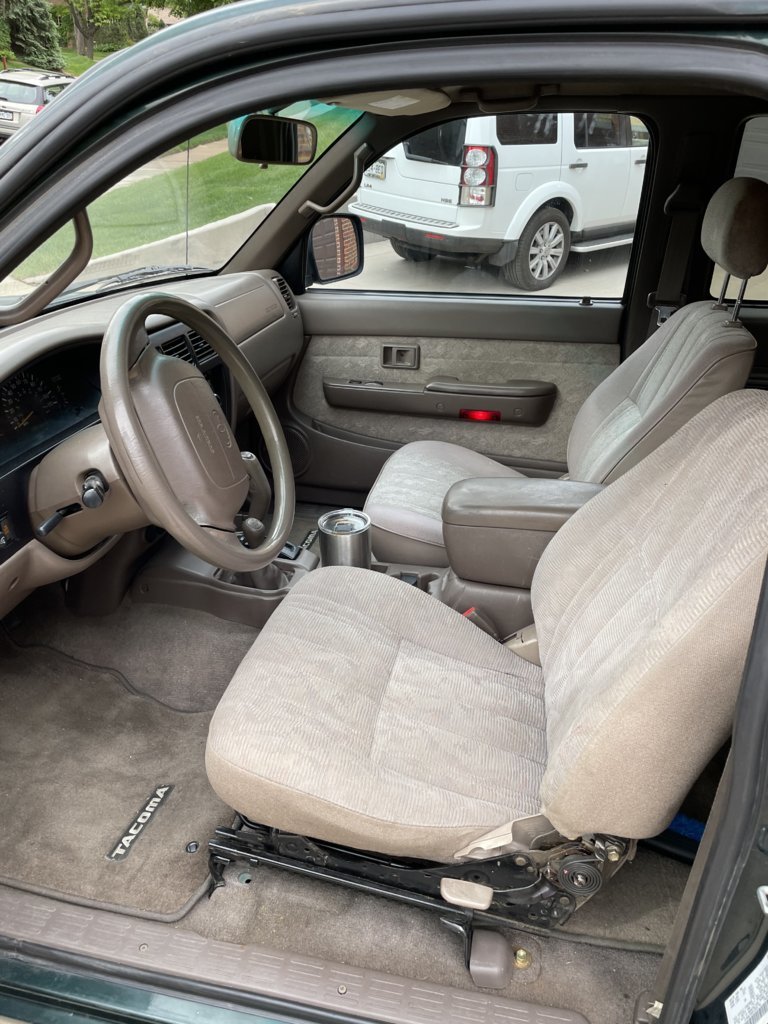

    The extended cab buckets should work as is. As stated a few times prior, you may need to swap the buckle out of your bench to the new seats. I had to do this when I swapped my bench with 4Runner buckets (don’t worry it’s easy). If using 4Runner seats you’ll need to bend a rail tab in the front down slightly as Tacoma has a sharper angle than the 4R, and either drill a new hole for the outer back rail hole or use the adapter that a TW member sells here. When going to buckets you’ll have the opportunity to get a center console as well. I had to cut holes in the carpet for the console but the screw holes were there.

    -Price is usually ~$75-$150 range for the pair. The center console is in about the same range unless you can snag one from the junkyard (be sure the grab the console bracket too!). The harder seat to find is the driver seat, you can often find the passenger for free/cheap
    -You should have the holes, you can check as they should be roughly on either side of the “hump.” You may have to cut some carpet away after removing the bench, and they may be plugged with some sort of epoxy/plastic that you’ll need to drill out, but it’s easy (I had to do this only to install the center console)
    - The front tabs where the bolt holes are need to be bent at an angle slightly, it’s easy with a mallet once the seats in place
    This install is quite easy, you’ll likely have to swap the seat buckle from your bench to the new buckets (one bolt) as the 4R uses a different seat belt than the Tacoma for some unknown reason. You could also swap the seat belt from the 4R instead but that’s more work.
    here’s the after (I used to have the 60/40 bench) - if you look at the front bracket you’ll see the Tacoma is at ~90 degrees, that 4R seat was more like 60 degrees before bending. On the back of the bracket, zooming in you’ll see I drilled a new bolt, the TW member has a little adapter that will allow you to use the factory bolt location instead if you don’t want to drill. The other bolt locations lineup without jimmying
    EDIT: NZBrock is the TW member, looks like they have a site now for the adapters: http://nzbsculpture.com/store/4runner-seat-adapters
