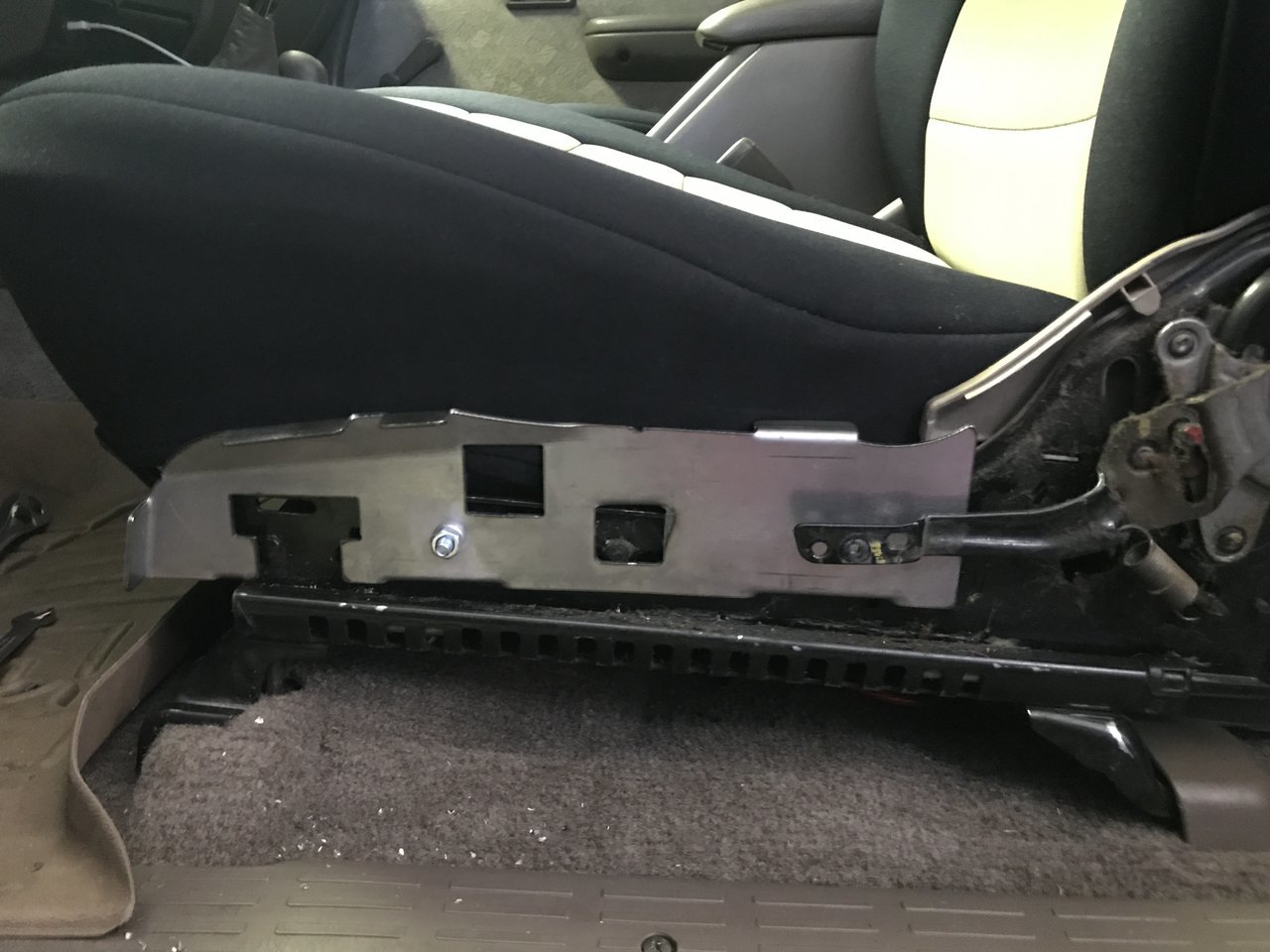

    My drivers side was easy. The passenger side I could not use the bolt in the bracket .
    The seat mechanism for the slide was in the way. I had to drill asmaller hole in a different place and use a smaller bolt.

    Finally got mine installed. Much more solid than before

    Looks like its not level/straight across with track. Looks like it worked though.

    Yeah I just mocked it up and drilled it in place so that the plastic trim lined up with the seat plastic. Worked good. Thing is solid on there now

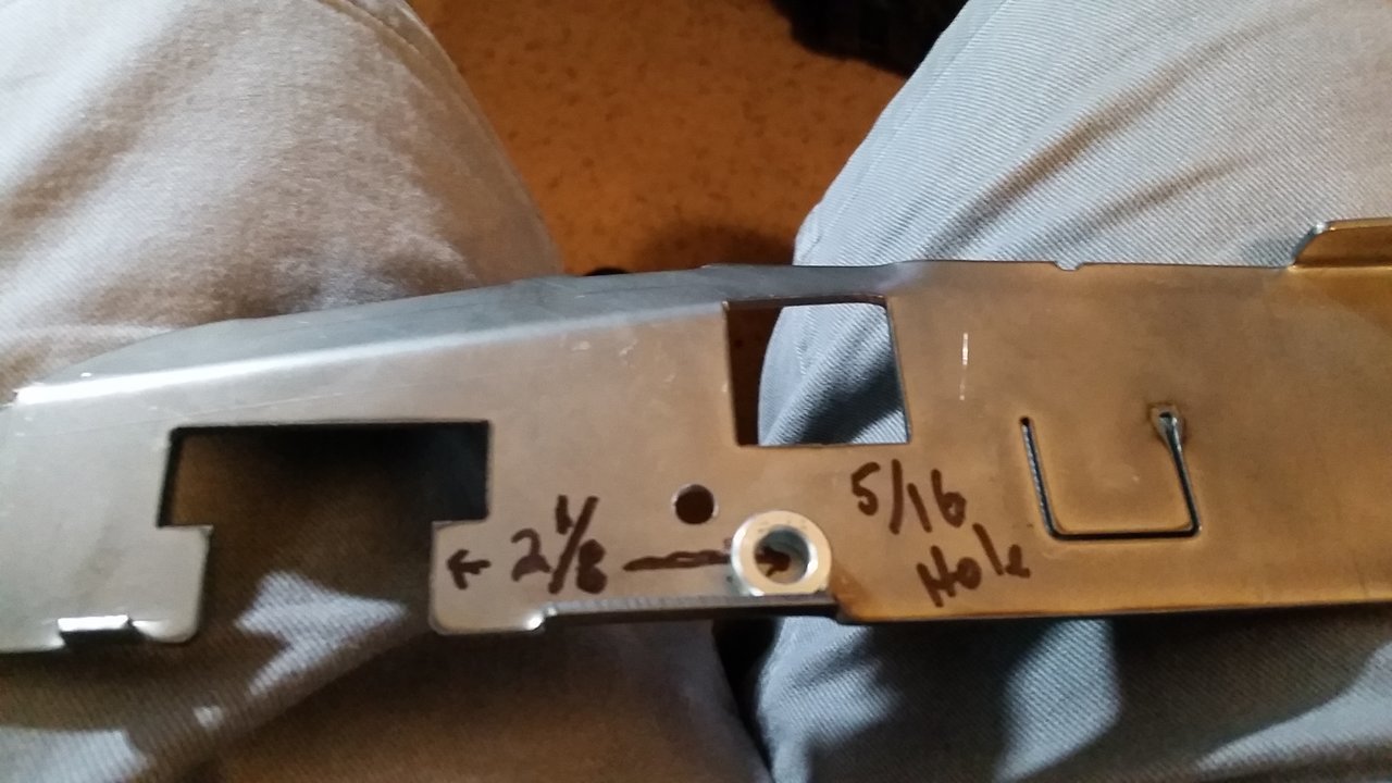

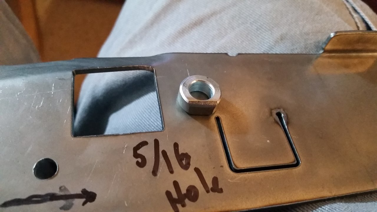

    Here's what I've come up with for the passenger seat in the extra cabs.
    You'll measure 2 1/8 from the edge and use the spacer (I'll be sending those out to who ever needs them) to line it up.
    Then drill 5/16 hole. Use the bolt that retains the tilt mechanism to bolt plate and spacer on. Discard the 1/4 inch bolt and nuts provided.
    This is the place the spacer will go.^^^^^^^^^^^^
