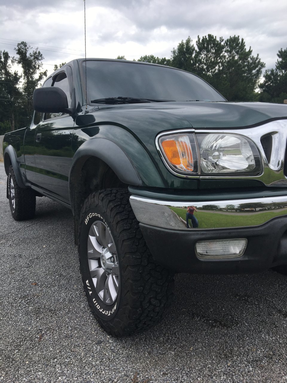

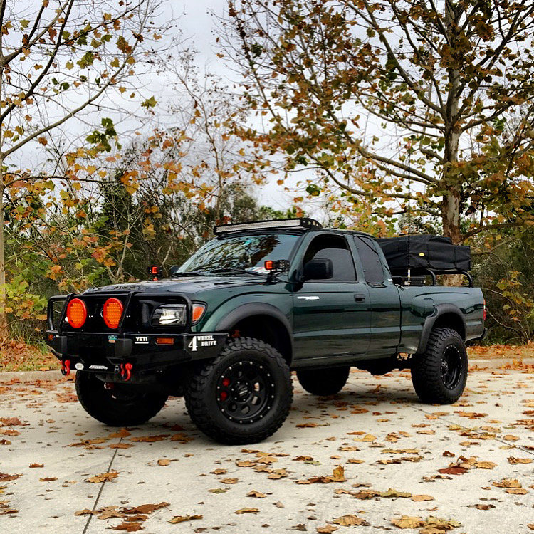

    Hi there! I actually just got another Tacoma because my 2002 was totaled while parked outside my house a few months ago! But now I have a 2003 and I just ordered an OME Kit with their Add-A-Leaf on HeadStrongOffroad.com! It should be coming tomorrow! But I went ahead and requested the 883 Coils and the reason I chose the Add-A-Leaf, was because my other truck ran an add a leaf and it performed just fine, as well as held my RoofTop Tent perfectly fine without sagging! And my current truck’s leaf springs don’t squeak right now either. I heard lots of ups and downs about some squeaking issues over time with new leaf packs! Here’s a picture of how my truck set before it was totaled and here’s one of my current truck Haha5CD75449-6B6B-434A-B709-CFF1B81C0FD8.jpg ! #GreenMachineLives
