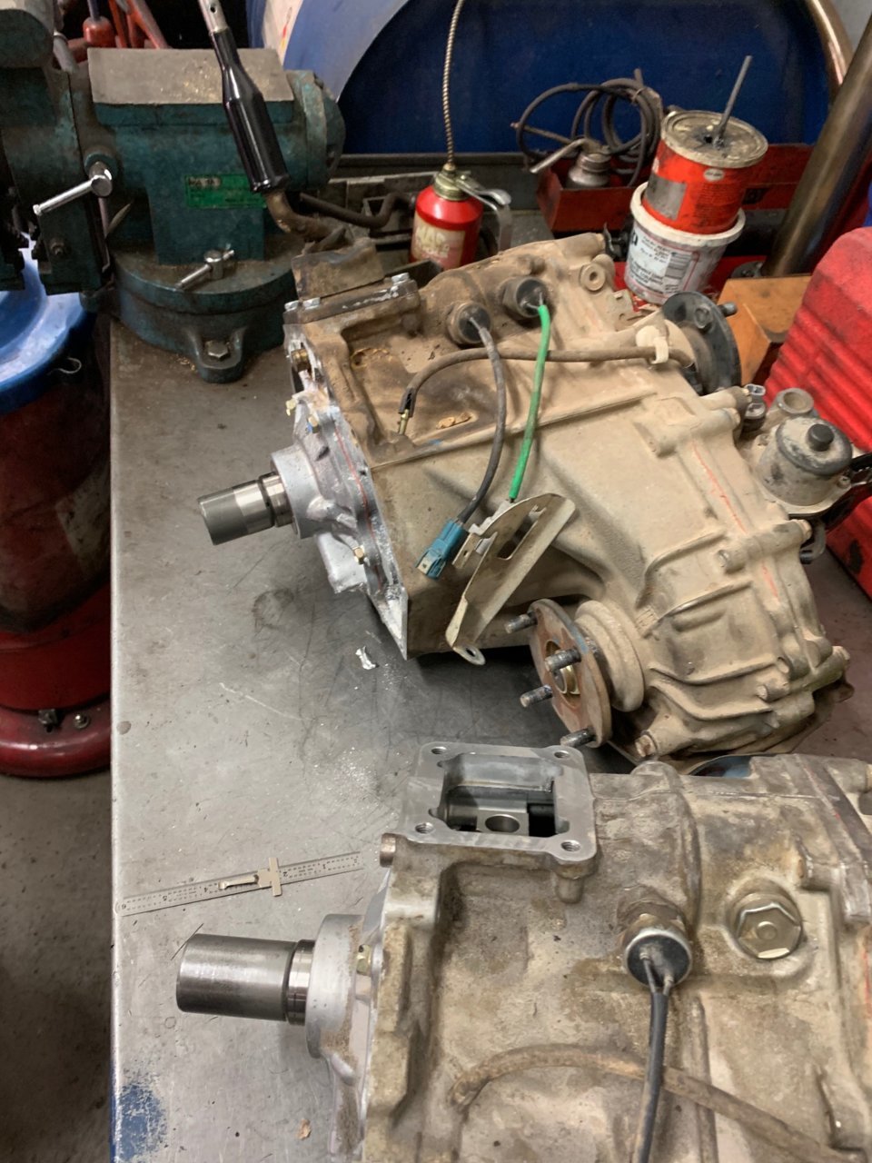

    I cant seem to find a matching case anywhere. I have a 2001 with the elocker v6 automatic, and add but I bought one out of a 2003 and the input shaft is different, its shorter and has another bearing surface.. Any one got any spares or ideas? It looks the same as the 4runner ones but the add plug is different. I would like a used one or maybe a line on a rebuild?

    Pic of one you bought?

    Mines on top the other was out of a 2003 that seemed to have all the exact same stuff, I want to guy one of those seat trim supports too.

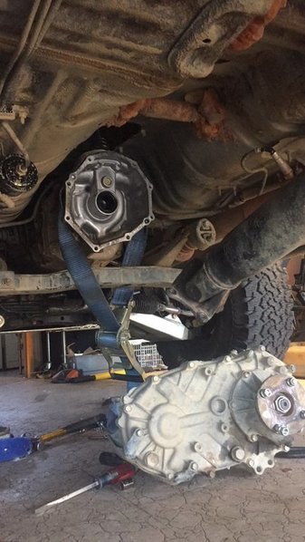

    I had a manual and bought one from an auto. Also noticed the difference in shaft length, but it worked perfectly!
    It will work. Just swap all the sensors over

    oh man! I don't know, that shiny part on mine is thicker there is a bearing that runs on it and the other shaft won't even be touching it its like 2mm thicker. How long ago did you do it?

    Did it in 2016.
    My 5 speed t case on the left replaced with the auto t case on the right

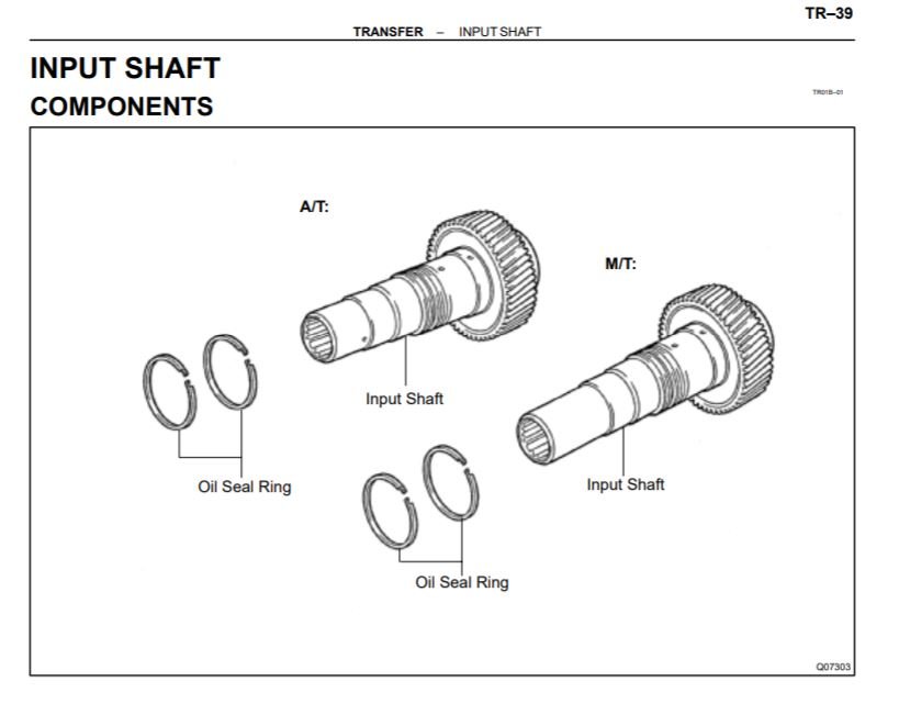

    By the looks of the 2001 manual. The auto and manual shafts look different.

    not saying it wouldn't work but looks different.

    They are different

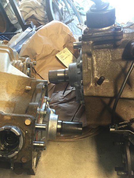

    its definitely different, and then there is that sensor

    Mines add shift on the fly

    Are you talking about the round sensor? If so you remove the sensor and it installed right where the “plug” is on the other one.
