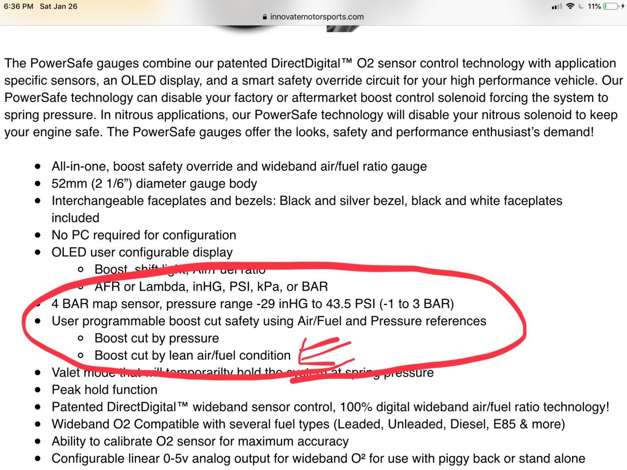

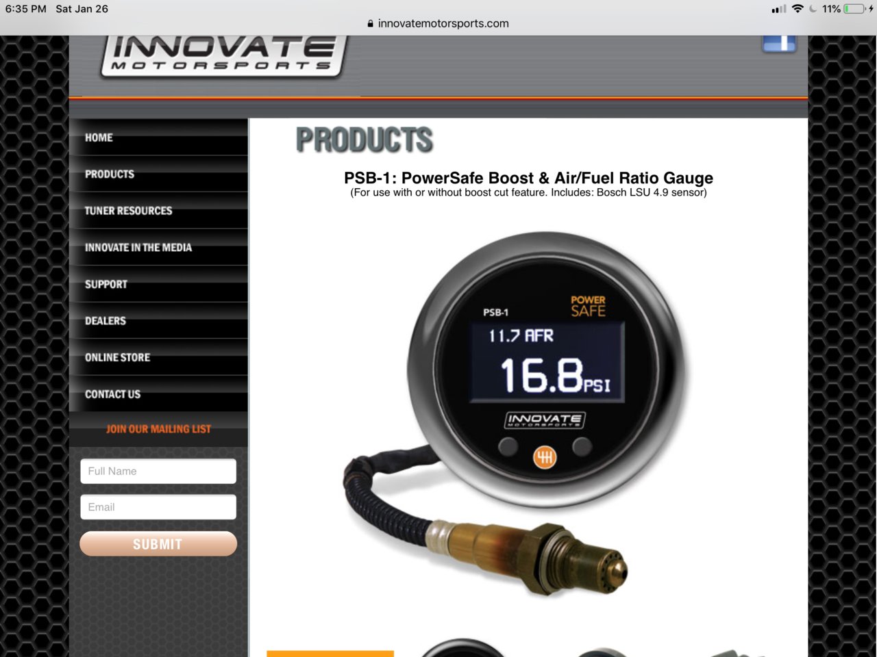

    I need to get a AFR guage soon,
    Do you know anyone with the Innovate PSB-1 guage?
    This is a really slick combo guage
    I like that you can set it to shut the boost or cut the boost if there is a lean condition happening with
    the AFR. Would be a great failsafe for the methonal kit.
    And that it’s in one pod both the Boost and AFR in one.
    I’m probably going this route in a few months
    Innovate PSB-1 PowerSafe
    eon_blue[QUOTED] likes this.

    How does it kill boost with these blowers?

    ya, its not like it could disconnect the belt, thats probably for turbos.

    My guess is it uses a solenoid to open the blow off valve.
    Edit- Yup, solenoid...it's in the description

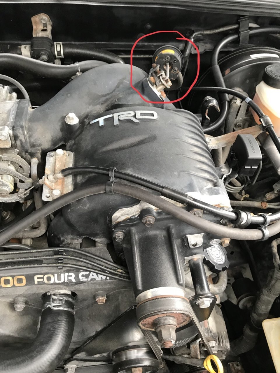

  15. Jan 30, 2019 at 11:24 AM

    ya that's your blow off valve

    how come i never hear it when i'm driving?

    actually I stand corrected, I think for our superchargers it's called a bypass valve technically, not a blow off valve like what turbos have.
    Not sure of the difference but it doesn't make that "pssssshhhew pssssheeew" sound that a turbo's makes lol

    shouldn't it still open when you let off to "vent extra boost"

    Interesting -
    https://www.enginelabs.com/news/blow-off-valve-vs-bypass-valve-whats-the-difference/
    I knew zero about forced induction two months ago. Now I know just slightly more than zero.
