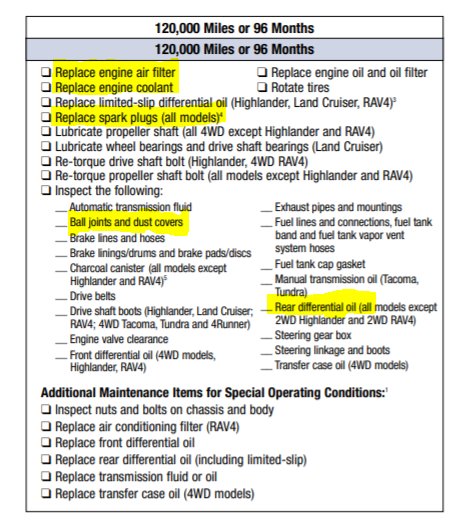

    You mentioned oil and trans fluid, might consider these as well.
    Once done, get into the habit of changing the oil on a regular basis.
