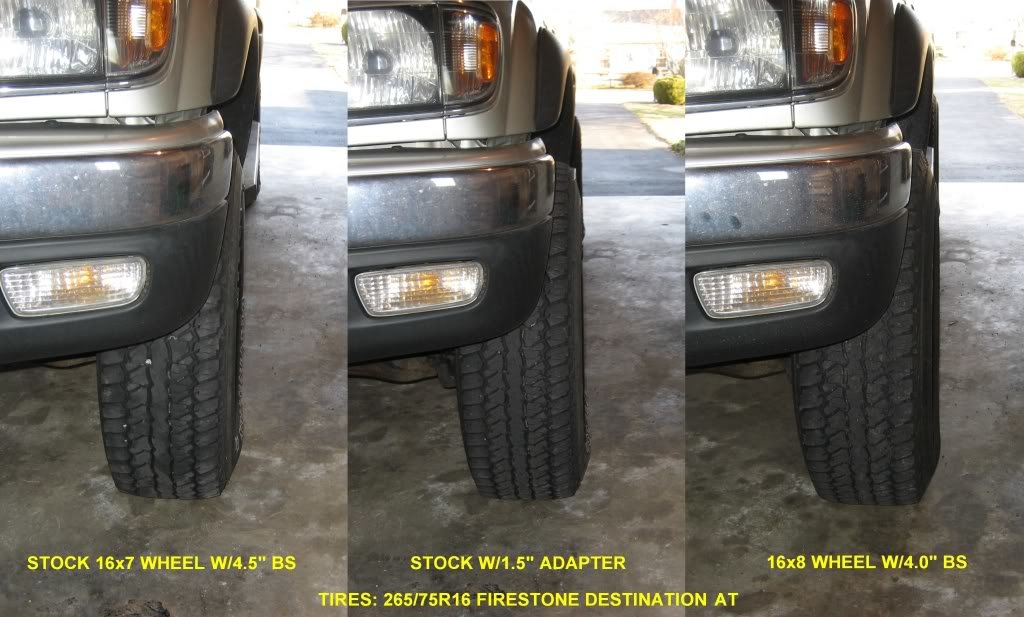

    I just swapped out my stock wheels with wheel adapters for new wheels with the proper backspacing. Took some pics to show the difference.
    I believe you have that backwards, although the terms get thrown around interchangeably.
    Spacers = a disc (typically with a bunch of holes to accommodate various lug patterns) for the purpose of small decreases in backspace and for making wheels fit.
    Adapters = a solid chunk of aluminum with wheel studs installed for the purpose of changing bolt patterns to adapt to wheels with a different pattern. Since they have new wheel studs they can be much thicker and used for larger decreases in backspacing.
    Not trying to nitpick, just clarify. Living in PA where the law says you can only have a maximum 1/4" spacer you need to be able to argue that a 1.5" adapter is different and therefor legal. ;)
