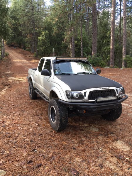

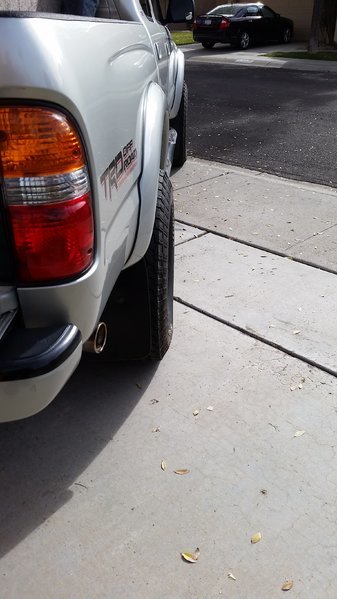

    Thanks! Here is how it looks currently. Different tires! LOL!

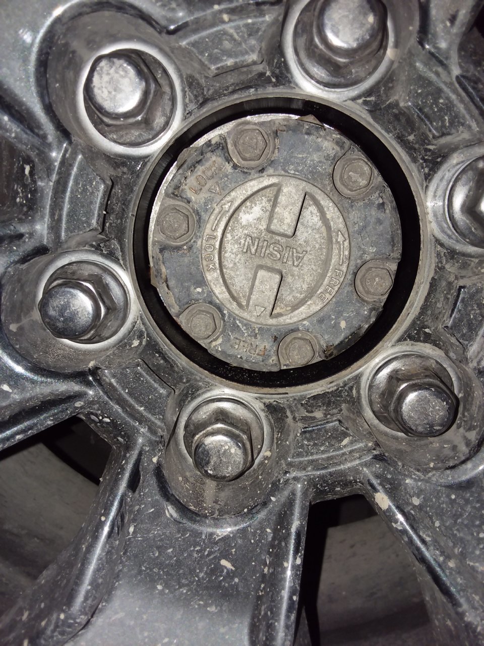

    1995.5 Tacoma 4x4 2.7L Single Cab

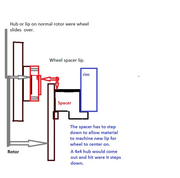

    Do hub centric spacers fit right over the manual locking hub or how does that go?

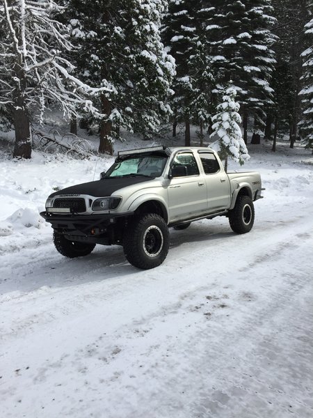

    1998 White Tacoma TRD
    Looks badass. What headlights are those? I've been wanting to upgrade the stock ones in my first gen. It's very dark at night here and there's deer all over the highways so I want something a bit brighter but without being obnoxious to other drivers.

    There HID Retrofits w/ halos. Very bright too. They're hand made by @Roo1041

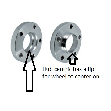

    mechanicjon
    mechanicjon They call me "Jonny Stubs"
    Dec 2, 2016
    #203828
    10,074
    Jon
    Scottsdale Arizona
    04 Taco SC 4dr SR5 TRD Prerunner
    Supercharged, AEM FIC/6, Meth Inj, ION Alloy's, Radio & Phone steering Wheel controls,Fabtech AAL, Billie's wrapped with 880's , Tundra big brake conversion, bully bars and Pioneer DDin Stereo/dvd with exterrnal usb ports. 290K and going strong.
    No. The inside of the spacer steps down to give the wheel a hub to line up on. You can get a spacer but not a hubcentric spacer.

    Ok that makes much more sense with the pictures, Thank you!

    Forgive me if this sounds dumb, but wouldn't the spacer be just like the inner bore of the wheel if there were no spacer? I was thinking you could install them and just reach inside a little to turn the hub to lock. Is this not so?

  11. Feb 7, 2017 at 9:04 PM
    #71
    mechanicjon
    Dec 2, 2016
    #203828
    10,074
    Jon
    Scottsdale Arizona
    yes and no. The wheel spacer steps down to allow for basically another hub for wheel to slide over. My art sucks but maybe this will help.

  12. Feb 7, 2017 at 9:19 PM
    #72
    Dalandser
    Dalandser ¡Me Gustan Las Tacos-mas!
    Feb 19, 2015
    #149090
    16,692
    Anthony
    Downey
    08 PreRunner Regular Cab / 98 4x4 Extra Cab
    Empty Wallet Mod
    Got it. My bad on that one - and your written explanation was so good I didn't even have to look at the picture, which is also really good lol. Thanks Jon! Another solid piece of info. :cool:

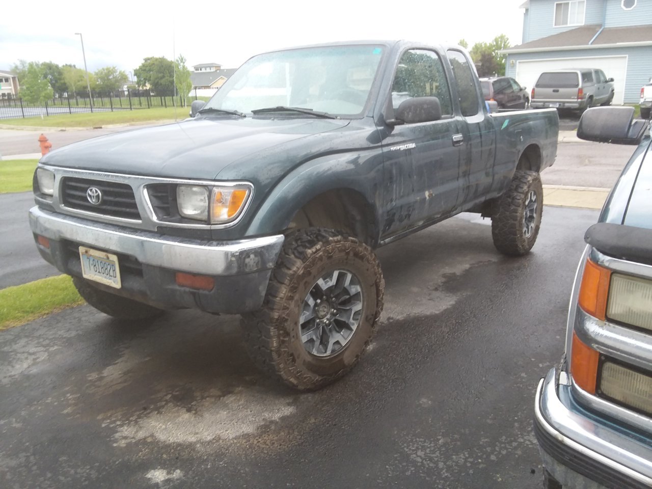

    I went the next size up on rims and tires from factory size. Had to get spacers, Old Man Emu Dakar leaf springs, Bilstein 5100 series shocks, Marlin Crawler clutch.

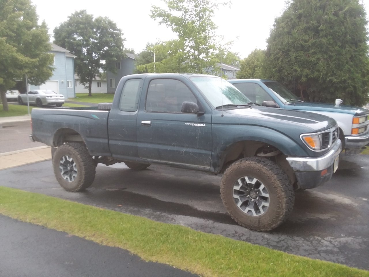

    95 Tacoma XL 4x4, 4 cyl, 2.7 ltr

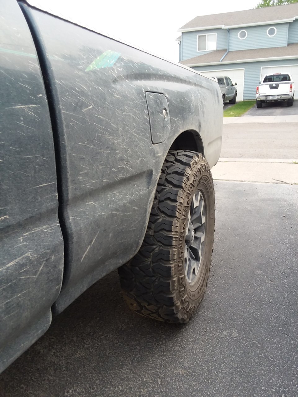

    On the pics above I have 1.5" spacers and I lifted my taco by putting on Old Man Emu Dakar leaf springs and Bilstein 5100 series adjustable shocks. Taco is a 95'.

    Can you pass me a link to the spacers you are running?

    What brand of spacer's are you running? How have they held up?

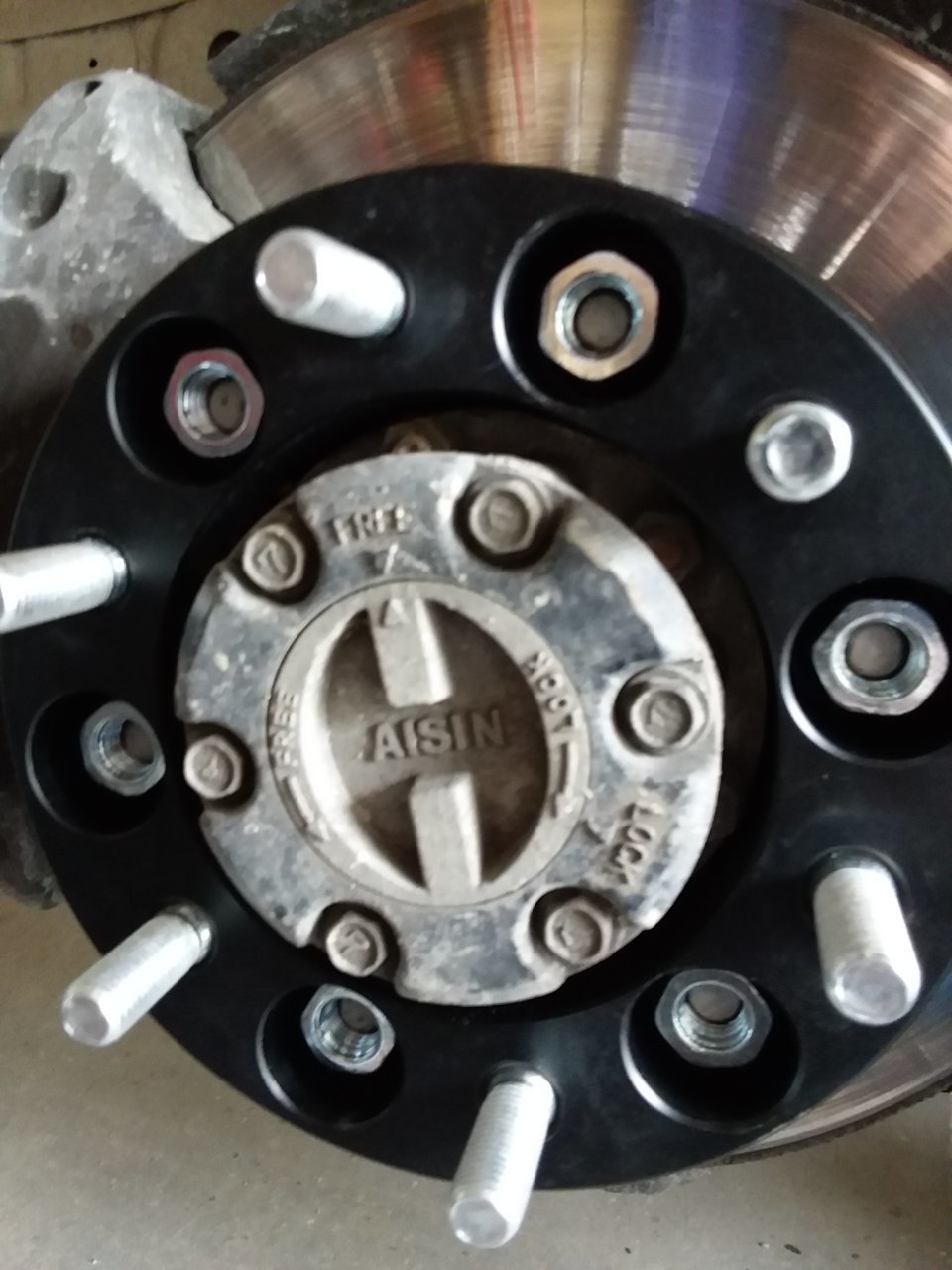

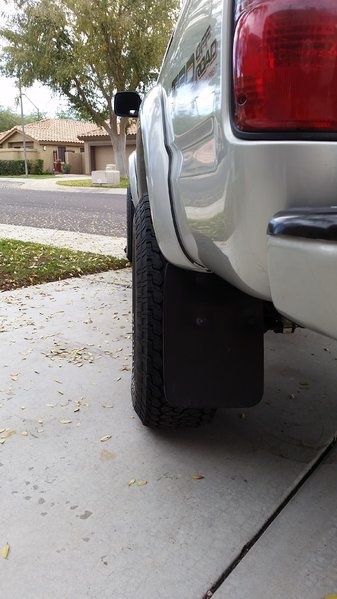

    2004 Tacoma TRD
    The picture of your spacers show a lot of unused threads on the spacer nuts. I just ordered some spacers, did a test fit and mine look the same, is that normal? Have you had any issues?

    cxr turbo, fic6, methanol injection, king coilovers, jba uca, skyjacker leafs, rear 12" 5125s, no-slip rear locker, 35" grabber x3, magnaflow muffler, retrofit headlights, trans cooler, bed lined exterior, etc...
    dont be like that guy. on the front you should be using longer wheel studs extended thread nuts can work too i guess
