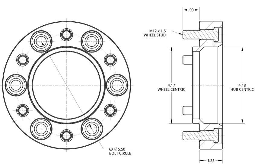

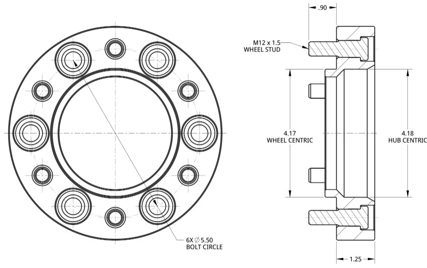

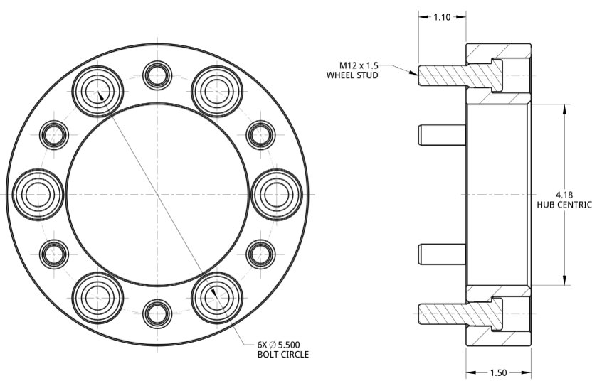

    I'm trying to decide between Spidertrax 1.25" vs 1.5" for my 1999 Tacoma. The plan is to run 285s on 16x7 stock steelies that i found for cheap from a 04 tacoma but they have 15mm offsets hence I need some spacers to clear the UCAs. I have bilstein 5100s all around w/ AAL in the rear (2.5" front/2" rear).
    I think the 1.25" WHS007 would do the job but why does Spidertrax only list the 1.5" WHS005 (http://www.spidertrax.com/products/1995-2000-Tacoma-4WD) as the only option for 1995-2000? I thought both types are hub centric and are interchangeable for all first gens?
    PS: I called spydertraxx but didn't get a clear answer so Im hoping someone could tell me to save me some hassle of buying and returning. Thank you in advance

    A. Spydertrax will work no problem and the hub bore is the same from 95.5-present on all Tacomas, T100's, and 4runners and 1st gen Tundras and Sequoias.
    B. Hard to say but I'd imagine it would clear the UCA.
    C. You should use these extended lug nuts or ones like this at least up front with the shorter amount of wheel stud sticking out from the rotor.

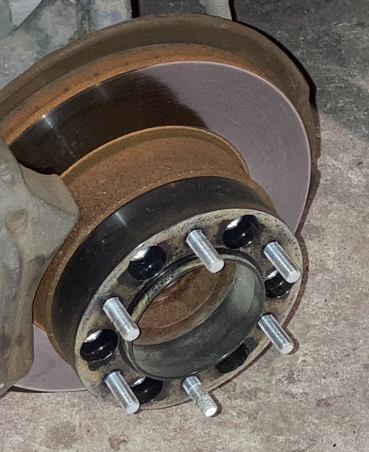

    I have almost the same setup and have 1.5" on one side and 1.25" on the other. I was able to get these ordered from https://www.motorsport-tech.com/bora.html

    Thanks for quick response and the link. The same hub bore is I was trying to explain to the sales rep over the phone but he kept insisting that "If that part WHS007 fits your 1999 tacoma then we would've listed under that option!" So I just resorted to TW for better expertise lol. I'm gonna run the 1.25" until I save up enough for some wheels with proper backspacing
    I can only speculate that the reason why they only list the WHS005 for 1995-2000 is due to the longer stud lengths but not too sure other than that

    like this?

    Most pre 2000 Tacoma’s have manual locking hubs, and the hub centric section of the spacer will not fit around the hub. I believe that is why they do not recommend them.
