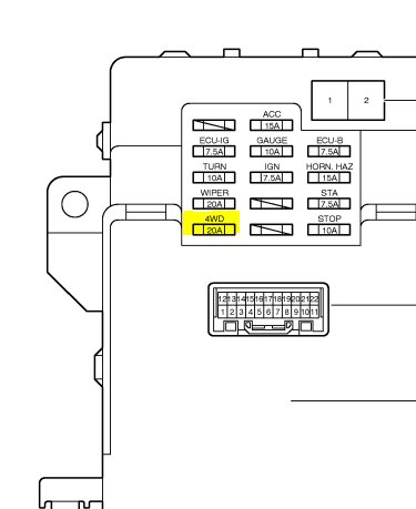

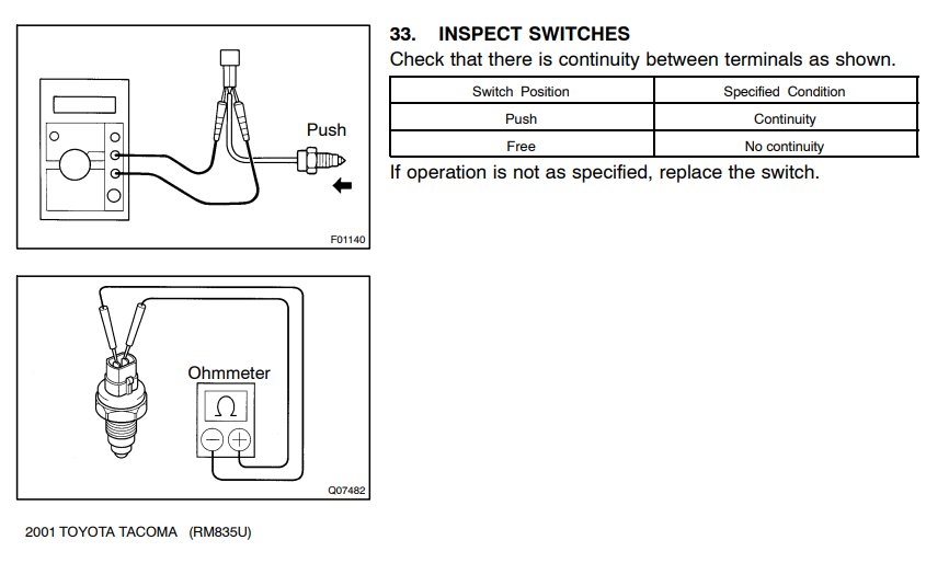

    Did you check 4WD fuse and 4WD position switches?
    4WD fuse
    Wire harness
    Vehicle speed sensor
    4WD position switch
    4WD indicator light
    Actuator assembly
    A.D.D. control system
    4WD control ECU
    Transfer assembly
    james99_[OP] and Digiratus like this.

    So I checked all of the fuses. All look good
    Area51Runner likes this.
  12. Mar 30, 2023 at 12:35 PM
    Area51Runner
    Area51Runner Well-Known Member
    Jun 26, 2014
    #132748
    11,987
    Northern California, Bay Area
    02 3.4 DC TRD PreRunner 4WD SWAP
    james99_[QUOTED][OP] likes this.
