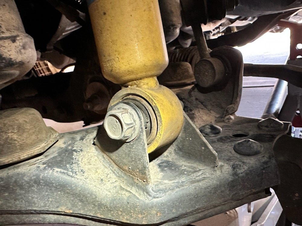

    Pulled the wheels this morning. Both sides, the shock bushings were spilt pretty good.

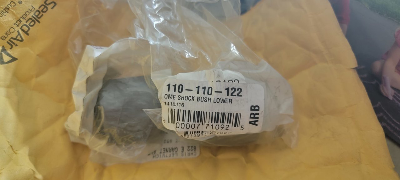

    I may have a set of replacement bushings. I'll look later.

    They're yours if you want em.

    That looks good, I assume the Bilstein and the OME are the same? The other issue I have, I don't mess with stored energy devices. Like, my garage door spring, or in this case the coil over assembly. Is it possible to change the bushing without compressing the spring? If I had a wall mount spring compressor, maybe. I put it in the same category of skiing, know your limit ski within it. This is one area I am at the limit of my understanding.

    Man I didn't realize that you were still rocking the stock shocks. I'm not sure if thoes bushings fit. We could measure and find out. But I'm guessing that your stock shocks are probably past there life expectancy.
    But to put in new bushings you would pull the whole "strut" shock and spring out as a unit. While it would be heavy it would then be possible to press out the bushings.

    Replaced the originals at 190k, but yes, these are the 4600's (part number 22-022842) and pretty much at end of life - assuming a life of 50k miles under normal driving - highway, forest service roads, pulled an 8' tent trailer all over AZ, UT, CO
    Did a bit of searching in the 2003 FSM listed in the 1st Gen thread, I'll probably just schedule the appt to get the shocks replaced, do the 4600's again since it's stock height and weight.
