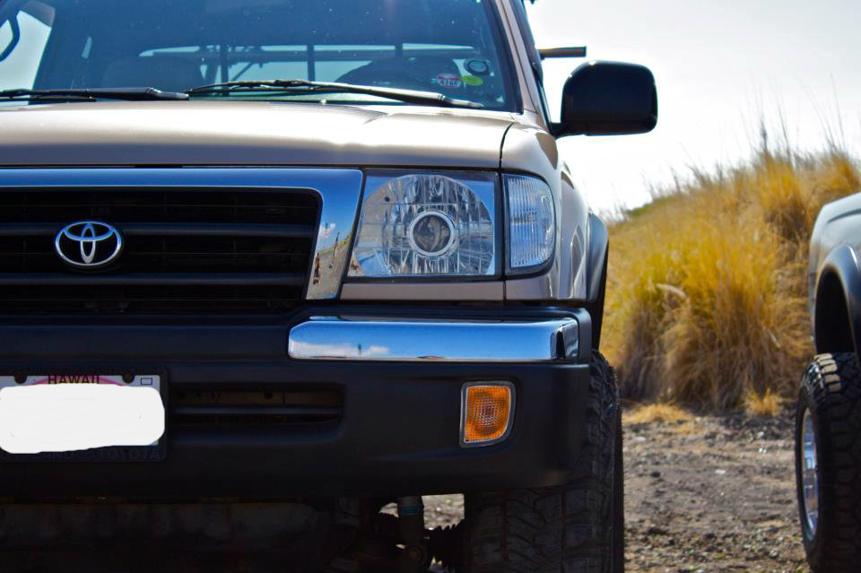

    morimoto mini h1 projector with 6000k HIDs
    it's a billion and a half percent improvement over my 8000ks in the reflector housings

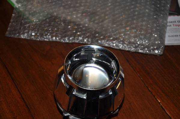

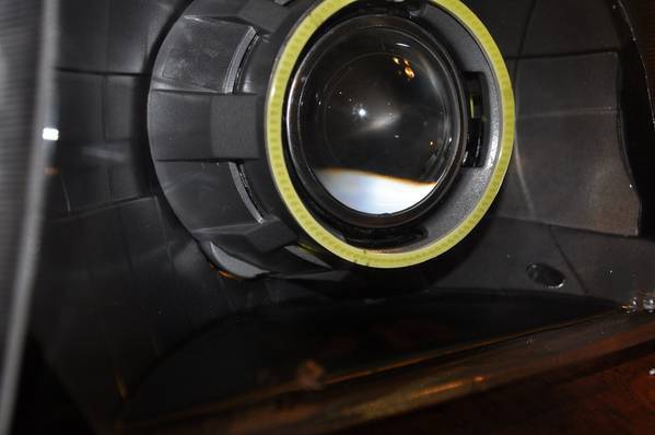

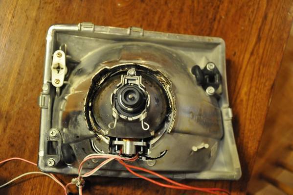

    I'm not sure what you mean by regular, like projectors already installed in headlight housings? The benifit of a retrofit over premade ones is the quality of projectors from TRS.
    With a retrofit, you only get the guts of the headlight, the projector itself and the wiring, and you install it in your stock headlight housing.
    Heres some pics.
    This is the projector and shroud upside down. (The shroud is a piece of plastic that covers the projector to make it look pretty)
    Here's from the top.
    Now I'm not sure about the other types of projector (mini's) but with FXR's you have to cut a larger hole in the back of your stock housing and glue the projector in.
    Also this is a halo. The yellow ring just lights up white as a cool looking running light.
