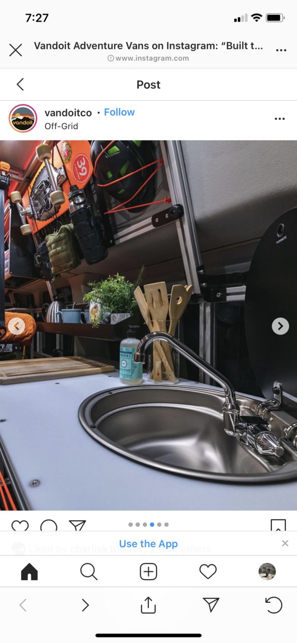

    Any updates on this? Saw a van build that had a possible idea for reinforcement the roof to the bedsides. Doesn’t look like it would angle in too much.
    D889E987-AEEC-473B-842E-AFF884FBD067.jpg 9B6868B2-234B-4D25-BC4D-602C14AAC8C3.jpg

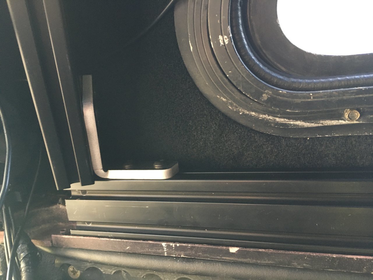

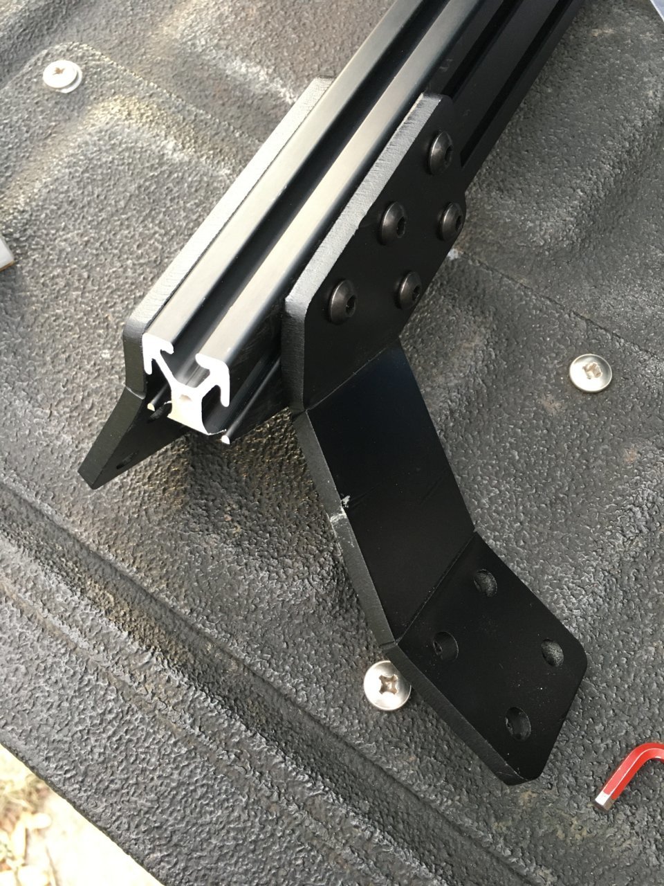

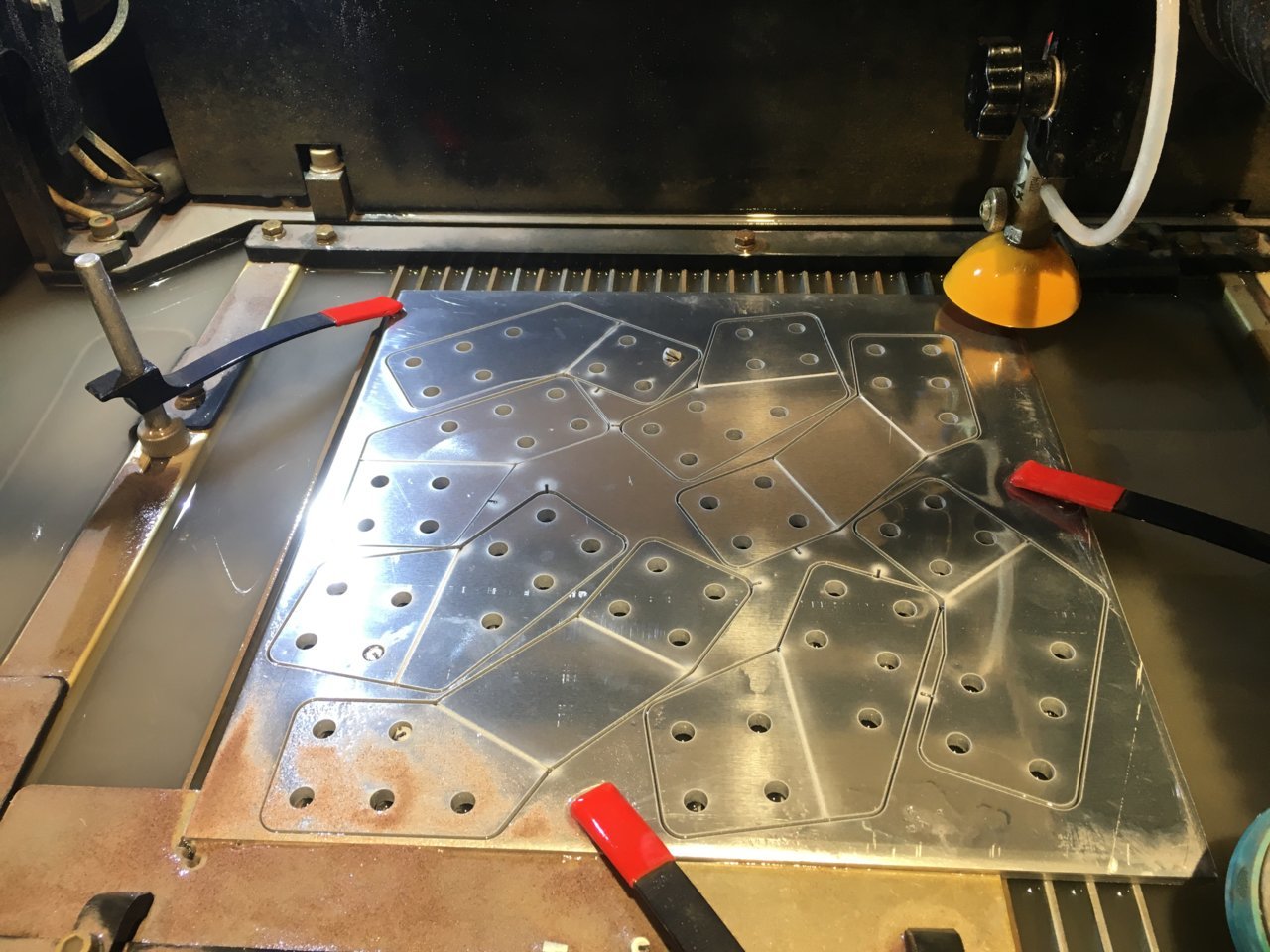

    Made some progress by water jetting some scrap 1/8” aluminum brackets. They seem to line up perfectly. The final ones will be 3/16 or 1/4”. I’ll have to make a variation for the front ones though.

    Cut out all the brackets on the Waterjet using 1/4” 5052 aluminum.

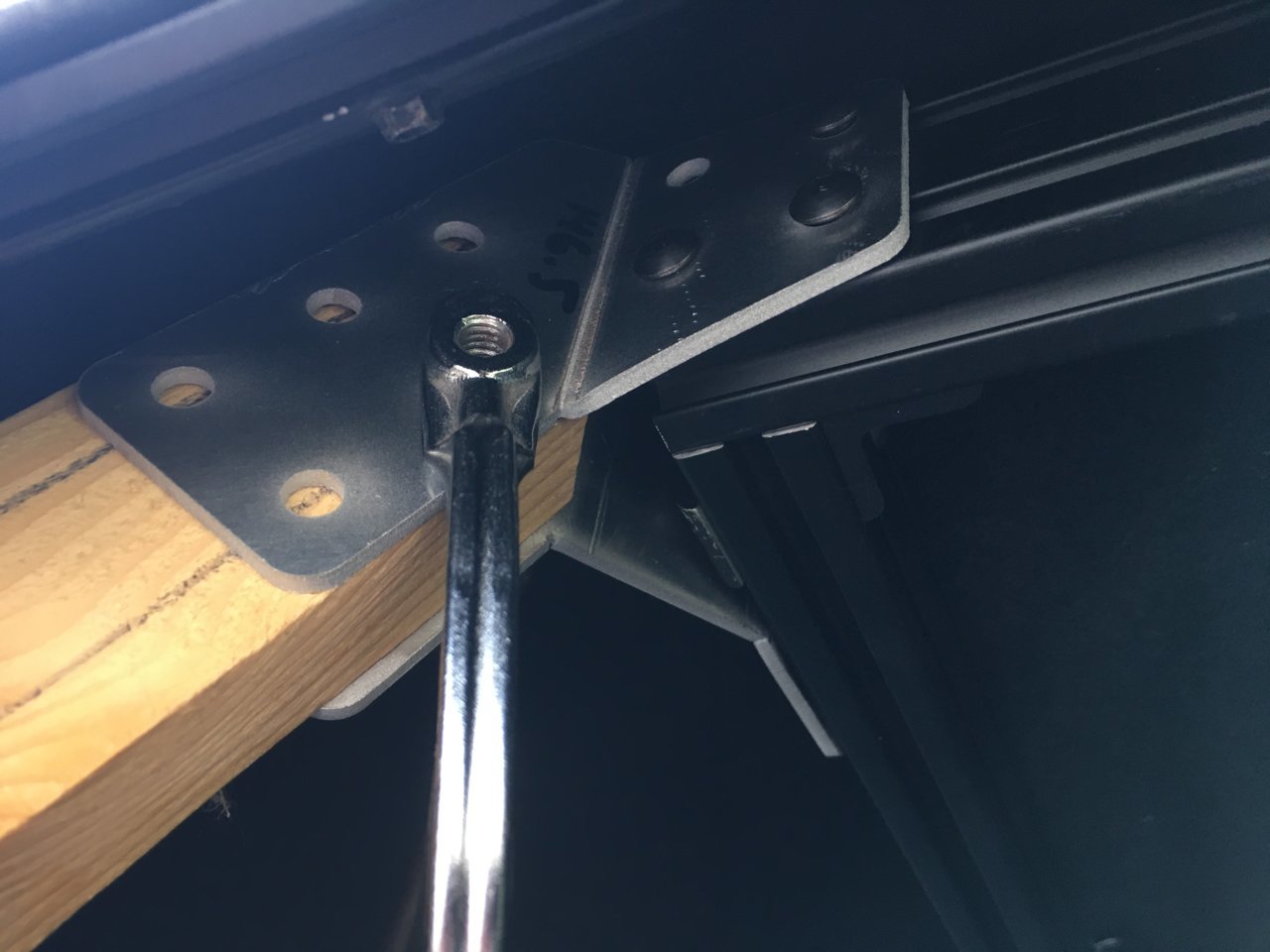

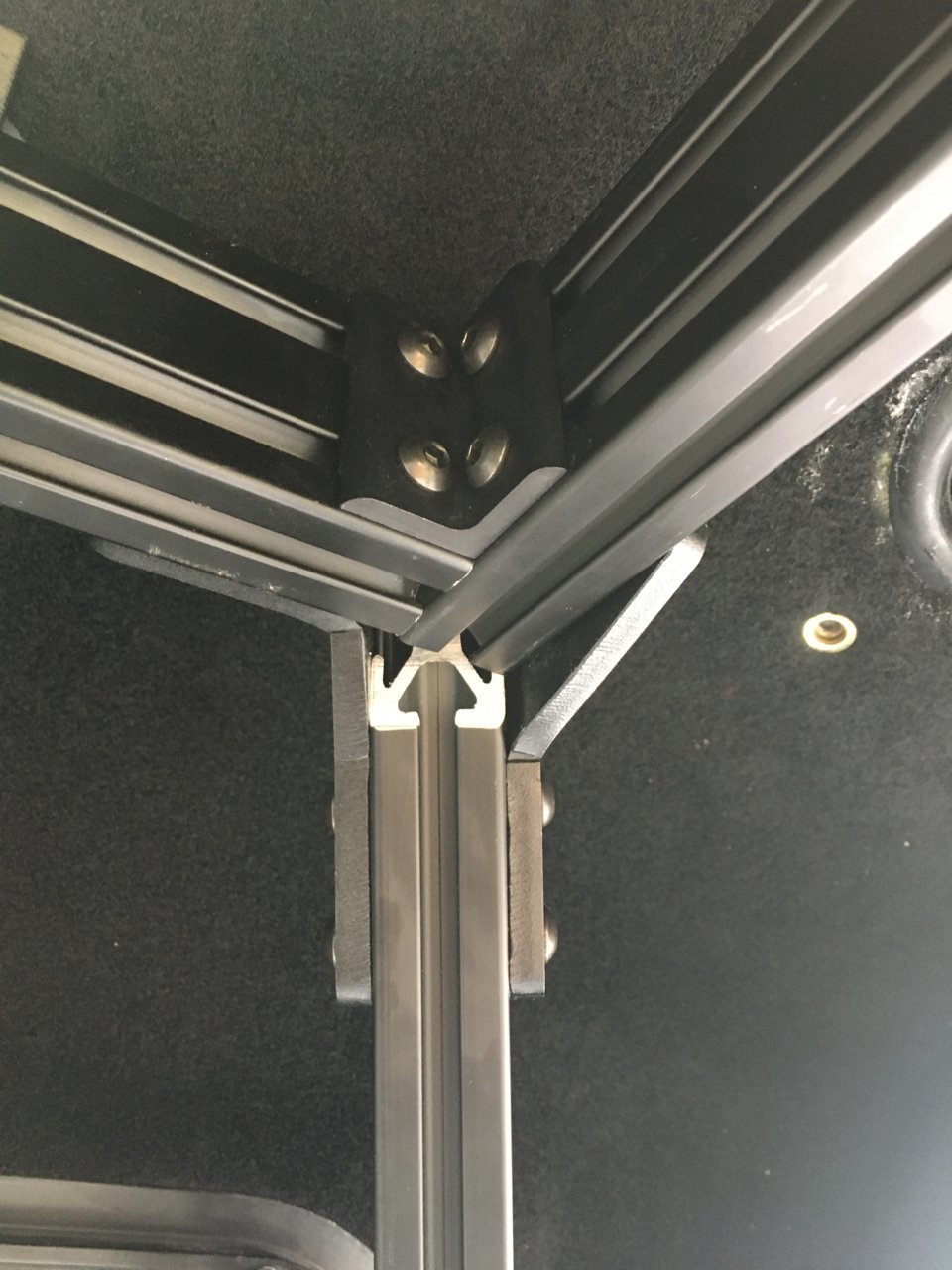

    Here’s the upper corner brackets after bending and painting.

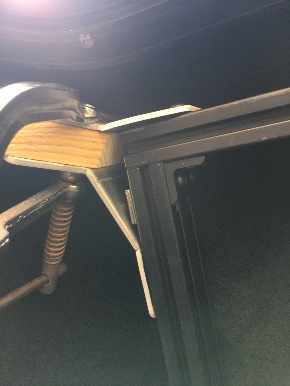

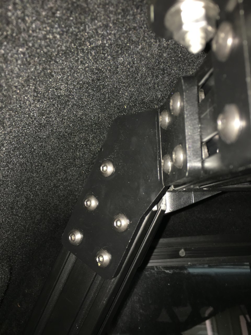

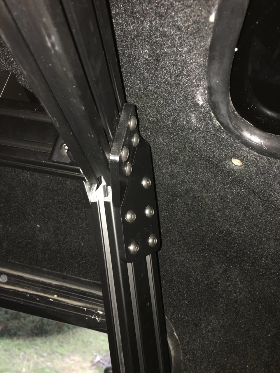

    Got the 2 front uprights in place. It looks like lots of measuring and modeling paid off. The brackets fit perfectly.
    4499A9CE-EFD9-47F9-BCE2-D356E806BFB4.jpg 148CFBC3-91BA-429D-8647-4D09F0501A8A.jpg 3B549519-AB4A-42B6-ABAE-060FE96B588F.jpg
    I need to notch the rear ones to clear the bolts that go through the roof. I didn’t account for those when I did the model.

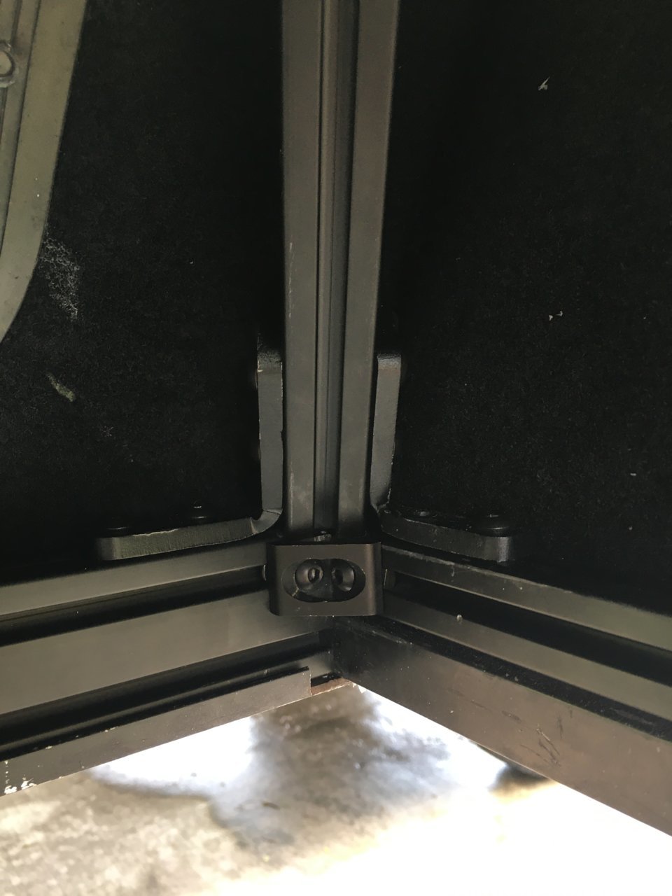

    Got the last 2 uprights in place. I still need to design and make the brackets that connect it to the bottom aluminum rails on the topper.

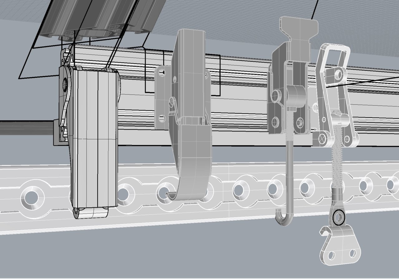

    I've been doing some mock ups of using draw latches instead of camper clamps.
    I have tentatively decided on the style on the right since they are the cheapest and the holes line up with 10 series aluminum extrusions.

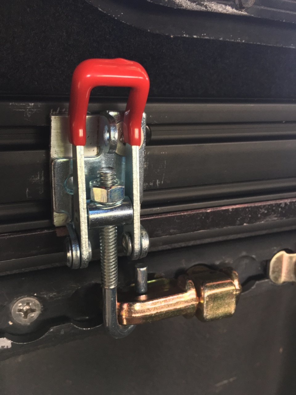

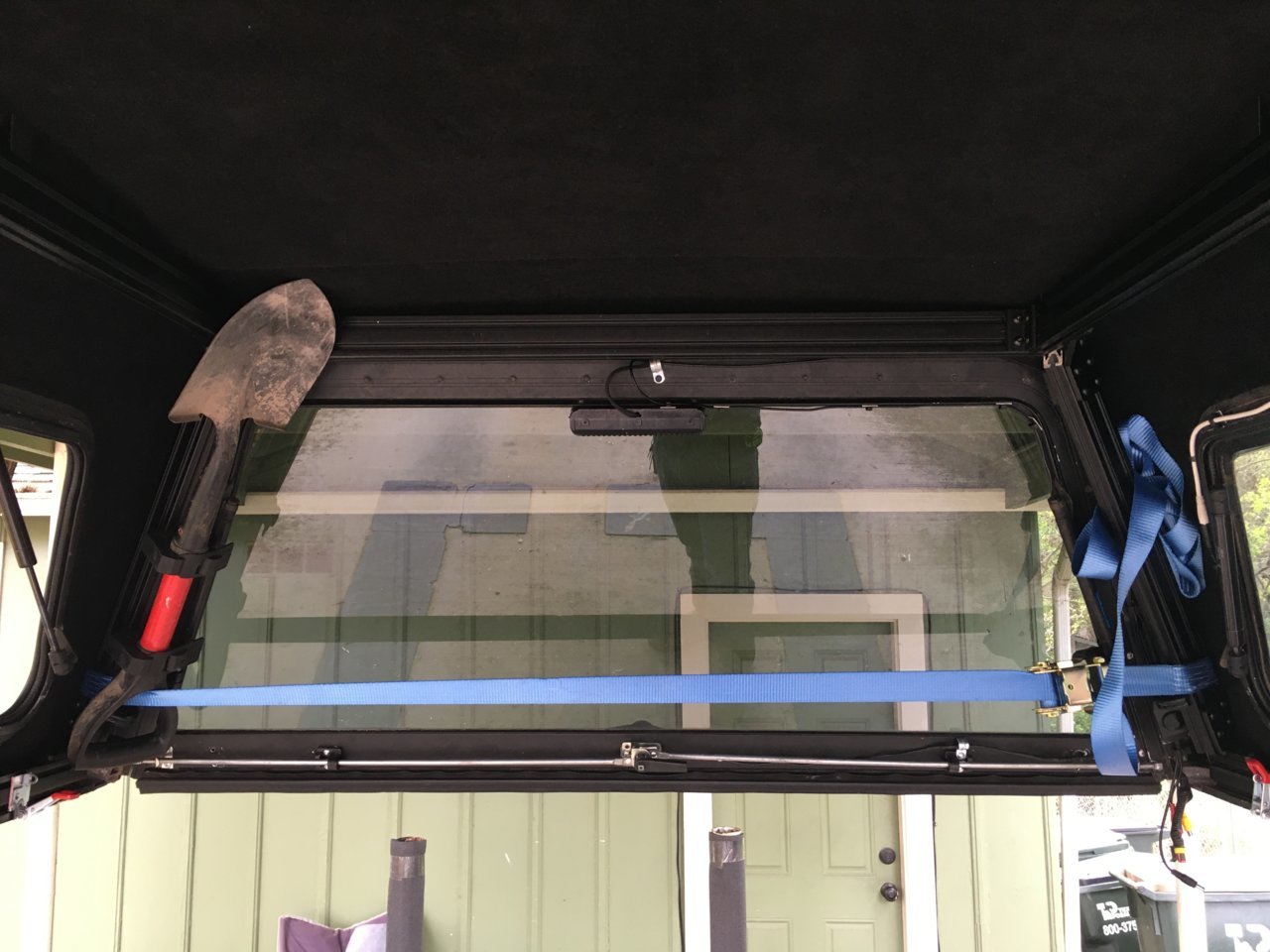

    Spent most of the weekend pulling the topper and installing the bottom rails and front rail. I put a 1020 extrusion on each side by drilling and countersinking 10 holes in the bottom aluminum rail in the topper. The front rail has a 1”x1” square tube running across it, so I had to drill access holes through this. Then I used self tapping screws to go into a 1010 extrusion that has a smooth side.
    I also used some draw latches I got on Amazon to connect down to the ltrack fittings on my bed rails. I’ll be doing a total of 8 of these all the way around. I had to make a little spacer since the 1020 rails sit inside of an 1/8” thick lip on the topper.

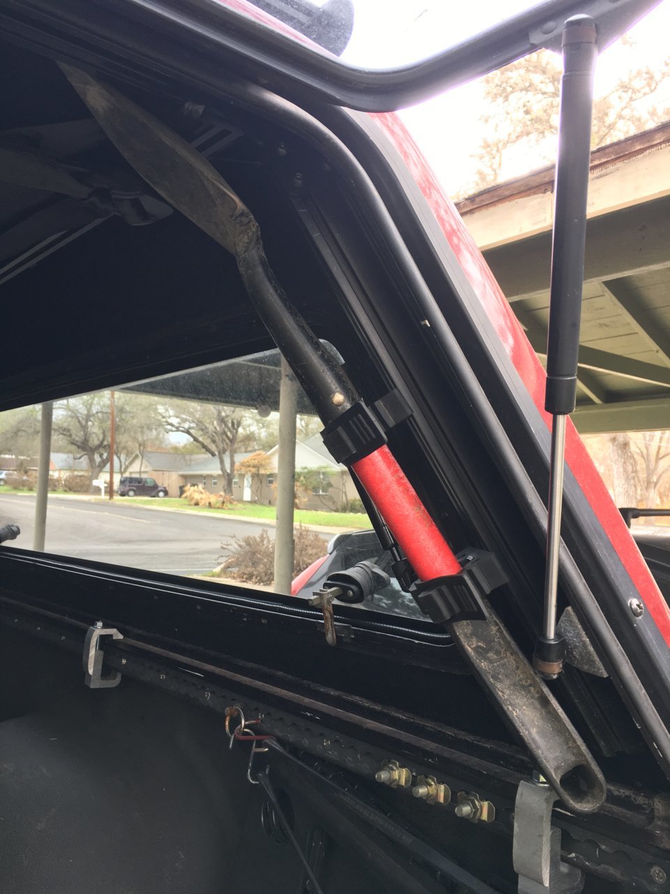

    I ended up ditching the toggle latch idea for now since they seemed to keep coming loose. I designed and fabricated some brackets to work with my old topper clamp bottoms for now.
    I also mounted some fold down steps to the outside corners of the topper.
    https://smile.amazon.com/gp/product/B0000AX4HS/ref=ppx_yo_dt_b_asin_title_o02_s00?ie=UTF8
    This should make it much easier to climb up top now. I was actually able to line the lower bolt up with a tnut in the aluminum extrusion inside. I just used a massive fender washer on the top for now. It holds my body weight just fine, but I may tie it into the frame later.
