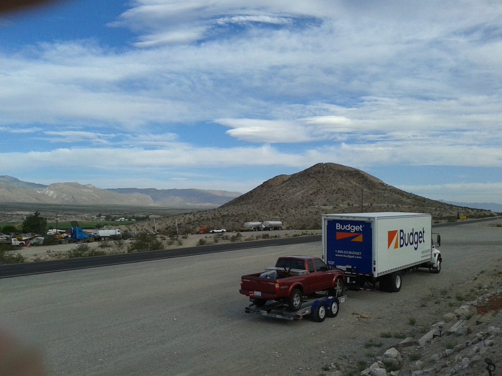

    A month ago I one-way rented a 22ft diesel box truck from Penske plus a car carrier trailer for my 1962 Triumph TR3 to start my 1000 mile move from Saint Louis to Santa Fe.
    Penske was great to deal with. The total rental cost for truck and trailer was somewhere around $1600-1800. (I’d need to double check). And with diesel it was easier on fuel than UHaul’s gasoline trucks.
    Be sure you check estimated costs on the Penske website before you start hauling with your Tacoma.
