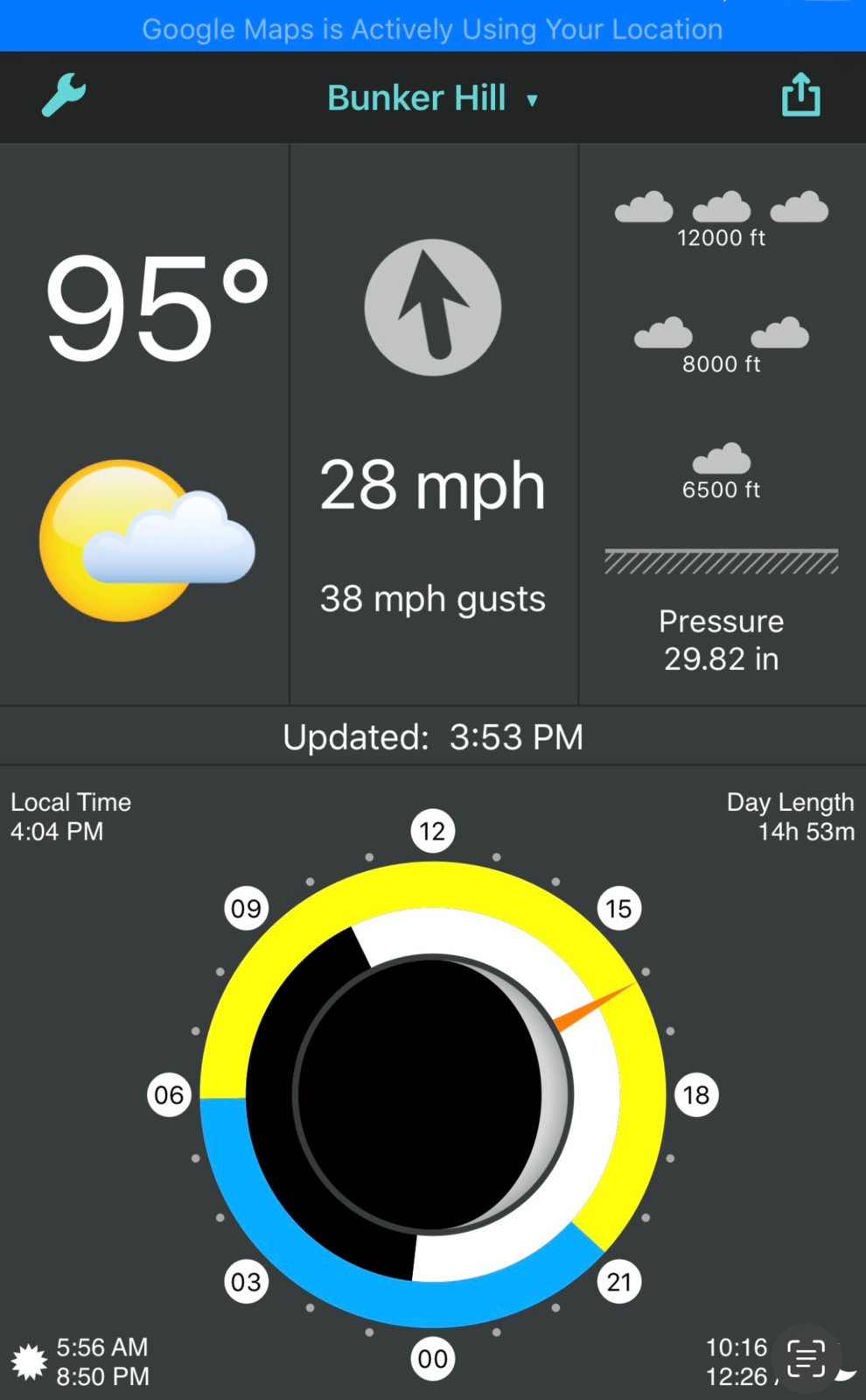

    I towed an empty 14’ x 7’ high enclosed trailer from GA to the mountains in Colorado (8,800’)with basically the same truck. The temp was 95 degrees & at times, I was driving into a 28mph headwind! I especially remember 2 things: I couldn’t do over 45-50mph at times, and I got as low as 8mpg on that entire tank of gas! You could do it, but take it SLOW, and don’t let the trans keep downshifting every 2 min. Turn off the overdrive & don’t rev past 4k rpm. Let em pass ya!

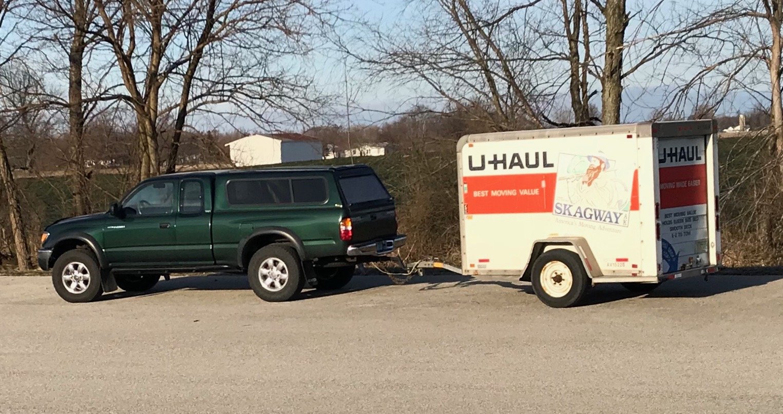

    I have hauled this size (pictured) of enclosed U-Haul a LOT, and the larger, 6x12' tandem-axle many times as well. In fact, I pulled the 6x12 with about 2,000# in it, with the entire back of the truck loaded as well from Philadelphia to Lansing, MI. Didn't even get over 55mph on that trip!

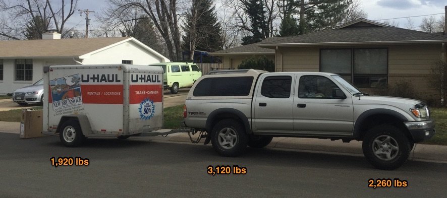

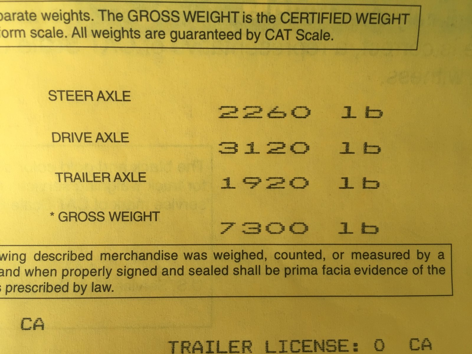

    I know OP has probably decided not to do it, but I'll chime in as well... 2003 TRD OffRoad DCSB automatic V6. No brake controller. I rented a 5x10 single axle and drove I-80 across CA,NV,UT,WY,CO. It was hell. The truck struggled to keep speed on inclines, but I kept a close eye on the scangauge for transmission temps and "manually shifted" the auto frequently to keep in the power band and lock the torque converter as much as I could by managing the accelerator position. It was a TON of mental and physical energy to do the drive. The truck really struggles to produce power at higher elevations.
    According to detailed gas receipts: 12.97 mpg
    Also of note for OP and others coming to the thread...in CA and other states, a trailer above 1500lb requires you to have a brake controller to work the trailer brakes - not just rely on the surge brakes in case of detachment/accident.
    In the end, after moving to Colorado and my base elevation now being ~5500' and the truck struggling to make power with the combo of 5VZ and automatic trans, I sold the truck rather than dump a ton of money to supercharge and upgrade other stuff.

    Very nice detailed post. I'm actually impressed you managed almost 13mpg in that truck under those circumstances
