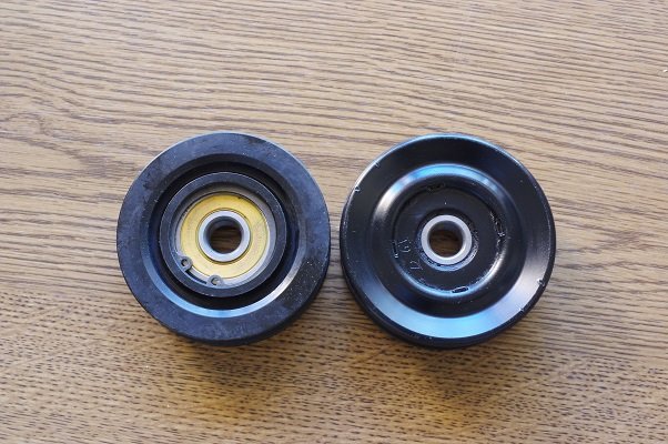

    Don't think I saw these listed.
    Idler pulley bearing: 6301-2NSE
    Saves a couple bucks as opposed to getting an new pulley.

    Or 6301-DU.

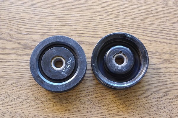

    On my 3RZ only the AC idler uses this bearing, since it has the cast pulley with the clip. The PS idler has a stamped pulley with the staked bearing. They both use the same bearing, but the PS is technically not replaceable (though … ).

    I have two idlers on my 3rz. Ac tension and power steering tension. Both the same.

    Interesting. Not on mine. I also saw this same pair on a 1997 T100 3RZ. I know because I harvested the AC idler from the T100 in the hopes that it could sub for the crimped PS pulley. In fact, thanks for reminding me to install the two and check belt spacing.
    Left: Pulley showing the cast AC idler with the clipped bearing.
    Right: Pulley showing the stamped PS idler with the staked bearing.
    Backside.
    Left: AC pulley
    Right: PS pulley.
