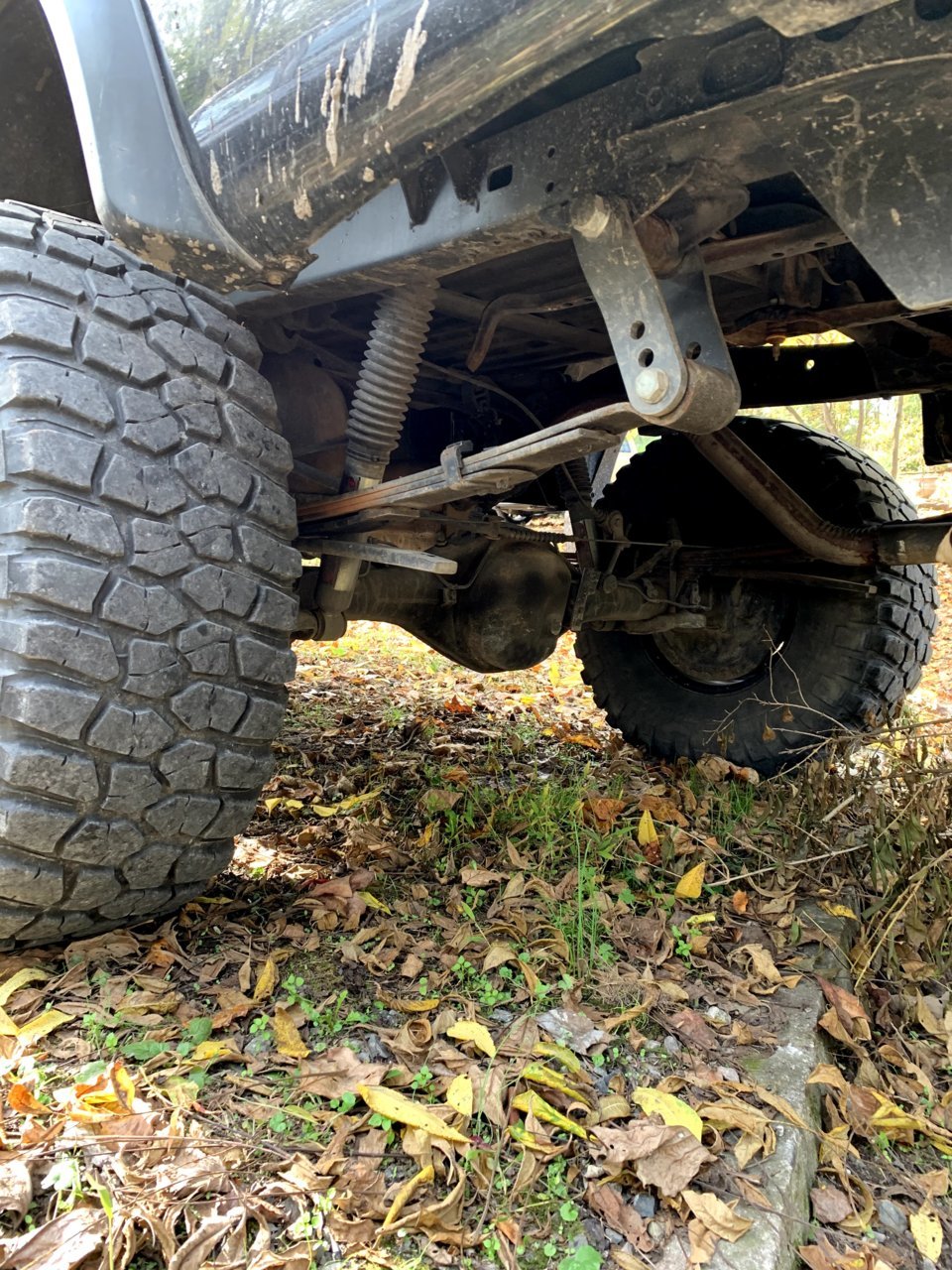

    IMG_5326.HEIC.jpg this is before the shackles were installed, the rear end is definitely lower than the front when looking at the top of the fender to the tire

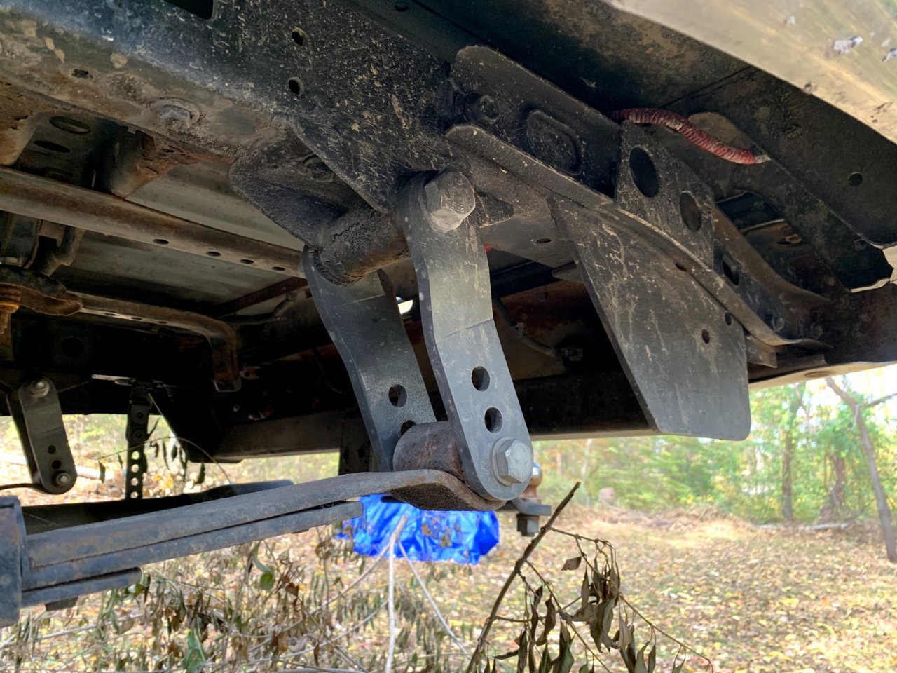

    IMG_7234.jpg Here is a pic of the shackles installed in the highest setting, still has a nice angle not over flexing the leaf springs
    IMG_7233.jpg Here is another pic (note that it is possible that by doing this mod you may have the shackle hit your exhaust if it is still stock. I had to reroute mine straight out the back. Yes I know it looks like hell but for not it'll work until it can be redone lol)
    this mod also help to correct U joint angle on the pinion gear, it will push the rear of the diff down and point the front up. So if you have a lift and are experiencing driveshaft vibrations this may help reduce vibration and angle on those joints (If the problem there still continues I also have a carrier bearing dropper kit that helps we well).
