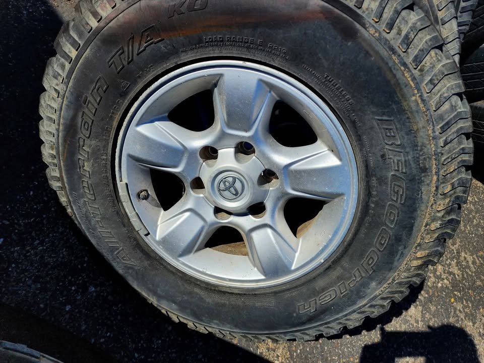

    Can someone say with any definity if 1st gen Tundra rims would fit the 1st gen Taco without fitment issues, not using spacers and running 265/75/16? I have been trying to find out on different sites but can't get a straight answer

    1st gen Tundra front suspension and hubs are basically identical to 1st gen Tacomas, other than being on a wider frame with longer CVs. Bore dimension is 106.1mm for both. The wheels will fit just like the stock Tacoma wheels. 265/75 (32”) tires may rub a bit on pinch weld, mud flaps, etc.

    @drr Thanks for chiming in. I don't see many 1st gen Tacos running 1st gen Tundra/Sequoia rims so i thought there had to be an issue. Even google said the bore size was different. I believe the offset is different though. I am not rubbing now with 3rd gen 4runner rims bit might with the Tundra rims?

    I haven't tried them myself, but from everything I know I'd expect those wheels to fit exactly the same as any factory Tacoma wheel. The bolt pattern is the same, the hub bore is the same, the only thing that might be different is offset, but I think Tundras used the same +15mm that 1st gen Tacomas did.
    Remember, 1st gen Tundras were available with the same "starfish" wheel that came on later 1st gen Tacomas.

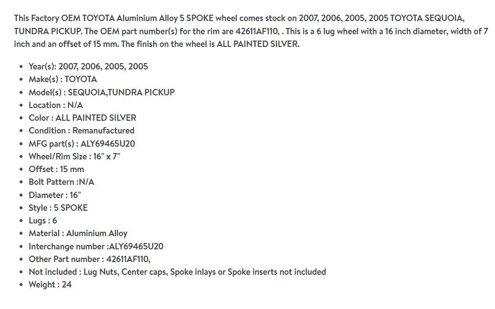

    Found this after some searching. Hard to find that info. Lol

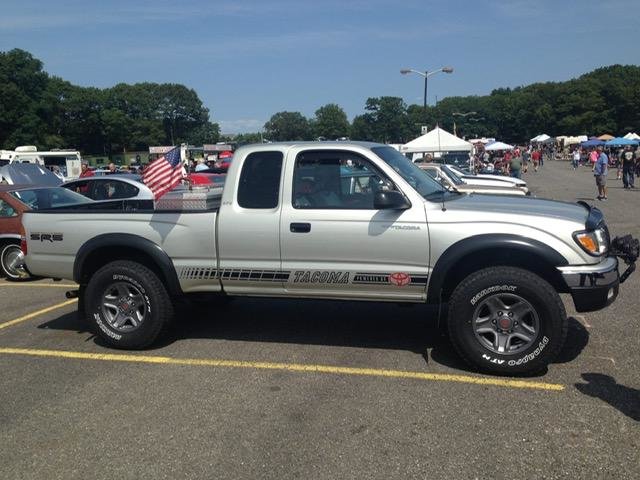

    24lbs sounds right, and not bad, but I was hoping they'd be lighter--the 4Runner 5-star rims (on the Tacoma in your first post) are 22lbs.

    Maybe they are a little heavier because they went on only the Tundras and Sequoias
