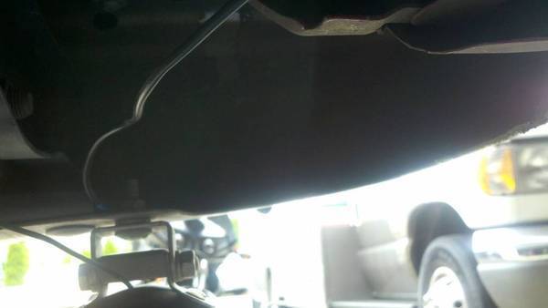

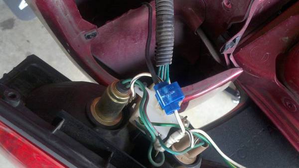

    Hey man, so i figured what the HELL! i would try the ground thing...First i unplugged the right rear housing socket. then i tested the white LEDs and they worked perfectly fine. So i plugged the housing socket back in then took turns testing the LEDs with different bulbs removed. It seemed the reverse light and the brake light affected the LED running lights.
    So i cut and fused a thick guaged wire into the ground coming from the "BRAKE" light bulb as seen here.
    and grounded it to an existing bolt on my rear bumper where i have reverse lights. IT works perfectly so far.

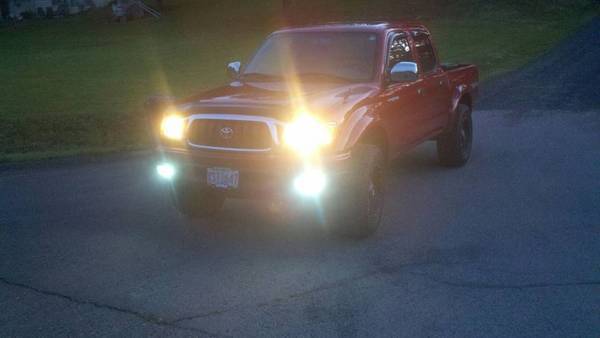

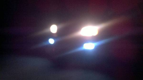

    I'm not sure if there are - but there's always a 15% discount running, all together with the 2 switchbacks, 2 resistors and the shipping i paid 70ish.
    Here are a couple more pics of last night with them complete. ;)
