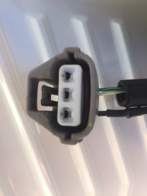

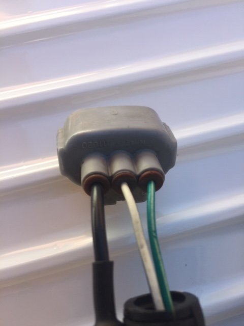

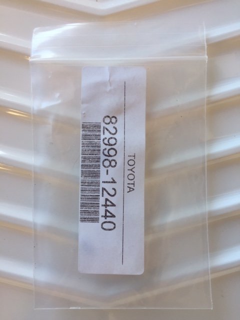

    Update 1/29/2018
    The wire bent to form a pin was a bit half-ass. Over the years, the connection to the white LEDs has become bad a few times. Sometimes because moisture gets in there and sometimes because the "spring" made from the bent wire isn't pushing as much as it used to. I then have to pull the wire out, cut it, restrip it, and reform. I finally got around to looking for a more permanent solution.
    There were two options I was exploring:
    1. Keep the stock socket, but use an OEM pin so the connection should be as good as the ground and turn signal connections (as long as you seal it up just as well). I searched a lot and came across two OEM pins that may work.
      82998-12170
      82998-12340 Both of those appear to come with a few inches of wire so you don't need a crimping tool. You would just attach your 12V source for the white LEDs to the wire on those pins. I have not verified either work. If you can confirm either one works, please post and I'll make a note that it was confirmed. 01/2020: tacoma_ca ordered a replacement pin off Amazon. https://www.amazon.com/gp/product/B000MTKUMM "TOYOTA 82998-12440 Terminal, Repair W/W" and has confirmed it fits into our stock turn signal connectors.
    2. Replace the socket with a Toyota OEM socket that came with three wires. I went with this option. I looked on Ebay and eventually came across a listing "97-99 Toyota Front Turn Signal Wiring Connector Plug OEM". It looked to be the exact same connector on our Tacomas, but with all three positions filled and a few inches of wire on each position. I ordered them and they fit perfect. All I had to do was connect the turn signal, ground, and 12V for white LEDs to the three wires coming off the connector (I soldered and then used heat shrink tubing to cover). The Ebay page listed Toyota Avalon, Camry, and Corollas '97-'99 as using that connector.
    Here are the two sockets from Ebay. Different colors, but both fit great. You can see they have all three pins stuffed unlike our connectors that only have two pins stuffed.
    The same connectors. Checking they mate with the turn signal bulb holder on our trucks.

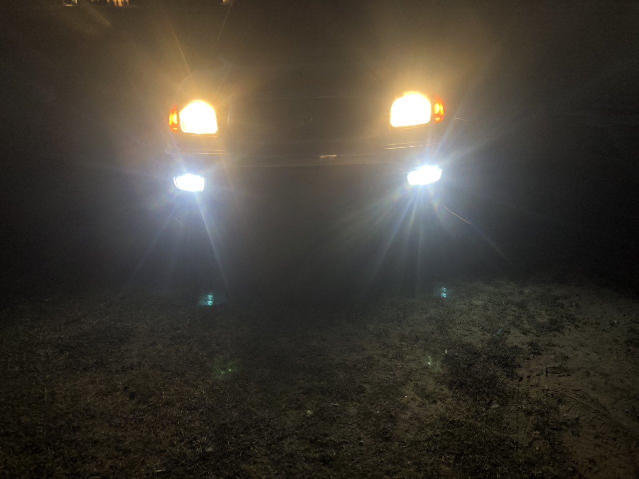

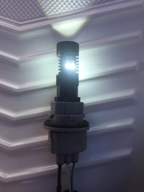

    Antline installed. Not as bright as the obsolete V-LEDs, but decent.
    Showing the amber turn signal

    Thanks for this post, it motivated me to convert all exteriors to LED and the Antline switchbacks you suggested in your recent update are a perfect choice for the front turn signals. This saved me a lot of time, THANKS.
    Above, you mentioned some unverified OEM pin product numbers to add to the stock pigtail that only has two pins and one vacancy. I found a cross-reference to part number 82998-12440 which is available on Amazon at <$9 each: https://www.amazon.com/gp/product/B000MTKUMM . I can confirm these pins at amazon are an exact match to the two pins already mounted in the '04 turn signal pigtail and worked perfectly for activating the white LEDs in the switchback. These pins have approx. 6" of black 16 AWG wire attached and include the weatherpack connector wire seals (the doughnut-shaped silicone water seal, similar to this: https://www.amazon.com/gp/product/B0030KDJAA but are the factory tan color. The included weatherpack seals fit as well as the other two already in the connector and I don't expect any problems at all with them over time. I like the approach of adding these pins instead of swapping in a different pigtail because I did not have to cut/modify any of the factory wiring. Thanks again for the suggestion.

    Thanks for confirming the pin you used is works on our turn signal sockets. I updated the original post and the update post adding your info about the pins.
