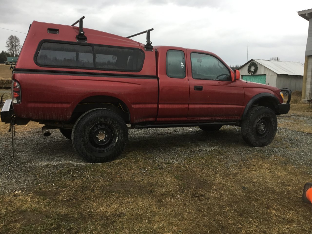

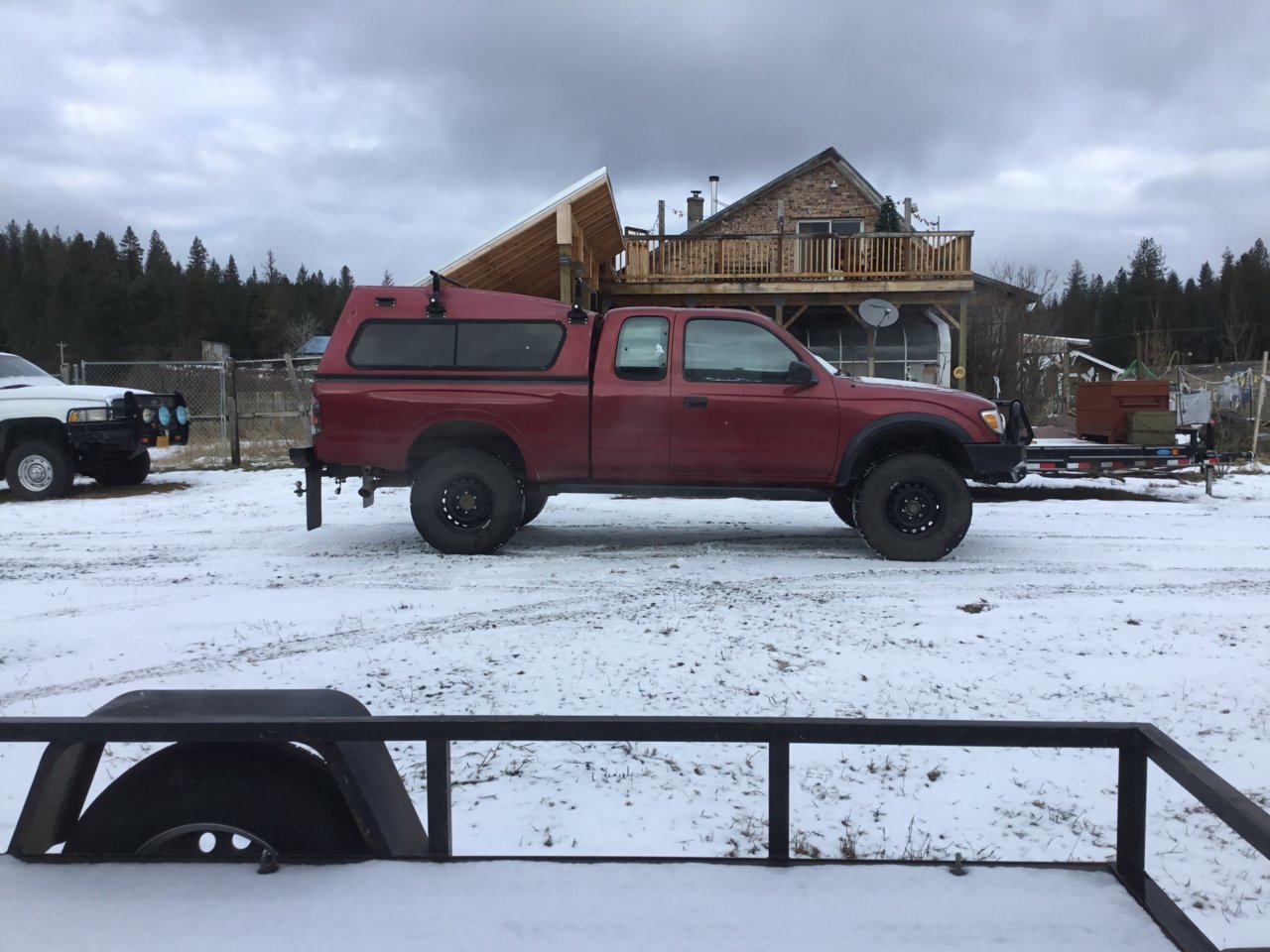

    Swapped out the Tundra wheels for set of OEM steelies(like the spare) and still running the 235/85R16 Toyo ATll. 37B3242F-975B-4892-9A57-E17A5D5CD1EF.jpg now a shot with the 2000- Radiant Red? Mirrors:3BF2C487-7445-4168-83D9-AB75F481CD31.jpg

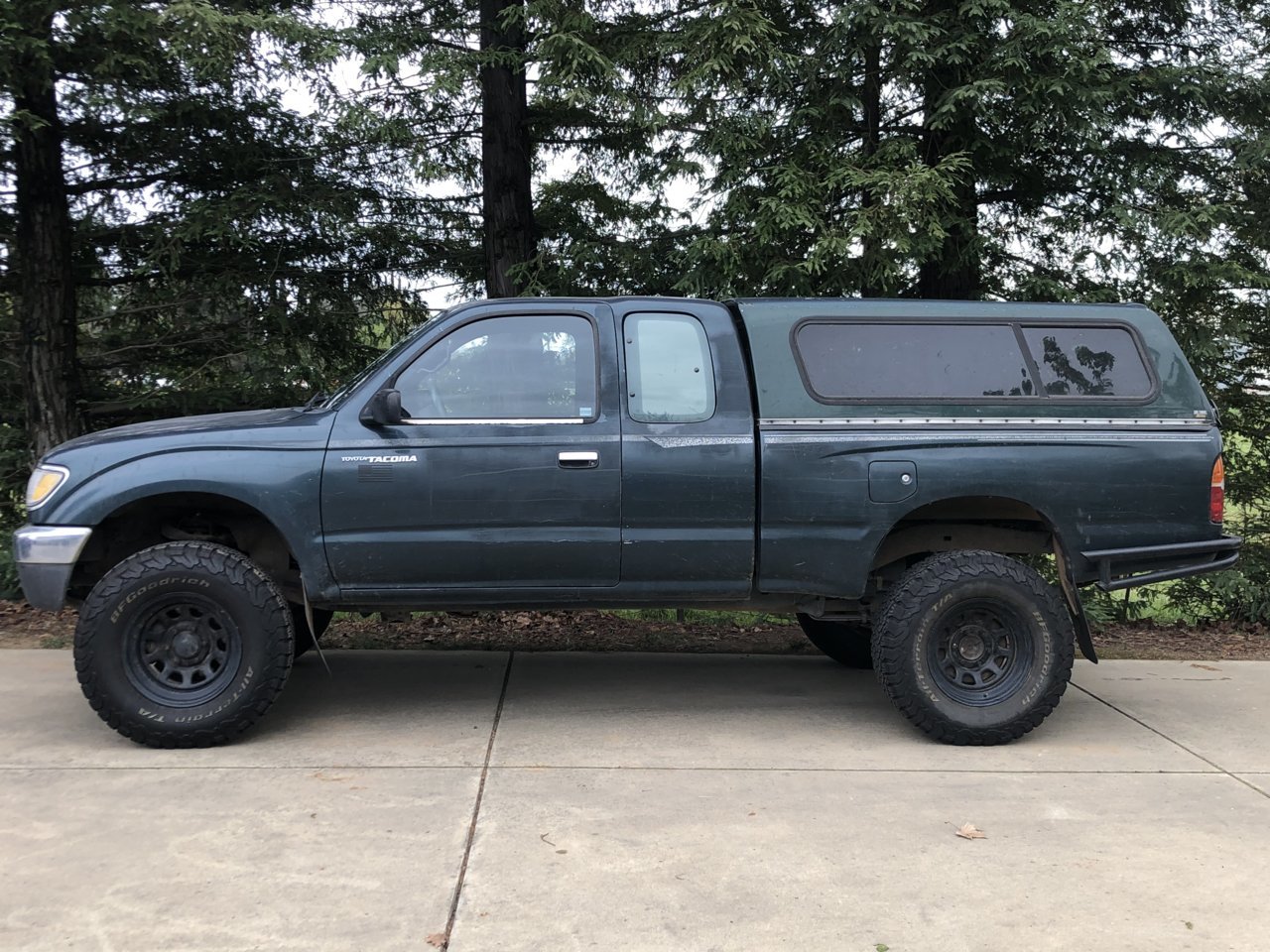

    1996 Tacoma 4x4
    5100 front with OME 881 and 5100 rears with toytec 3 Leaf AAL. Procomps 16x8 on 265-75-16 KO2

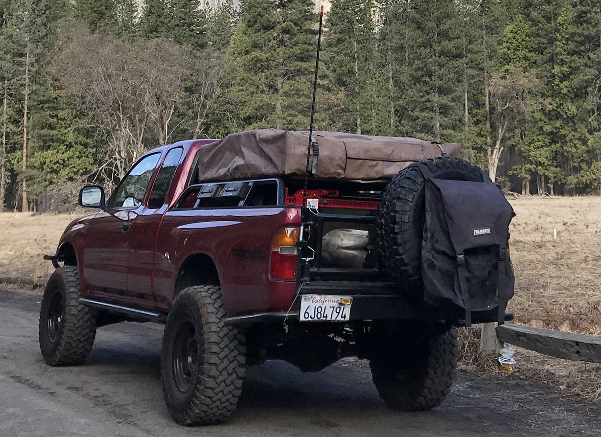

    2000 T4R Limited
    OME 882
    Dakar leaf pack with aal
    OME shackles
    Nitro chargers
    F5’s
    285/75/16 Wildpeak Mts
