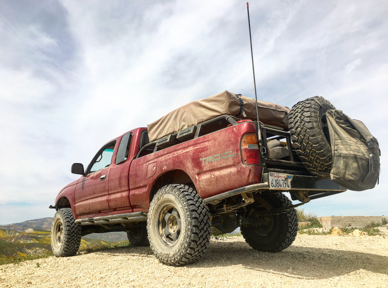

    Stealth 6's (16x8) with 3.5" backspacing and ST Maxx 255/85R16 tires. Note that I'm no longer running these because of the backspacing (threw up too much mud), but they looked great, and I miss them.

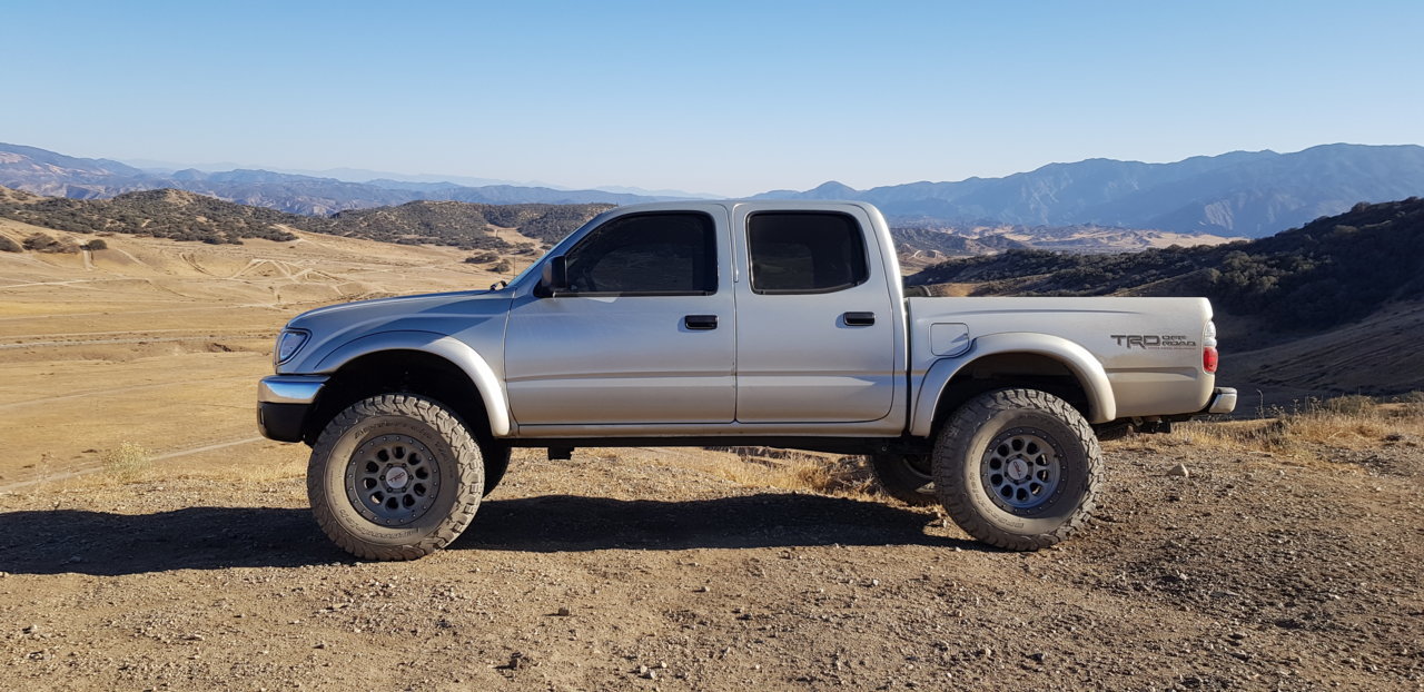

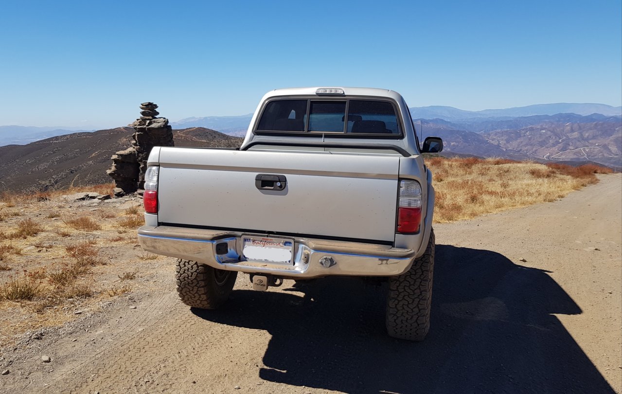

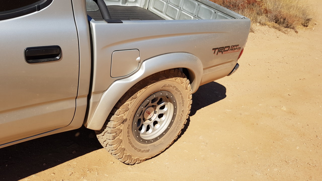

    SFV, CA
    01' DCab 3.4L TRD
    Donahoe CO, Donahoe Rear Resi, Deaver J59, 16" Pro Comp, 33" BFG AT, Hayden Trans Oil Cooler, Oil Filter Relocator, FM 40, ES Bushings, Beefed CB Drop, Deckplate, K&N Drop-In, DO Bed Bar, Cobra 75 WXST, Firestik Firefly, Philips D1R, Clarion Remote Start, Husky Liners

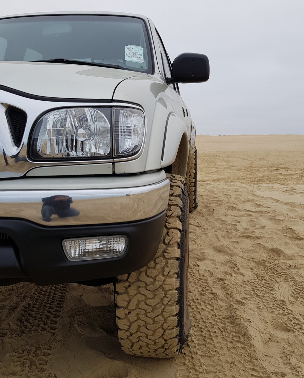

    Ray10, 16x8, 4.0 bs, 285/75-16, no spacers
    20181109_143833.jpg 20180823_152727.jpg 20180828_123231.jpg 20190608_180244.jpg 20181231_092832.jpg 20190608_181030.jpg

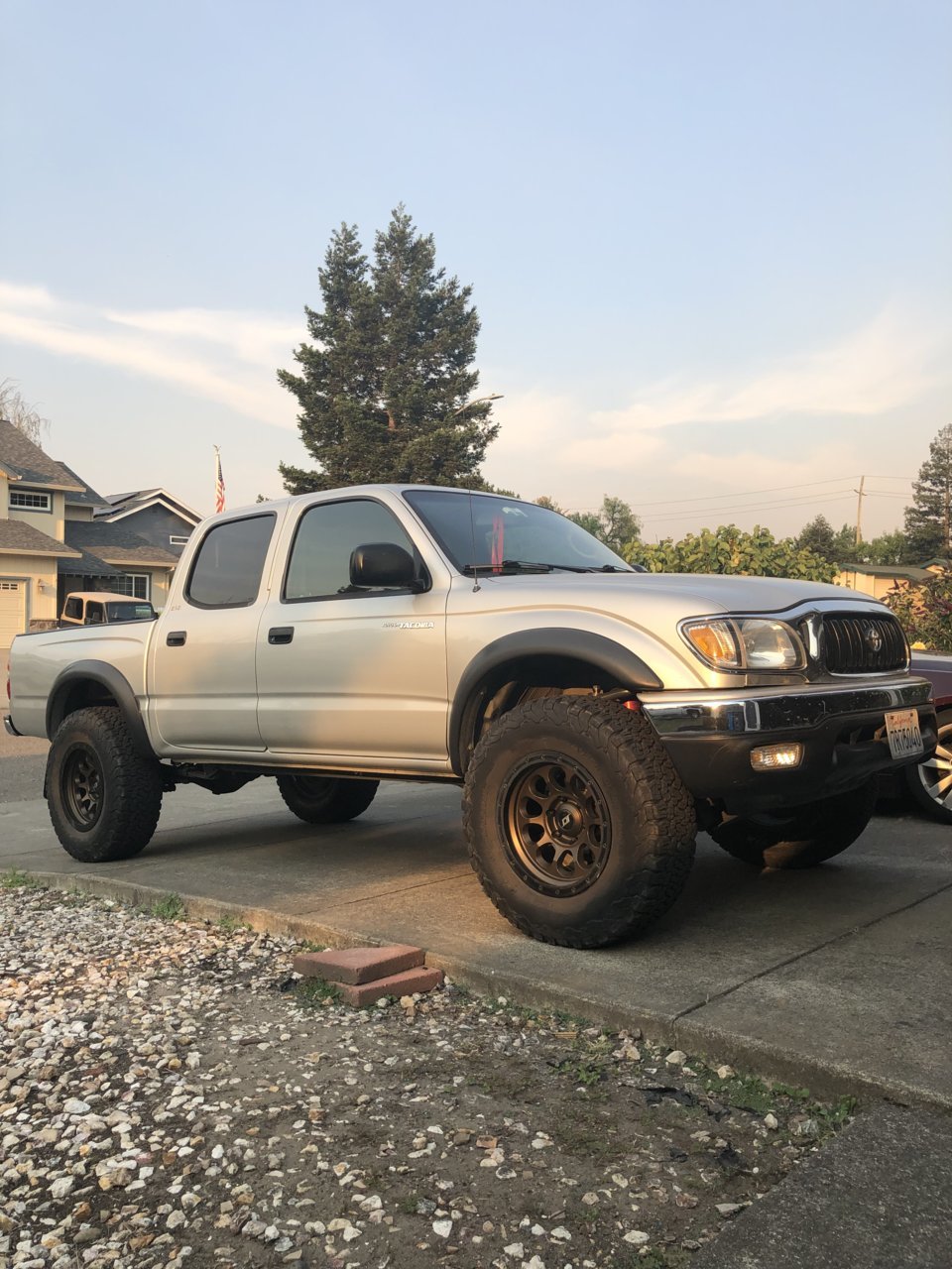

    Matte bronze Ray 10: 17x8.5 4.3” back spacing -10 offset 285/70/17 KO2s - no spacers

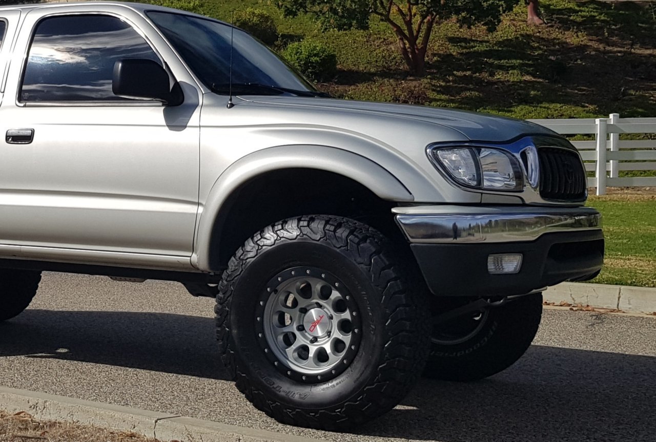

    Heres mine F5 3.5 backspace -25 offset
    Edit: 305/70R16

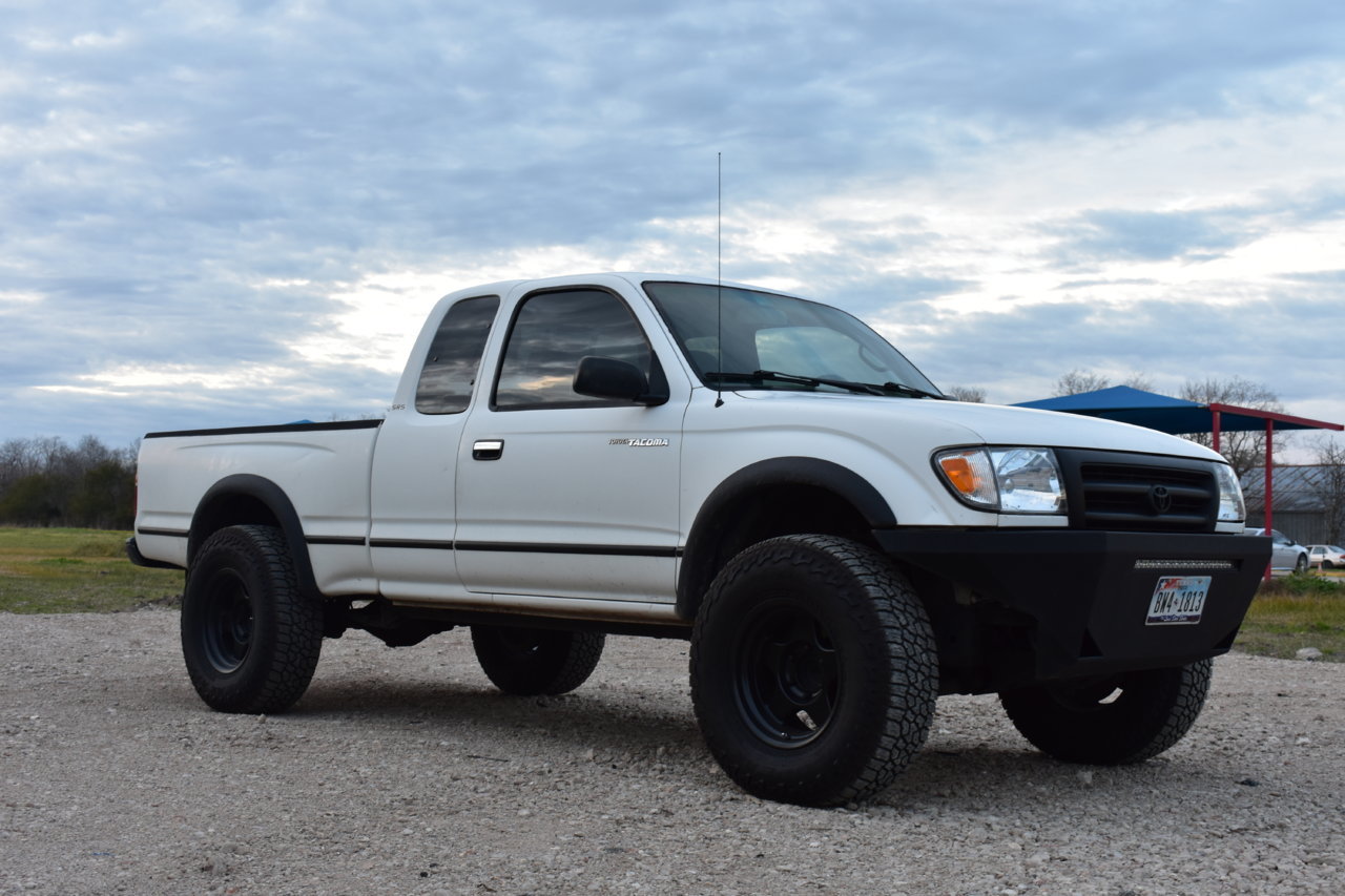

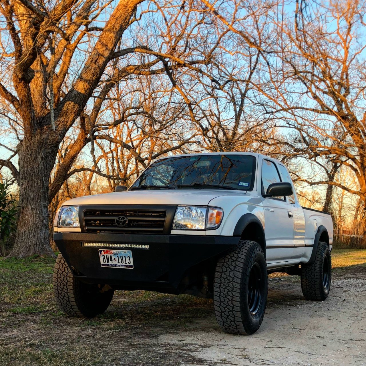

    2020 Cement TRD OR

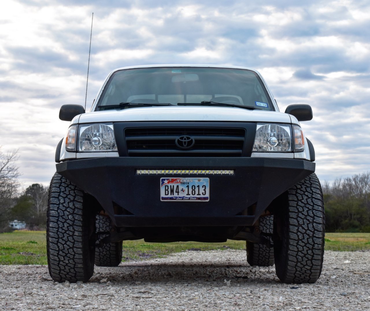

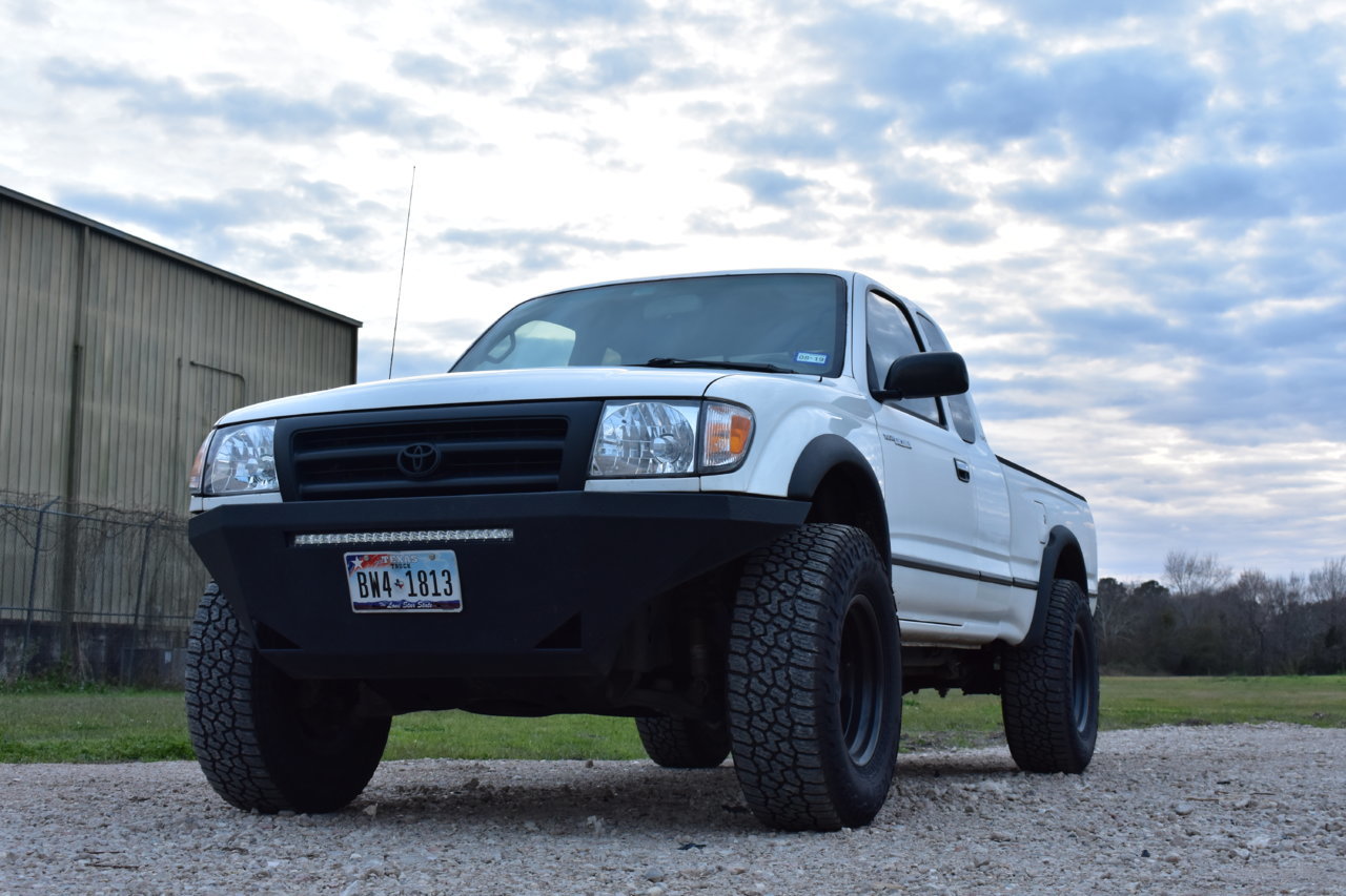

    Running the 16x8 F5's in Black, with the 3.5"BS/-25mm offset on some 265/75/16 Falken Wildpeak AT3W's. No spacers, on Bilstein 5100's at highest setting DSC_0105.jpg IMG_1952.jpg IMG_2509.jpg DSC_0110 (1).jpg
