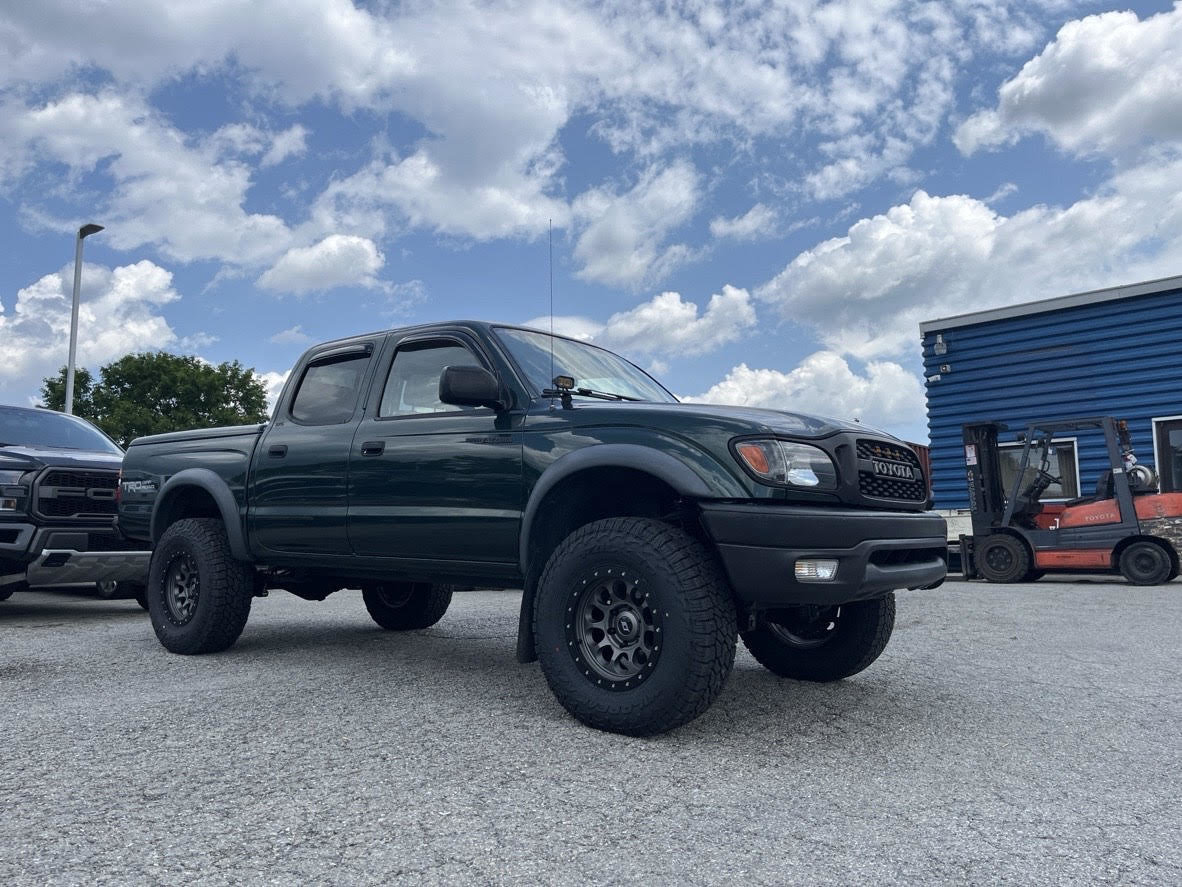

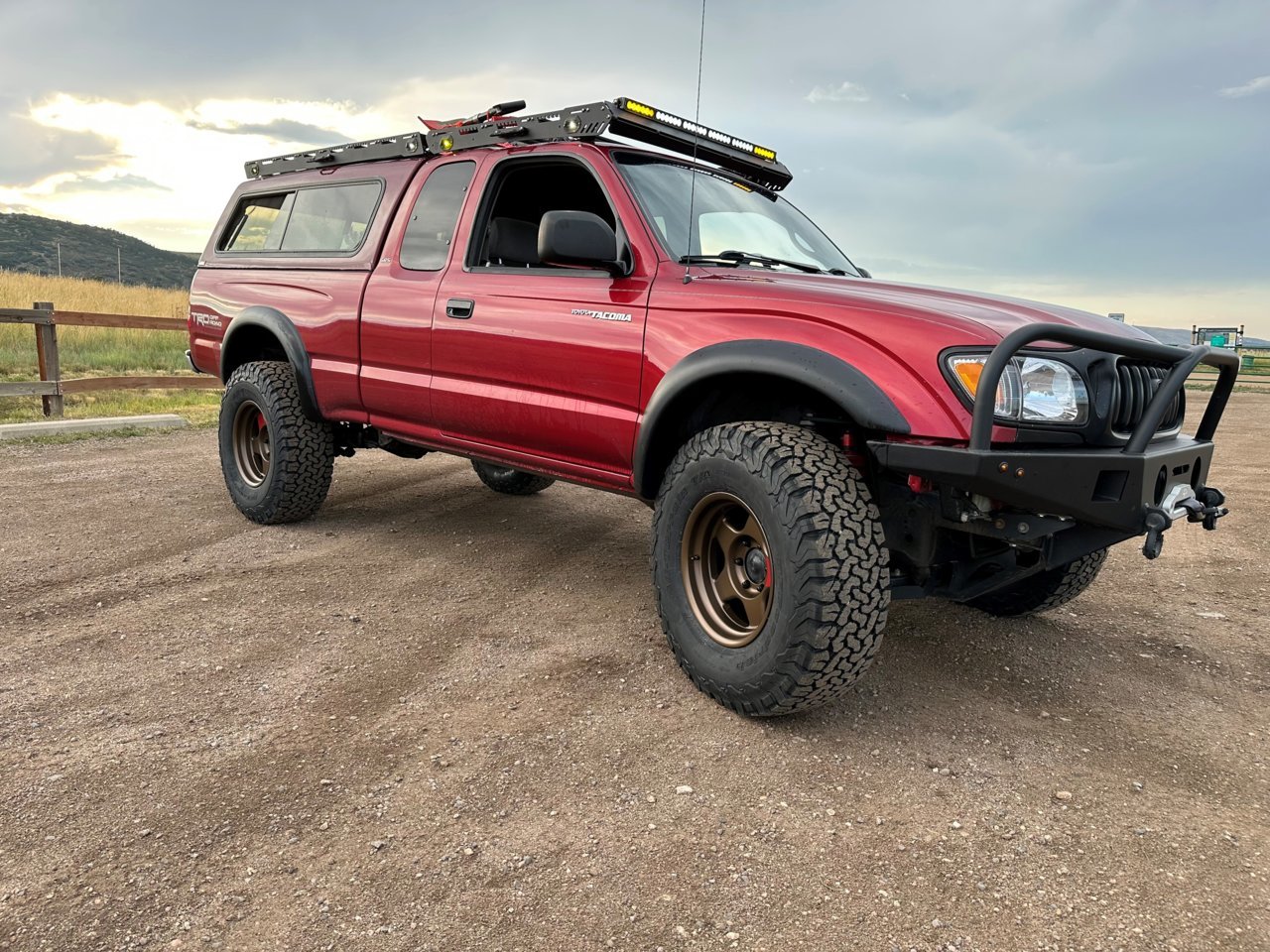

    20
    B

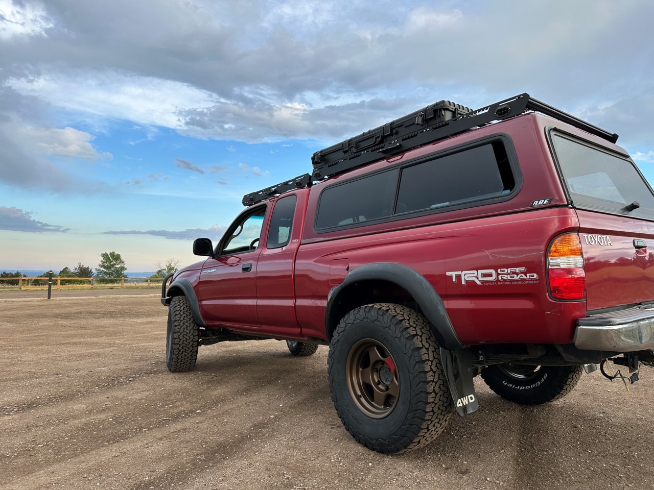

    Dark Bronze F5's
    285/75/16 KO2's
    -25mm offset
    No spacers
    I rub once in a blue moon but not much. I did the pinch weld mod and maxed out my coilovers in the front.

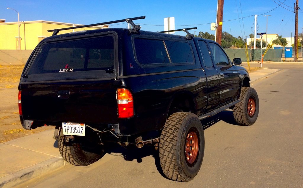

    It's less Tacoma and more mod
    Had em, sold em...
    F5 4.5bs with some 265/75/16 junk tires on em

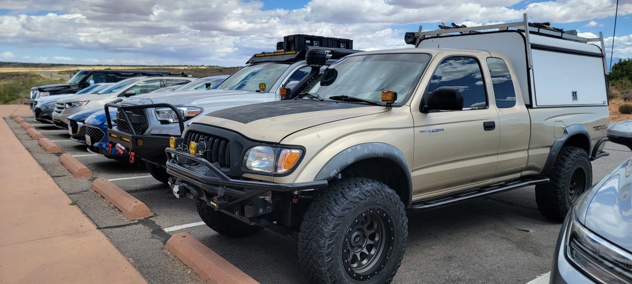

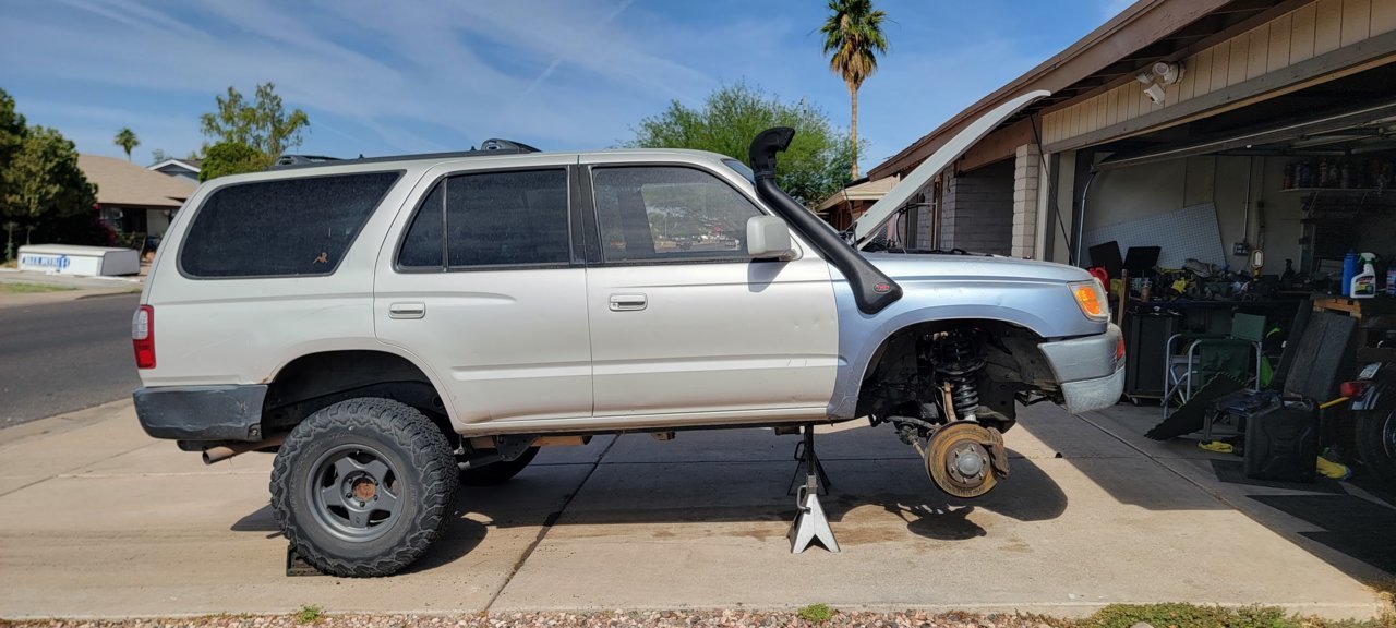

    @Speedytech7
    I still got em. There mostly on my 4runner
    Currently have ray 10's 17x9 whatever backspacing they offer I think it's-39 .
    285 70 17.

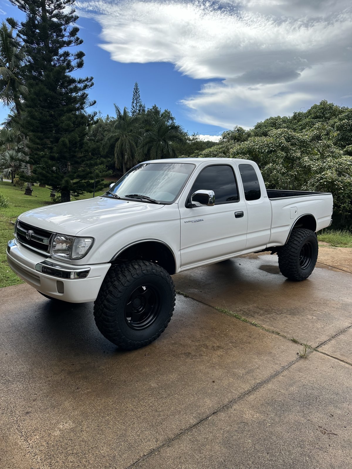

    F5 16x8
    -25 offset
    285 75r16
    No spacers
    No rubbing

    clean!! What lift are you running?

    It’s the bilstein lift with the toytec coils from toyteclifts.com

    what about the rear?

    Add a leaf and bilstein shocks. Rides really smooth

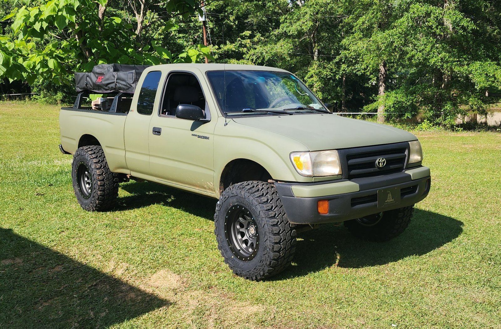

    Finally joined the club.
    SCS Ray10 16x8 Gunmetal 4.00" BS -12 Offset no spacers wrapped in Falken Wildpeak AT4W LT265/75R16
    Bilstein 6112 in the front, 5160 in the rear with Icon 1.5" AAL.
    Now it's time for some dirt :taco:

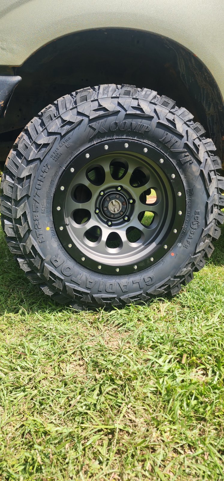

    Those look awesome!! I really would like to have those but scs website states they don't fit manual hubs. But clearly you have manual hubs like I do. Did you have any problems with the fit? I was go with the F5 but the Ray10 is my top choice. Thanks!

    You have to drill out the flange that holds the plastic hub cap with a hole saw or machine them down.

    I did not have any problems. I was worried about getting them too, but I just bit the bullet and bought them to see if they would fit and they did

    No I didn't. I was worried if I was going to have to

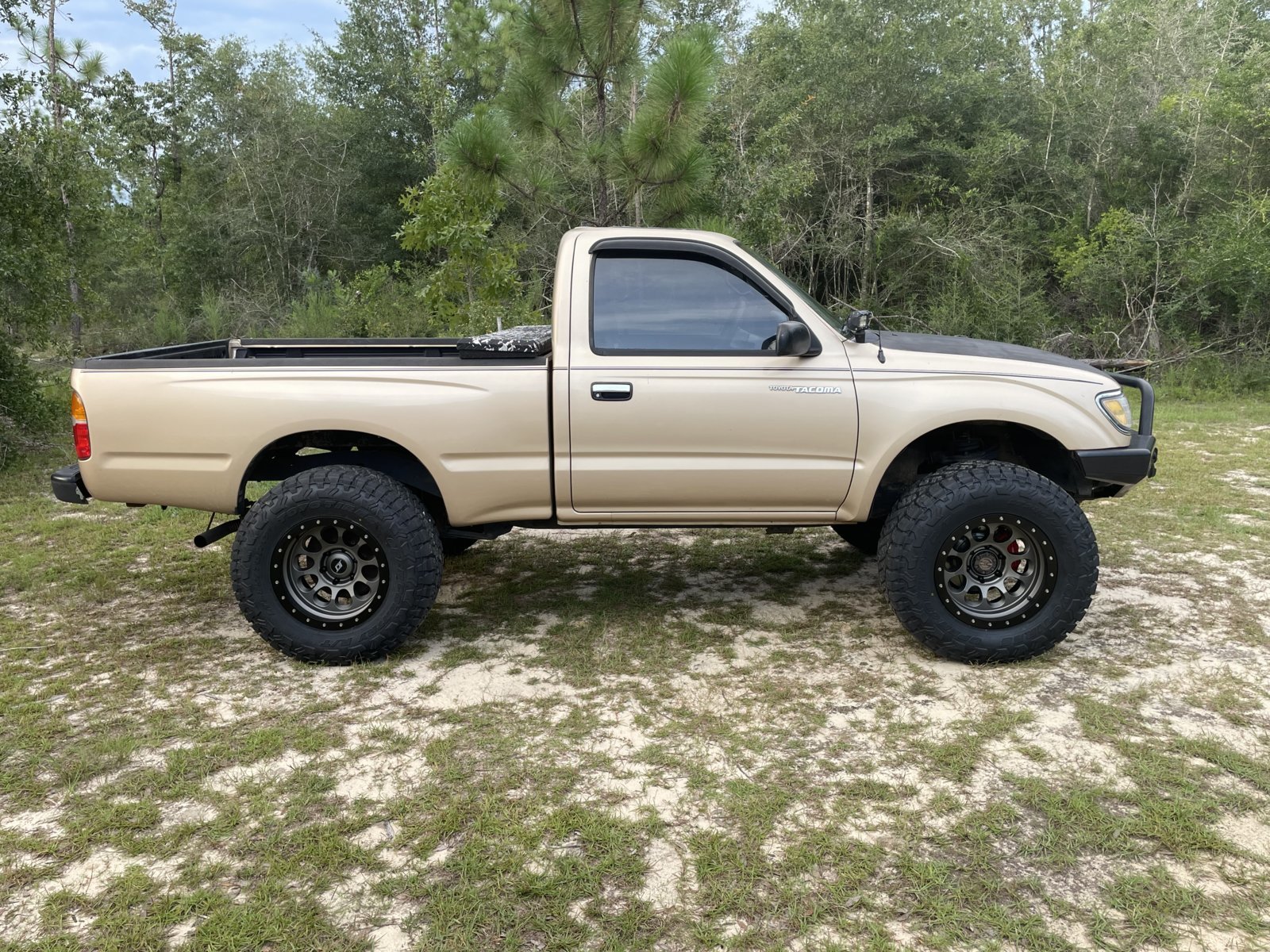

    I got mine in and installed today. No problems fitting with the factory manual hubs.IMG_8069.jpg
