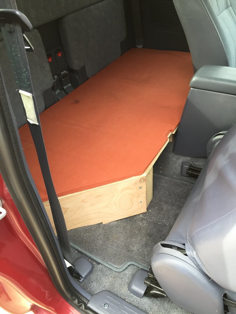

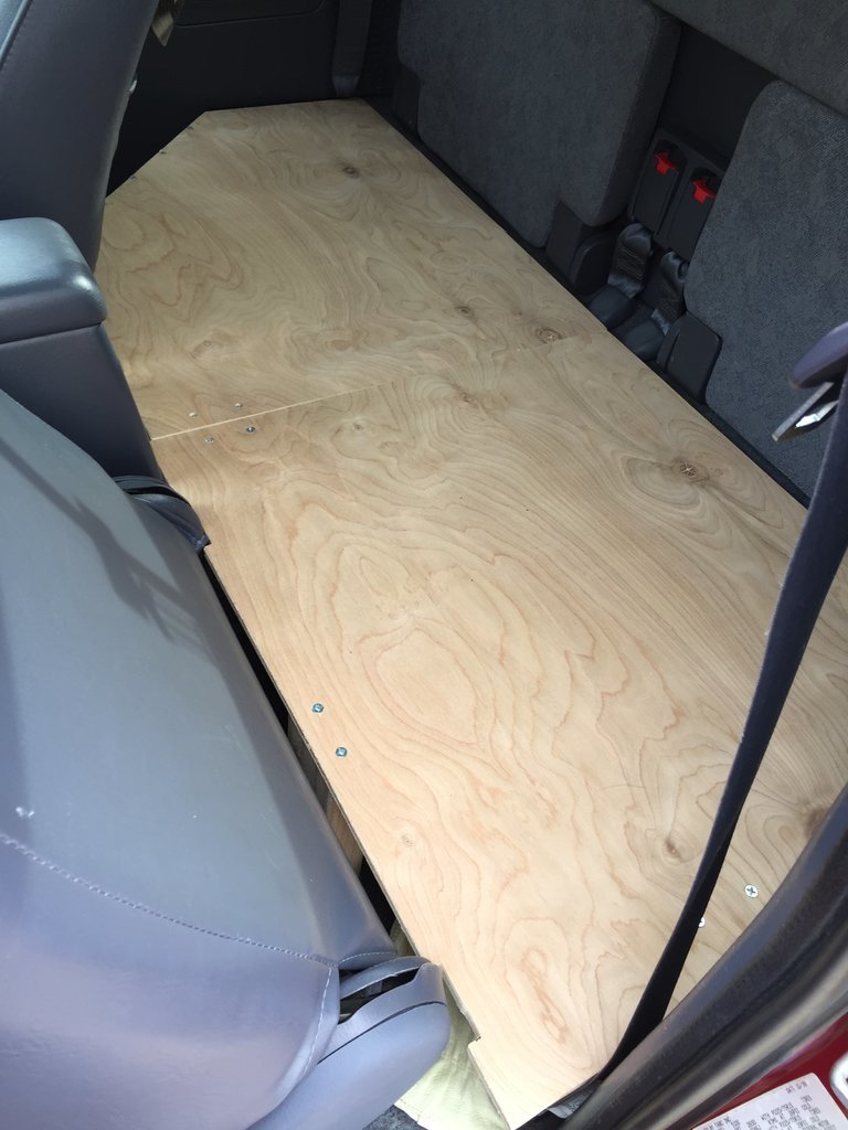

    It's in two pieces so it's easy to remove and put in the bed if you need the passenger space.
    I covered it with an old camping mat I had, which helped my dog dig his claws into so he wasn't slipping around. He's a good sized German Shepherd at just less than 100lbs. It sits on 2x4 feet but it's open enough under it that I was able to add tool clamps to the bottom of the platform and attach a hand axe, entrenching tool, & flashlight.
    I can't take credit for the idea - A poster in the 1st gen forum basically provided the dimensions for it. If I can find the link I'll post it. Otherwise a search should turn it up.
    Here's the basics:
    Dog platform
    Start with 2 rectangles 22 1/4 x 25 1/2
    3.5" foot sits on the transmission hump.
    The 6" foot sits next to the seat belt anchor,
    the 7" sits behind the seat.
    I notched out a section behind the passenger seat to make it easier for a big dog to jump in and out.
    I'd like someone to be able to use it. I built another for my 2015 with the seat bottoms removed which gives me enough room for both my shepherds now.
