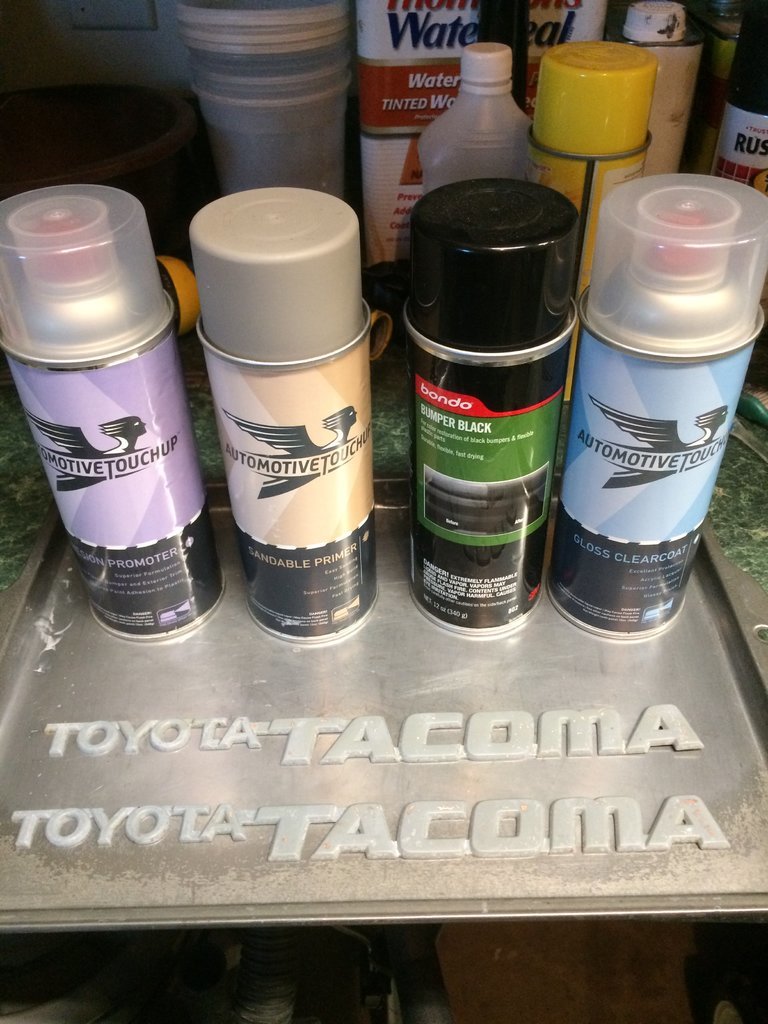

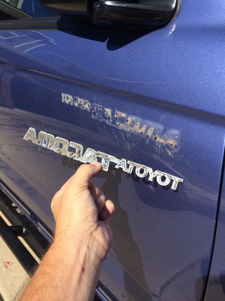

    I was successful refinishing the old emblems.

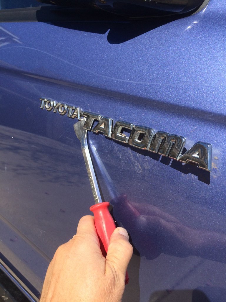

    To get the emblems off, I set the truck in the sun on an 80 degree day for about 10 minutes. They came off easily just prying with gasket scraper with no scratches on the paint.
    The dirt and glue residue came off the door with a wet sponge and some elbow grease. I can vaguely see a shadow outline where the emblem was originally, which shows me where to re-attach the badge. I used 3M Plastic Emblem and Trim Adhesive found at any auto parts store to re-attach.
    I use concentrated bleach (8.25% Sodium Hypoclorite) to eat away the chrome from the plastic emblems. Dip the emblem in a plastic container for about 8 hours or until it stops bubbling.
    There will be a black residue and some green.
    Clean off the black residue. I used a tooth brush.
    This process will need to be repeated. If some small gold flecks remain, use some fine sandpaper to remove them.
    Another option to remove the chrome from the plastic emblems is to use oven cleaner.
    I used Automotive Touchup products. I like their step by step instructions.
    I applied plastic adhesion promoter, primer, bumper black and gloss clear coat.
    They came out great and have held up well (2 years so far).
