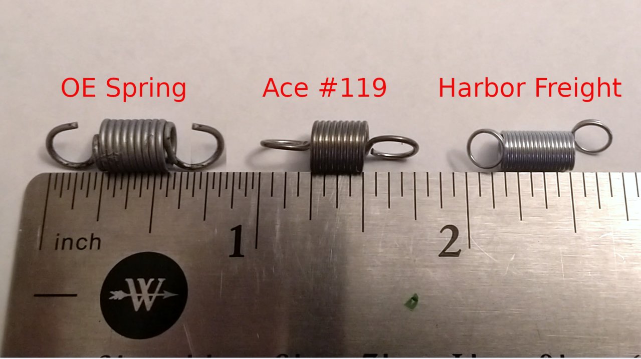

    I had to replace my driver's side door lock spring this weekend. I could not open my driver's door from the outside, inside, or using the key. Had to remove both seats and the center console for easier access. Hardest part is figuring out what to part of the lock component to lift to initially open the door.
    I found a working replacement at Harbor Freight in their Storehouse 200pc Spring Assortment. This spring is listed as a 13/16"L x 13/64"W. It has thinner gauge wire than OE and has more coils (17 v 10). It is working but I don't feel great about the thinner wire gauge and weaker spring strength. Ace Hardware was already closed by the time I went spring shopping, unfortunately.
    Home Depot has a spring assortment that looks like it has a spring that might work. Looks similar in gauge to the Harbor Freight
    https://www.homedepot.com/p/Everbilt-Spring-Assortment-Kit-84-Pack-13554/203133714
    Today I went to my local Ace Hardware and looked through their spring selection. The closest match is the #119 extension spring ($0.90/ea). This is listed as a 3/4"L x 1/4"W spring, and Hillman gives it a weight rating of 10.18lbs. It has thinner wire and one fewer coil compared to the OE, but it is a better match than the Harbor Freight spring.
    I reconstructed the OE spring in photoshop for reference purposes. Actual length may be slightly different.

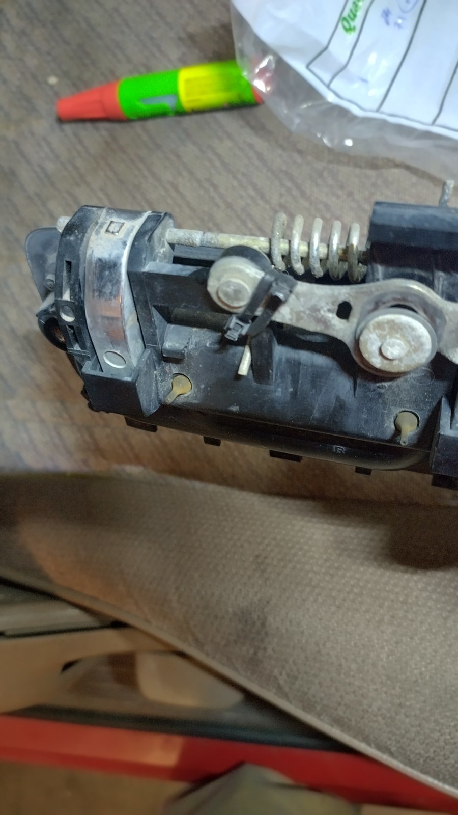

    Just replaced my driver side door lock actuator and the door handle itself. 20 years it lasted. Did the whole repair for about $175, all new parts. The problem was getting the door open one last time. If it is locked and the button will not pull up by hand, your phucked cause you need the door open to get the door panel off. Mine would only come up about halfway. occasionally all the way if I played with the handles inside and out. I sweated for two weeks until the parts arrived, and, fortunately was able to 'jimmy' the lock open one last time to do the replacement. works like a charm. getting one of the clips back on was a pain. It actually works better than it ever did. Found a brand new actuator at a blowout price of $149 on Ebay, add the $14 handle, door working again on the cheap...

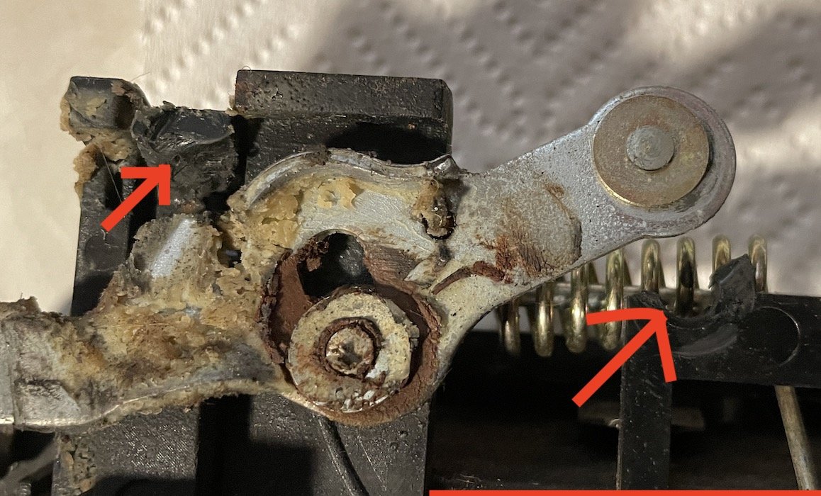

    Well now. Got mine taken apart. The infamous spring (yes it's supposed to be there on power door/power window trucks) on mine looks fantastic, and yet I was having trouble opening the door, if someone had just locked it: it couldn't be unlocked except with some persistence + luck.
    What's really "clever" about this bullshit design is that there are multiple ways for similar or at least related symptoms to fail. In my case, some plastic on the door handle had worn away where it presses down on the metal horizontal lever (go figure ... ) causing me to have to "pull up harder" on the door handle. Sound familiar to anyone? This is in the area of the left arrow in my picture.
    Even worse, the plastic securing main pivot point (right arrow in my picture) snapped, allowing the horizontal lever to pivot and move in interesting ways not intended by Toyota engineers.
    And yet it still mostly worked ... but for how long? O'Reilly's sells replacements from Dorman. You'll pay more than Amazon, but then again they might stock it and get your door working again on a weekend. Suck it up buttercup.
    They aren't probably made as well as Toyota's (all of the plastic looks thinner) but the action of the mechanism feels smooth and high quality, and far better than a broken OEM part. Toyota wants about $100 for this handle, O'Reilly's currently wants $35 for the regular all-black version, or $27 for one with a "chrome" puller. That's what my store had in stock and so I "upgraded" to chrome, because I am an old fart, and my Tacoma already had chrome bumpers yada yada, so with a touch more faux-chrome on the truck now I am just more fully embracing my old age. (On one side of the truck, for now.)
    The main slide point (middle of horizontal bar) already has some lube on it, but mine now has more, courtesy of some GM Lubriplate. (Lubriplate is thick white grease made to lubricate, um metal plates ... ) I also added some to other friction areas to hopefully stanch the tide of inevitability.
    Ran outta daylight and parked in the garage for the night. The bar that comes down and attaches to the catch mechanism needs to have its slotted end straightened out, which I'm hoping is the reason why when locked it would not unlock. That slotted end is thin metal; I can see why they usually become bent after all the lube everywhere turns to sludge. At the moment I don't how clean/corrosion-free I can get the catch mechanism but tomorrow's another day.

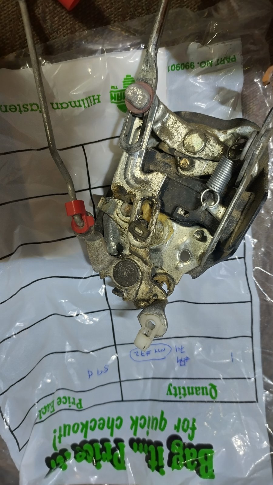

    Just had to redo the passenger side door lock spring (manual lock) in my 1996 Tacoma. Used an ACE hardware #74 spring. Had a #72 spring in there previously that was too strong. Fix working well, outside handle has a slight bit of jiggle, but at least i can open the door from the outside without a herculean effort! Pic is of the installed spring.IMG_20231118_150944_HDR.jpg
  16. Nov 18, 2023 at 8:12 PM
    #56
    Howwoward
    Howwoward New Member
    Sep 19, 2022
    #406165
    2
    1996 Tacoma, LX, V6
    Also, due to the excessive force to open the door from the outside due to the #72 door lock spring, the internal lever broke off at one end. I ziptied it back together per the pic, which is of the back side of the door handle. IMG_20231118_152500_HDR.jpg
