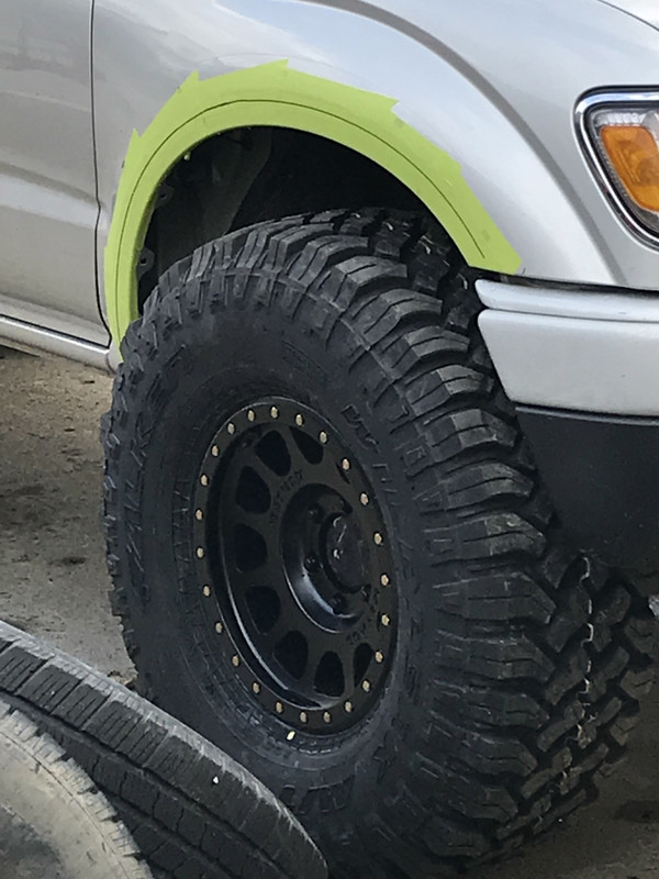

    I used 20 gauge and just cut until the tire no longer rubbed at full lock and bump. I took 1.75 inches off the front fender and 1 in the rear.

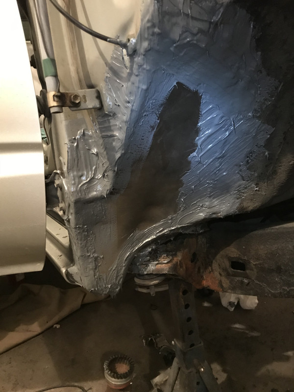

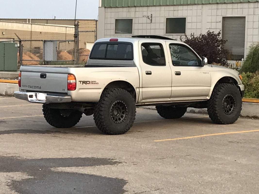

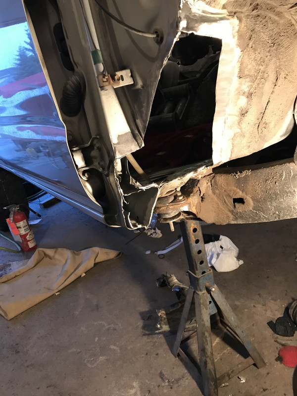

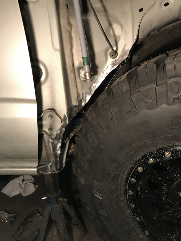

    I could’ve really used this thread a couple weeks ago. Here’s mine on 35s no lift, just front leveled with 5100s
    What's required?
    Firewall tubbing
    oh yeah. Oh shit yeah.
    Re-gearing the differentials
    lol nah
    Fender Trimming maybe a little
    Wheel backspace
    more helps
    16x8 4.25 backspace I think. Rubs frame still
    Something else to consider-
    Rubbing upper control arm on tire. Mine doesn’t rub at ride height but does rub significantly when it’s dropped. I need to put a 1/2” spacer on or something. I could trim the upper but the amount that would need to be cut may compromise it’s strength. And I don’t want to spend $800 on new control arms (insanely priced wtf). An actual wheel spacer will help with that. Stock 6 spike wheels with a small spacer will clear.
