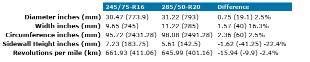

  18. Nov 9, 2011 at 1:36 PM
    #58
    Juggernaut
    Juggernaut Captain
    Sep 21, 2009
    #23111
    1,908
    Sacramento
    25 TRD OffRoad DCSB
    So I think we have decided on 285/50r20 tires:
    from the online tire size calculator
    And If you are going to lift the front ~ 2 inches (what the spacer kit you posted would do), I would instead buy Blistein Shocks for just the front @ $180 and set them on the 1.75'' lift setting, or buy front and rear blistein shocks for an improved ride @ ~$300. FYI, the rear blistein shocks do not lift the truck, only the front ones do, they are their solely to improve the ride.
