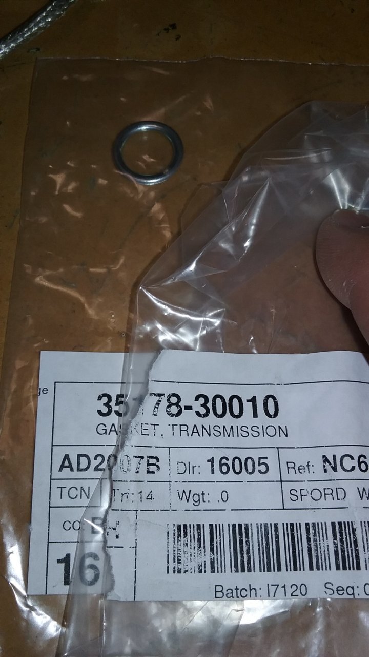

  11. Jul 3, 2019 at 5:41 PM
    #31
    Plain Jane Taco
    Plain Jane Taco Well-Known Member
    Apr 19, 2009
    #16179
    40,279
    USA
    Yikes! Sorry about that. Post edited.
    The drain and check gaskets are the same
    Part# 35178-30010
    @bevans
    bevans[OP] likes this.

  13. Jul 3, 2019 at 5:44 PM
    #33
    Plain Jane Taco
    Apr 19, 2009
    #16179
    40,279
    USA
    Also....the fill plug uses an o-ring. No reason to replace that one.....assuming it's not damaged
    bevans[QUOTED][OP] likes this.
