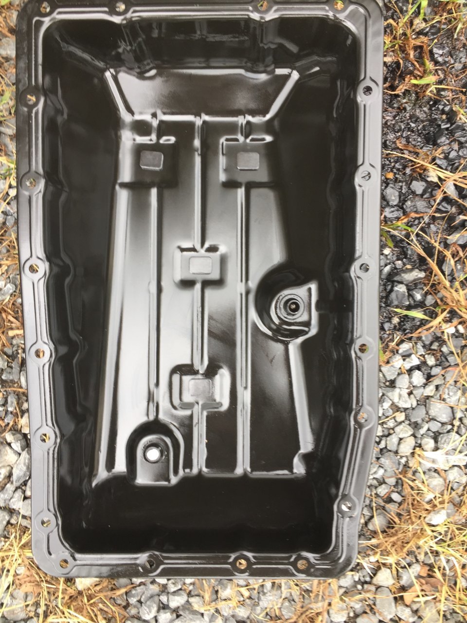

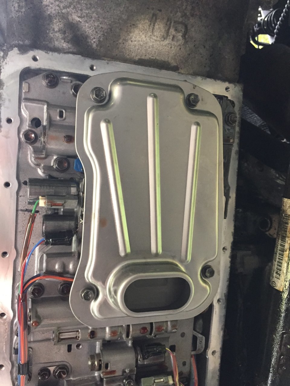

    Thanks to TW I did a pan drop/filter change/full flush at 125,000. It was easy and the fluid was pretty dirty. I am happy to have done it. Cost was about $100 for the Valvoline MaxLift synthetic ATF and $25 for a filter and gasket. Well worth it IMHO.

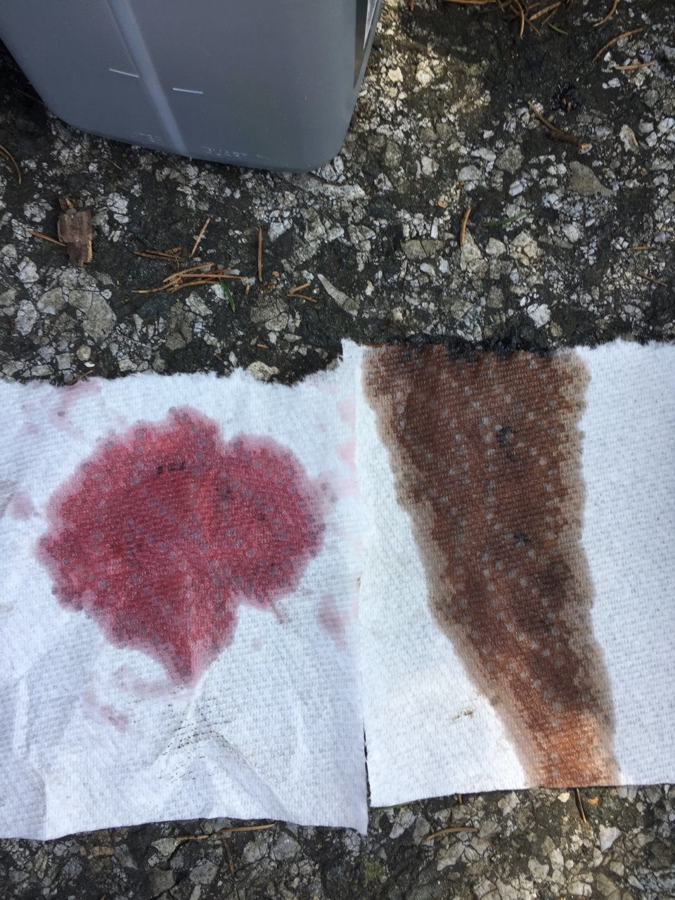

    The decision whether to flush or not should be based on the current condition of the ATF, regardless of mileage. ATF that is gritty or has metal specks is usually material from damaged clutch packs. Doing a full flush will remove this material from the ATF which could lead to slipping because this material may be the only thing that keeps the trany from slipping. The best way to check for these contaminants is to drop the ATF pan. If you see clutch material or metal specks, put the contaminated ATF back in the trany and drive it till the trany meets it's doom, and start saving for a new trany. While you have the pan down, clean it and install a new ATF filter.
    If you take a small ATF sample and look at it's color, you may avoid having to drop the pan. Use a white napkin to check the color of the ATF. It there any red or purple hue, the ATF is in relatively good condition and it can be flushed or do a drain/refill. If it black and smells burnt, you should definitely drop the pan, clean it and replace the ATF filter, and check for contaminants.
