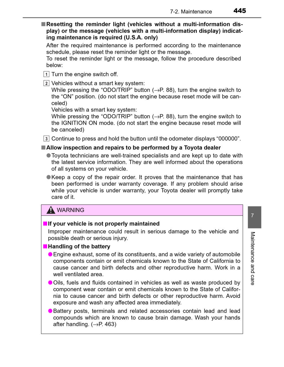

    The owners manual gives helpful details on the functions of the light and instructions on how to reset.
    It's not part of the OBDII system, it's a simple mileage counter. At 4500 miles since last reset, it acts as you currently see. At 5000 miles it will stay on solid.
