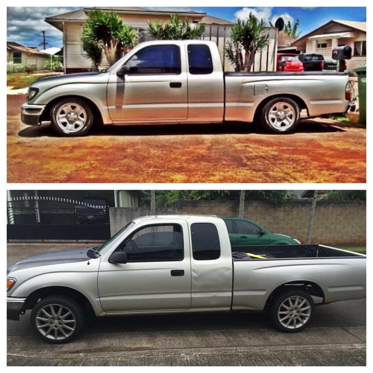

  2. May 20, 2018 at 4:23 PM
    Silversurfah808
    Silversurfah808 [OP] Active Member
    May 17, 2018
    #253749
    29
    Run'emhaad
    Oahu
    2001 Tacoma 5lug xtracab
    FTK7014 - spindle lift kit/AAL
    Lowlife to HIlife
    (Pictures from previous owner)
    Last pic: current situation
    Sperrunner likes this.

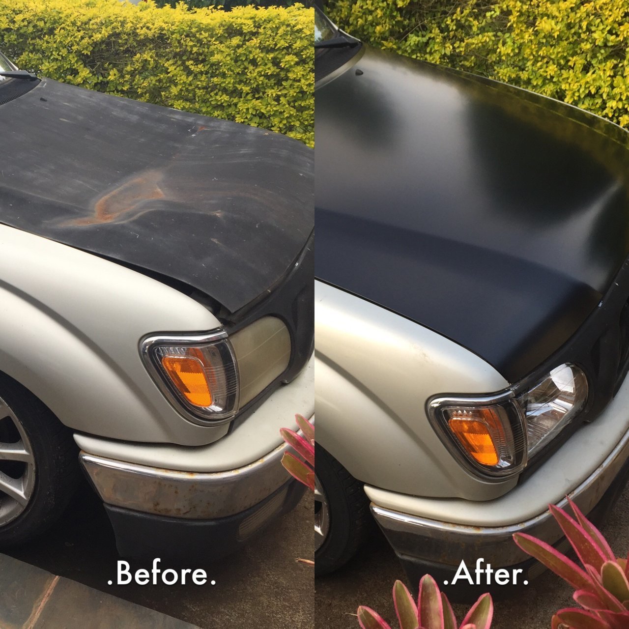

    Previous owner had the hood latch fail and the hood flew up and hit the top of the cab.
    Got it replaced

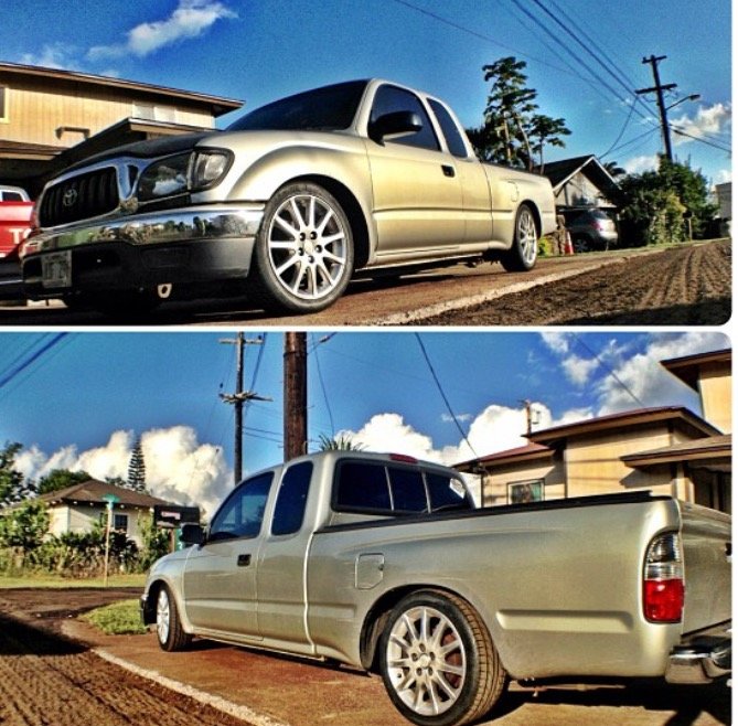

    Why did you decided to lift it? looks good lowerd.

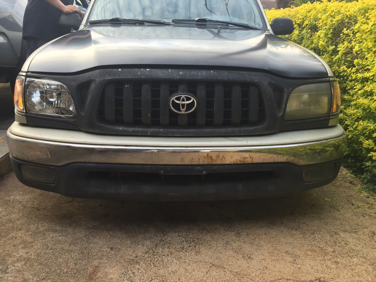

    New headies and Grill

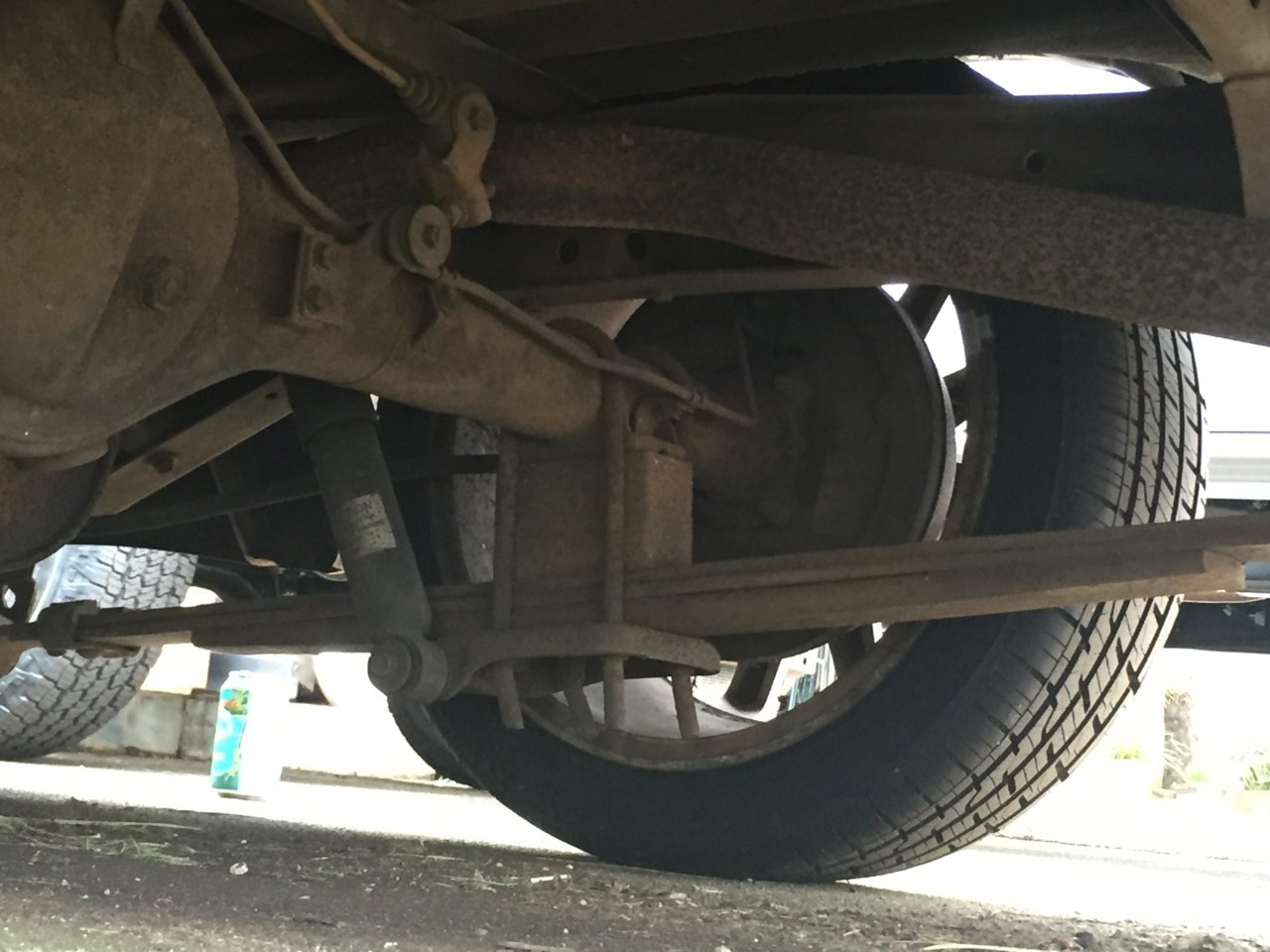

    Yeah, I liked the look of it but not a fan of driving it on Hawaii roads, We have a bad pot hole problem that our state takes a long time to fix.
    The ubolts were bent and the heat sheild from the exhaust is all tore up from hitting bumps. (Which I need to rip off since it rattles Everytime I drive it)
    I Bought this truck off my homie that always had it lowerd and it was just sitting in his yard for a year just looking dead. His brother and I go fishing a lot and I needed a truck.
    We have an off-road state park here on Oahu (KaenaPoint) where we do a lot of fishing.
    His brother got a 2018Tacoma4x4 and made me want to get a truck to go rambling too :p he can pull me out if I ever get stuck haha

    Dude thats a pretty hard core drop, blocks and looks like 6lug leafs with the 5lug over load. He should of c notched the frame. That or he destroyed those 5lug leafs. But those need replacing big time. Also you need to get the stock bump stops back. How was the front lowerd? Bj flip?

    So it had like a 3/4 drop

    Yeah, and they used stock infinity G35 springs.
    I had to buy new stock OEM springs

    Oh he had that thing low then, I thought that looked lowe then a 3/4 drop

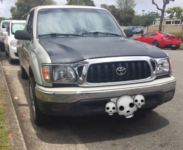

    Are you trying to lift or go back to stock. sweet truck btw, that thing looked pretty clean laying frame.
    Also, whats up with your camber in the pictures with the skulls coverin the license plate?
