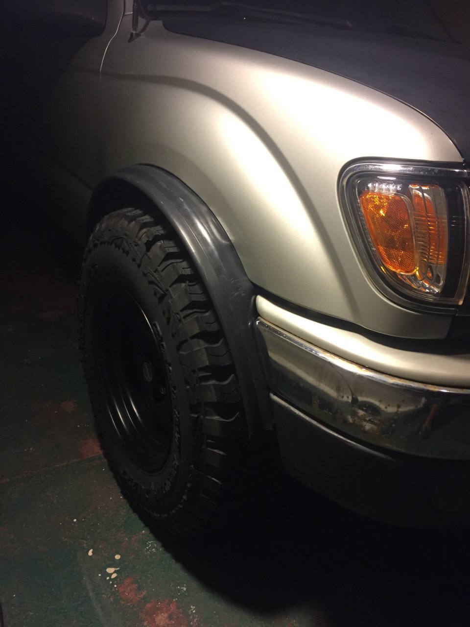

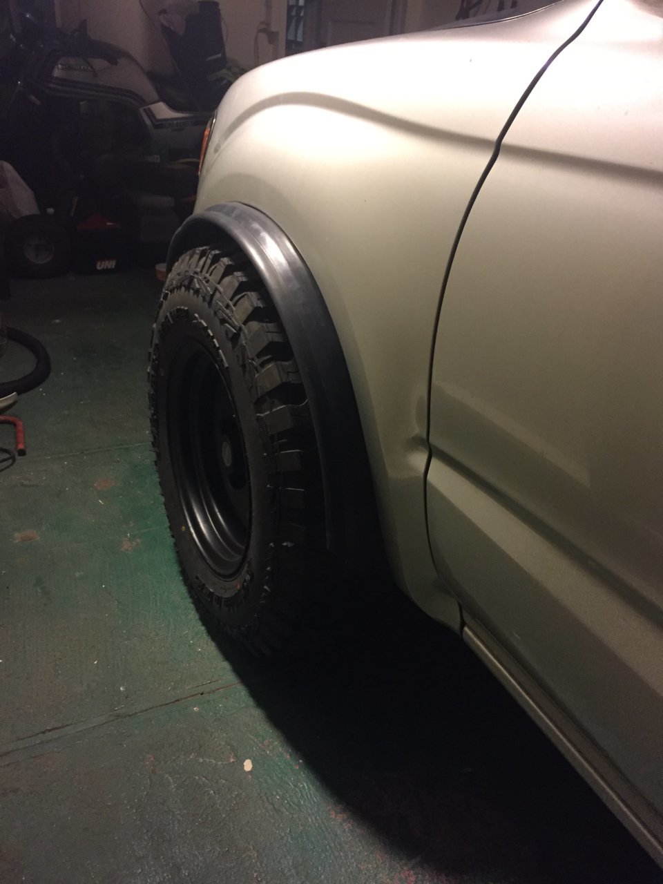

    State law requires us to have fender flares over the threads of the tire
    (I know they don't completely cover but it'll pass until I can redo them..
    I have yet to find any on CL or the junkyards
    This will have to do for now
    Garden edging at is finest :rofl:

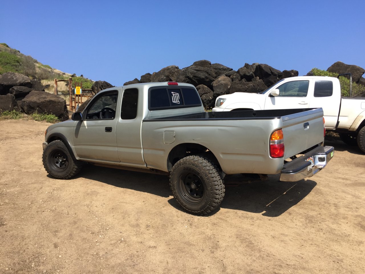

    I haven't posted in a while due to having too much fun in the taco!
    Here's an update
    Drove it all the way to the second gate :taco:
    This is Kaena Point state park on the Nortshore. 2.5miles of dirt road and hidden beaches with great fishing spots. I was pretty nervous driving but she held up just fine. image.jpg
