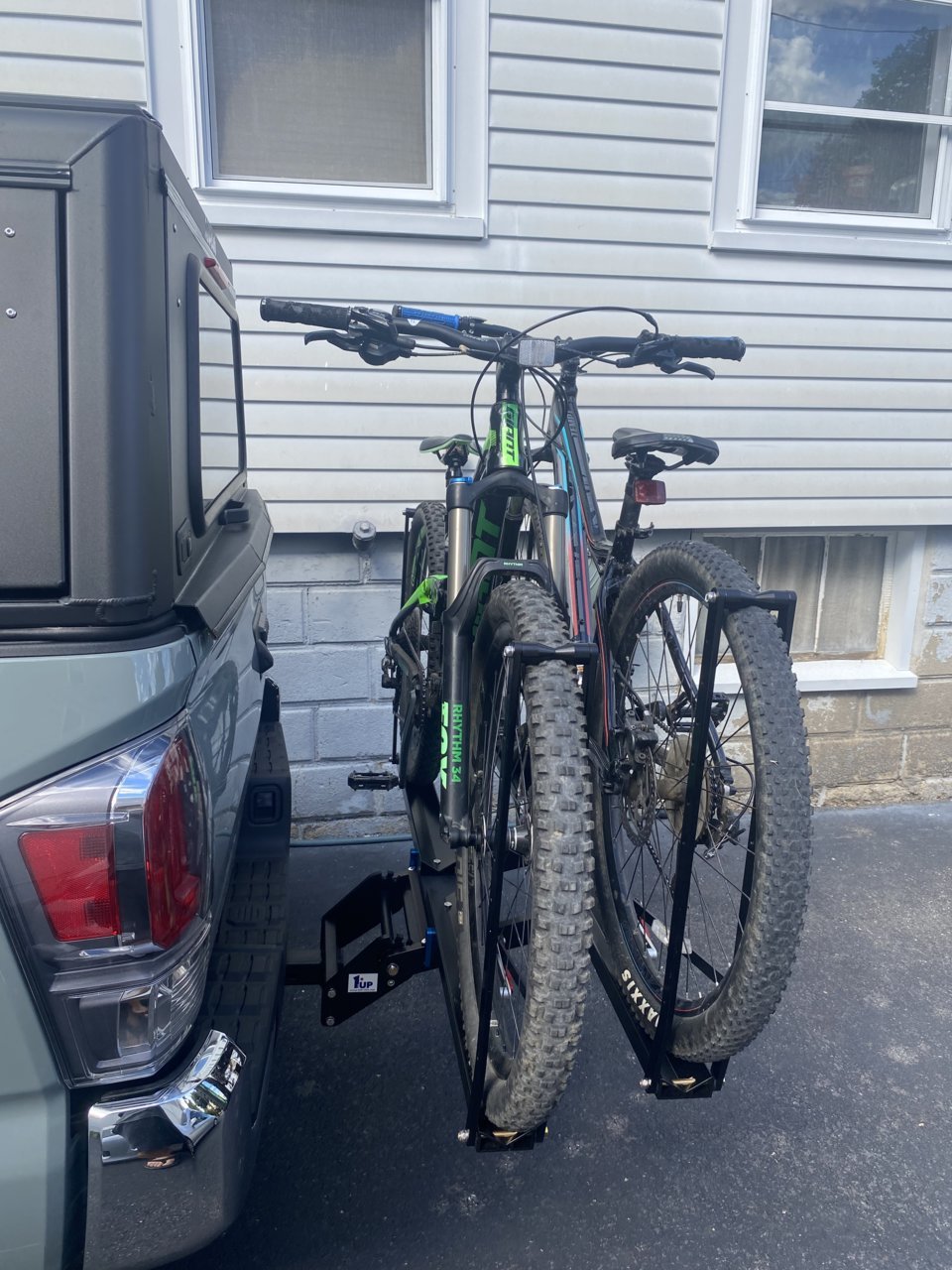

  15. Aug 12, 2022 at 2:02 PM
    mattybouges
    mattybouges Well-Known Member
    May 16, 2022
    #397313
    57
    Boston
    2022 Lunar Rock TRD OR Short Bed

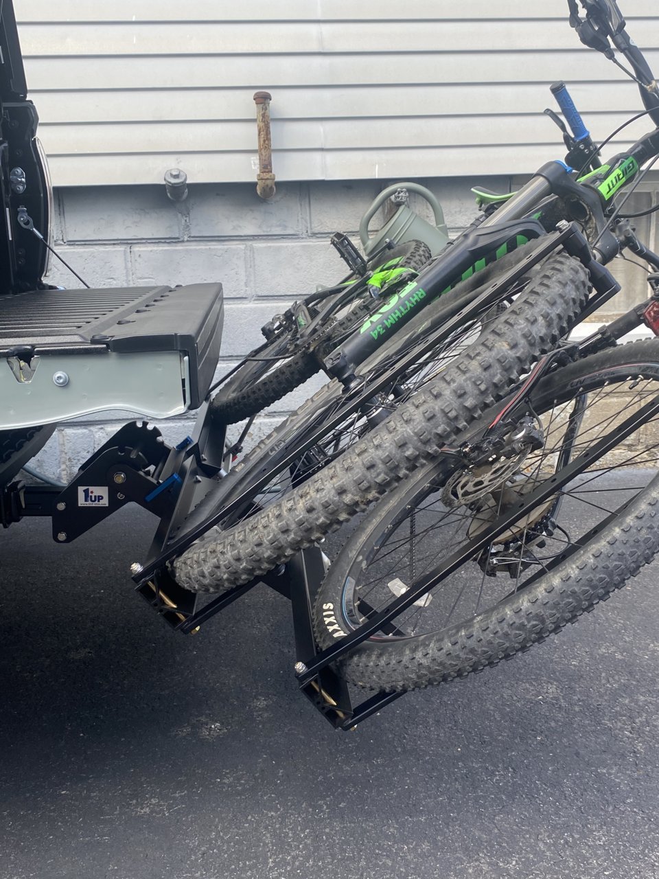

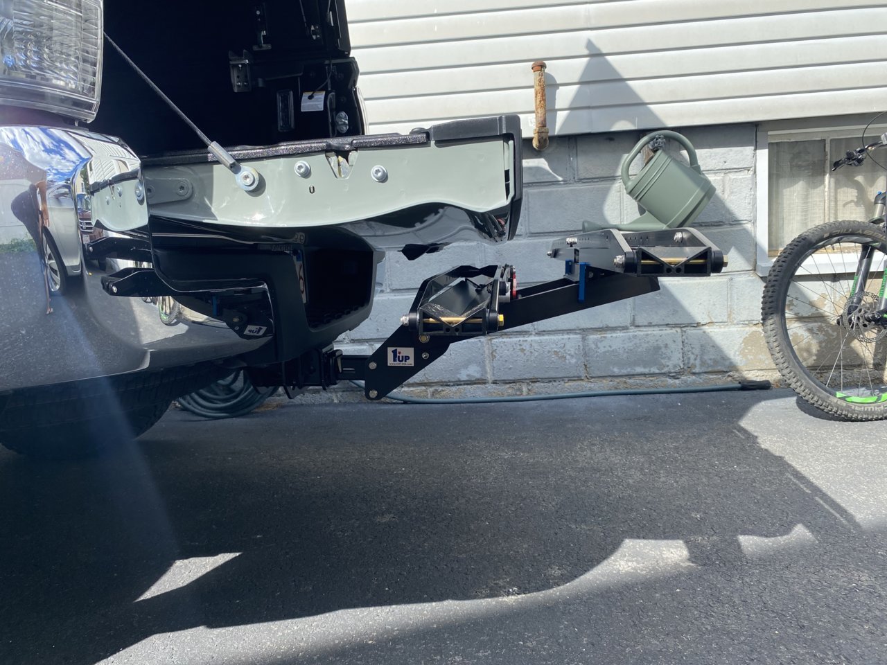

    Update for 2022 models. Here is my 1-up 2” receiver heavy duty model install.
    - tailgate down clearance w/o bikes: check
    - Tailgate down clearance w/ bikes: check but make sure pedals are positioned out of way
    - MTB handle bar clearance with Cap: very close with my ALU-CAB cap
    - Use of backup camera: decent visibility but phantom guidelines are useless
  16. Aug 13, 2022 at 6:44 PM
    #16
    mattybouges
    May 16, 2022
    #397313
    57
    Boston

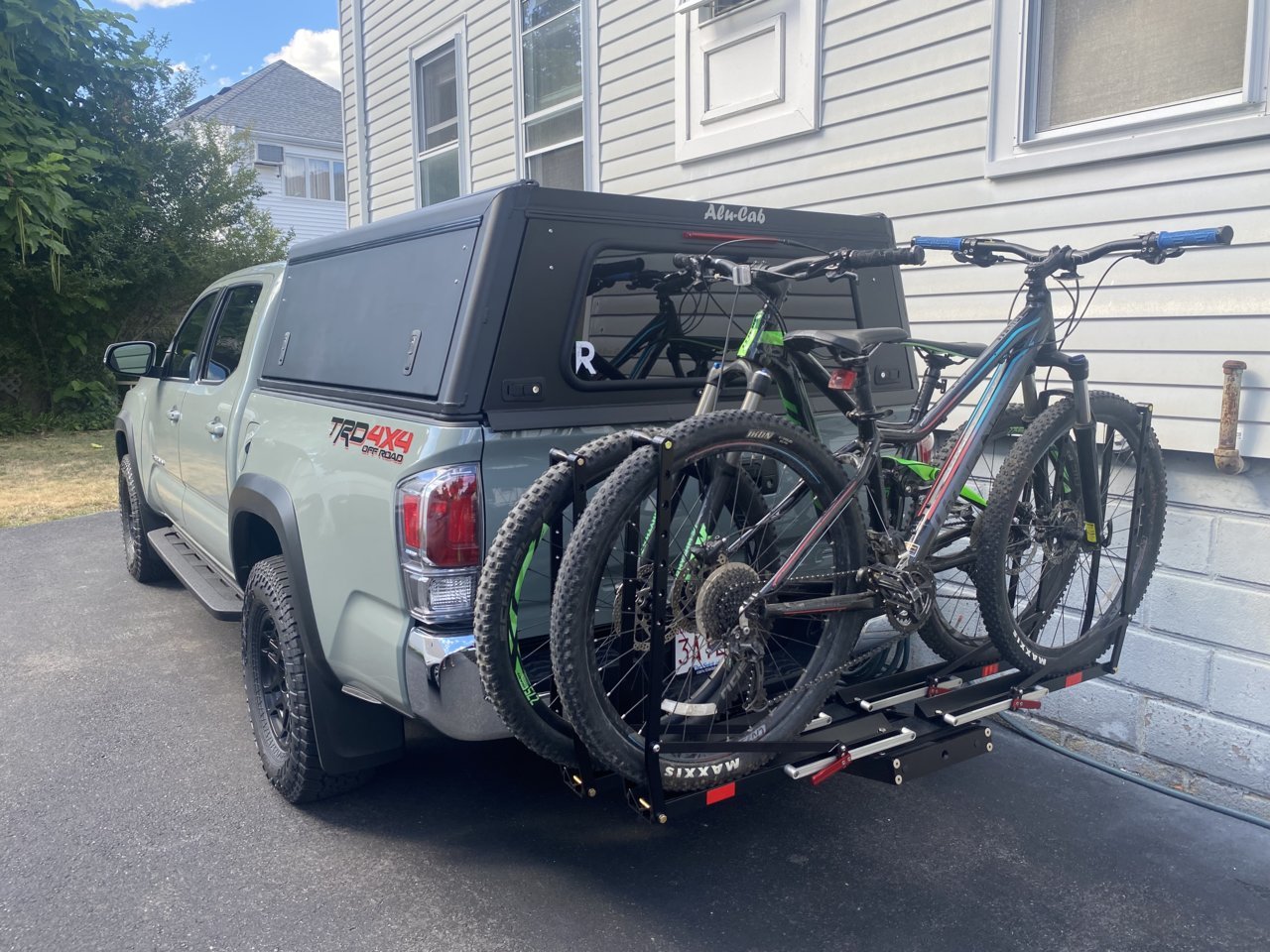

    The handle bar clearance to my cap window is a bit too minimal for my taste. I like the 1-up as it is amazingly stable, but with swaying bikes over rough roads/trails, I'm now worried I'm going to crack my cap window.
    Any ideas? So far I'm coming up with:
    - I think 1-up sells a receiver extension, but I'm not sure they have the hitch anti-rocking feature
    - Make a handlebar pad to dampen the impact to the glass if that actually does occur
    All ideas welcome!

  17. Aug 13, 2022 at 10:15 PM
    #17
    Malvolio
    Malvolio free zip ties for Stun
    Jul 23, 2018
    #260236
    3,211
    SoCal Dumbgeon
    2017 DCSB SR5 2WD
    Tennis ball with a slit cut in it.
    OZ TRD likes this.
  18. Aug 13, 2022 at 11:12 PM
    #18
    OZ TRD
    OZ TRD Well-Known Member
    Feb 7, 2020
    #318480
    1,915
    Central Coast CA
    6sp Manual TRD PRO - Lunar Rock '21
    Evo A SmartCap, Cali Raised Sliders (0 degree), 2WD low Mod, Puddle Pods, 3 switch overhead panel, 8 slot middle console panel, Custom driver's switch panel, Rek Gens, 265 75 16 Falkens, lil B Bed Stiffeners, All new Speakers, Diff Breather, AC Drain, Many interior bits...
    My smartcap rear window is not as vertical as your Alucab so I have a bit more clearance.
    Something you might also consider is cutting down your handlebars. This will give you more room to play with.
    I do not like the full width (now at 800mm+ it is just silly, I think.) I always cut them down…
    I ride some tight trails so I like to be a bit more ‘narrow’…
    You likely will not miss a half, or even a full inch off each end.
    Tacomags likes this.
  19. Aug 14, 2022 at 6:54 AM
    #19
    mattybouges
    May 16, 2022
    #397313
    57
    Boston
    Definitely an option; I started out mtb’ing hating the wide bars for that given reason but have grown to appreciate the added stability. Maybe we should design a telescopic handlebar; would make bikes easier to stow!
