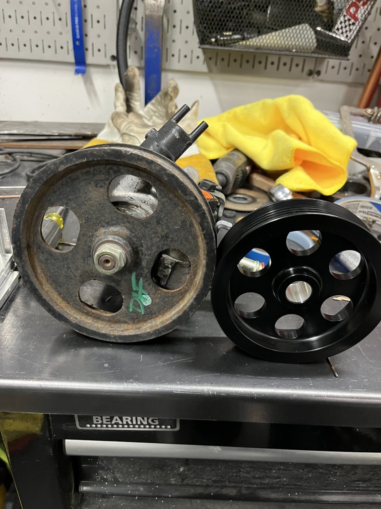

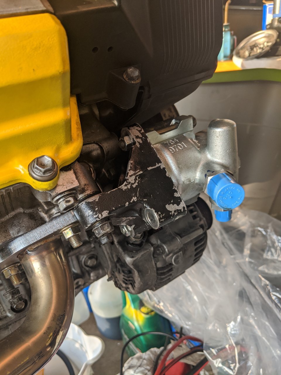

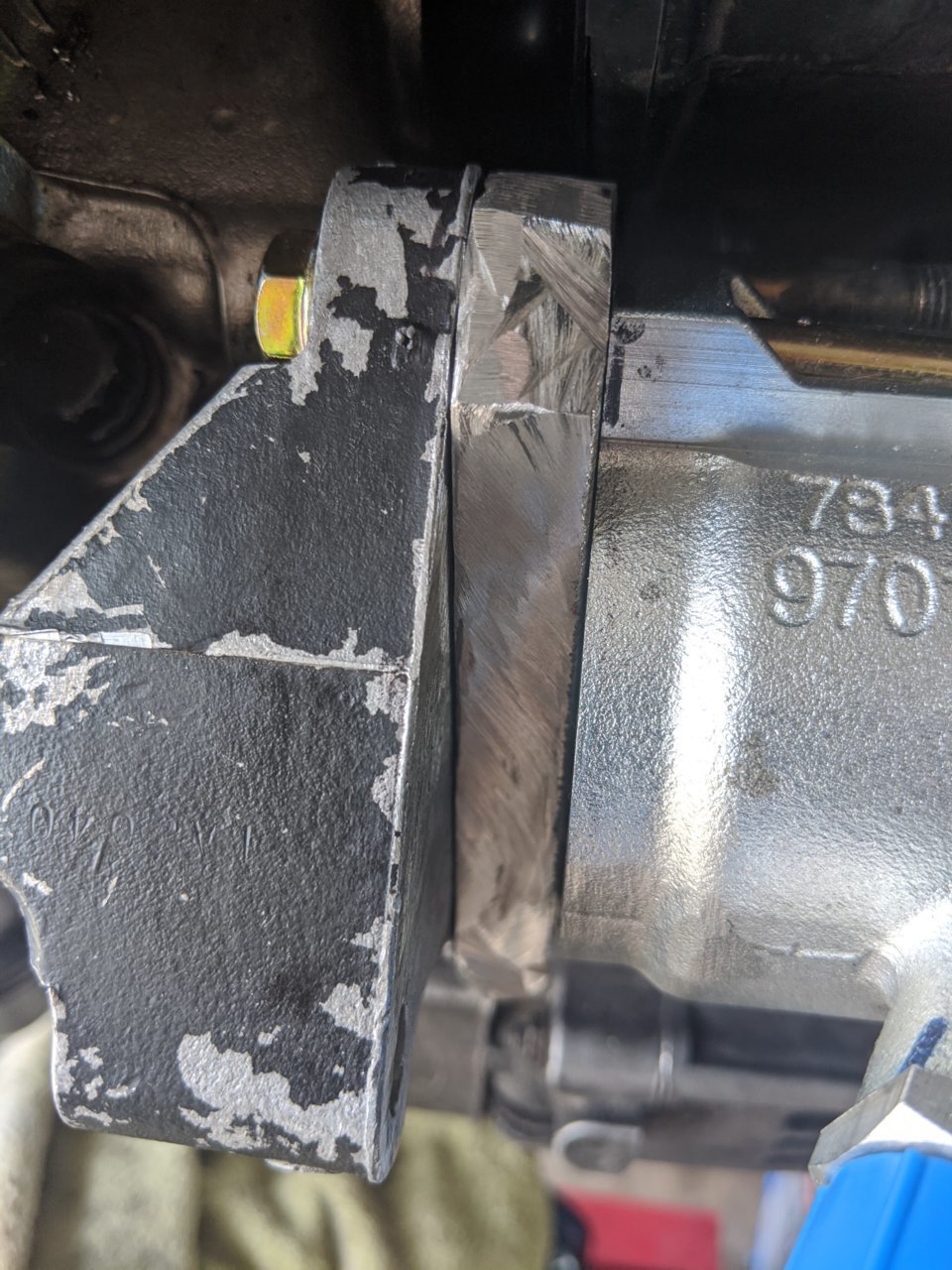

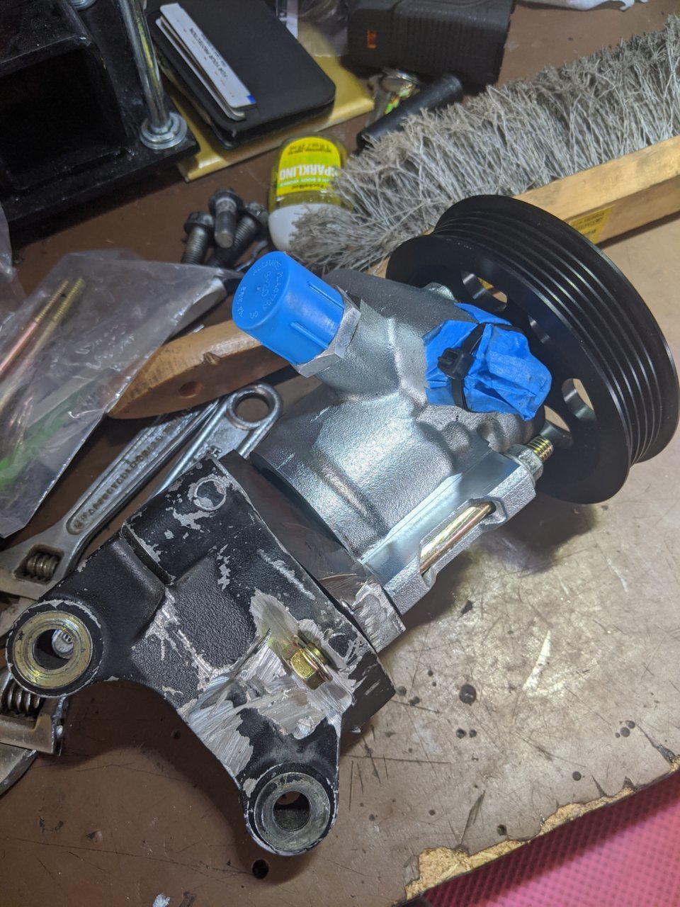

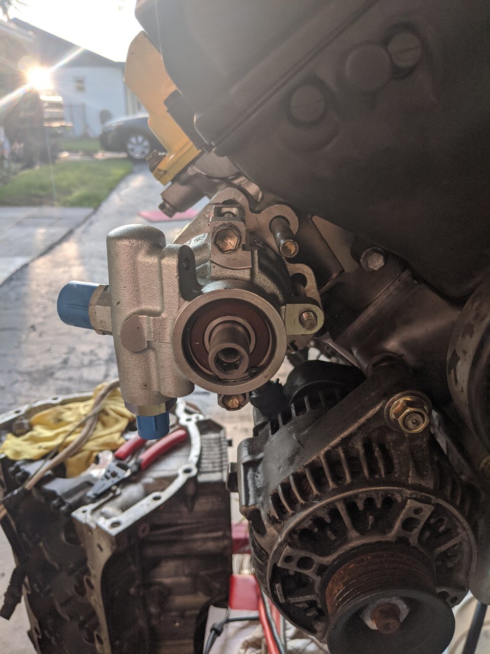

    I know there won't be many out there but I did find an easy was to add a psc pump to a 1uz.
    The pump I used
    https://www.polyperformance.com/ste...uty-ps-pump-for-gm-jeep-suzuki-toyota-sp1200x
    The pulley
    https://www.summitracing.com/parts/tgi-303411-kit?seid=srese1
    You will also need a stock 1uz power steering pump.

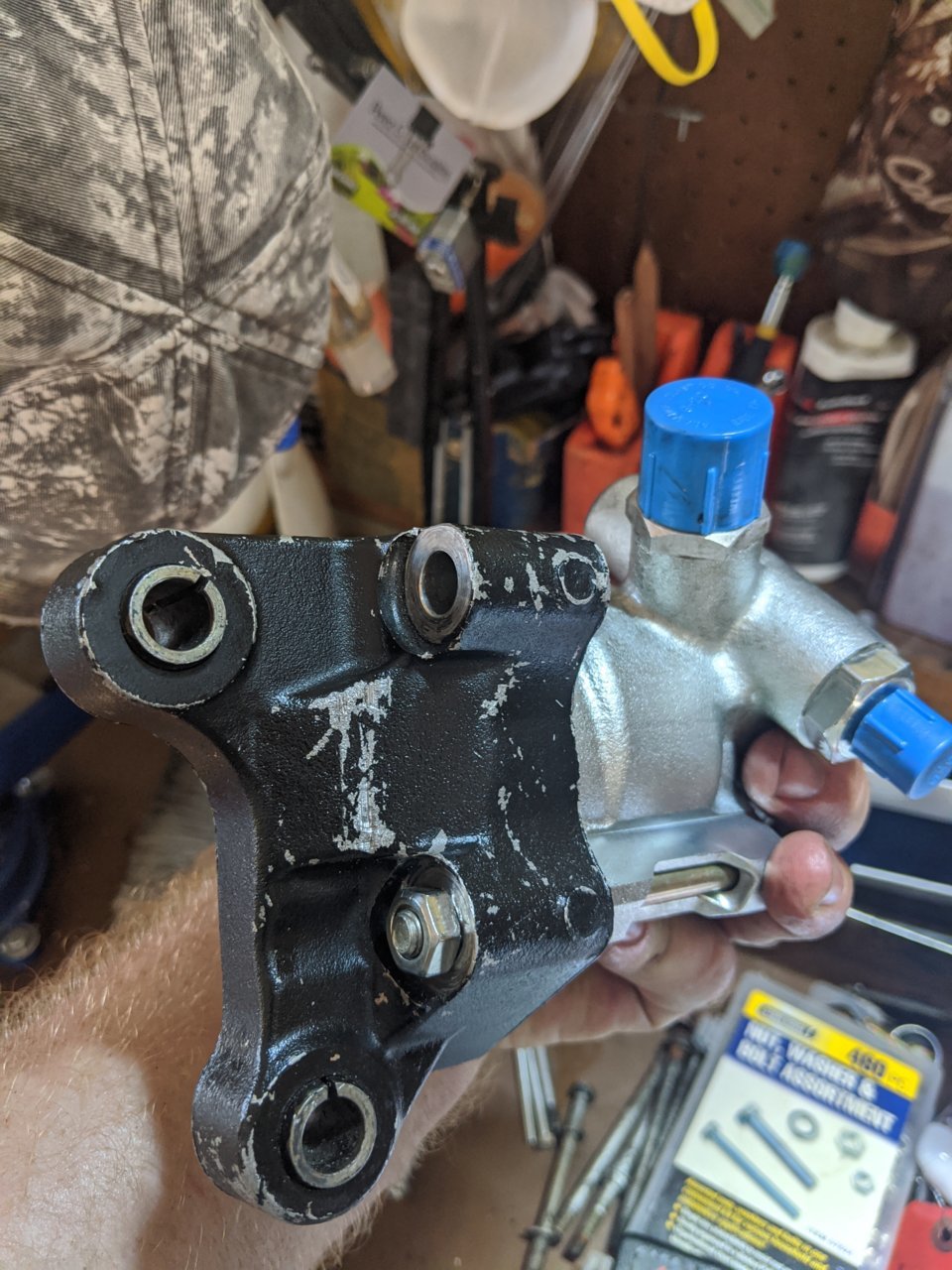

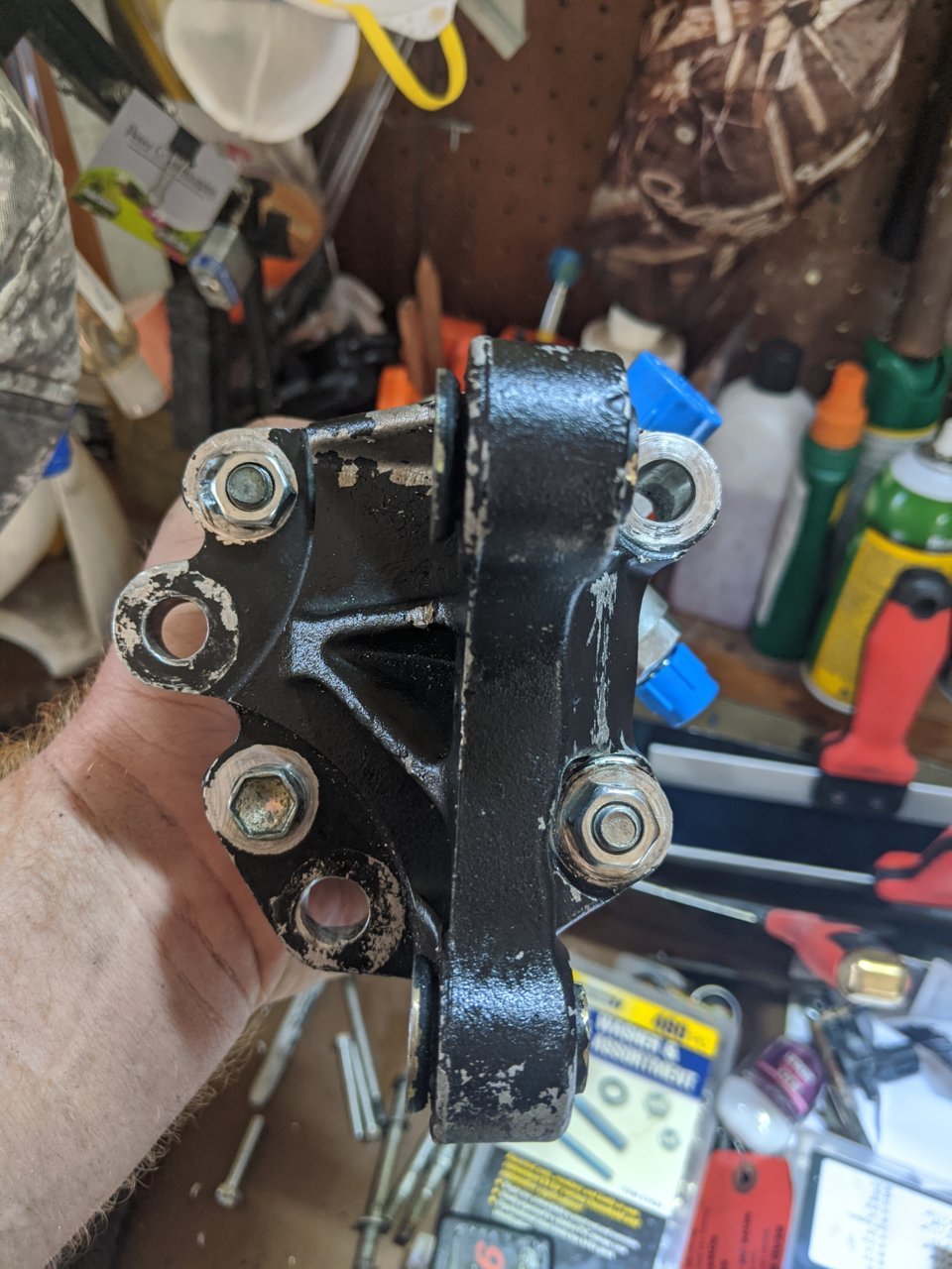

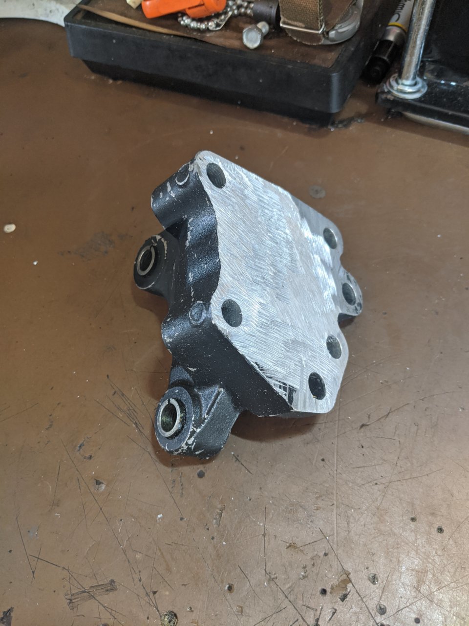

    First remove the rear housing off the stock ps pump.
    Now cut the raise section off and make the surface smooth, I used a sawsall and a grinder.
    2 of the bolt holes will line up and one will need to be enlarged.

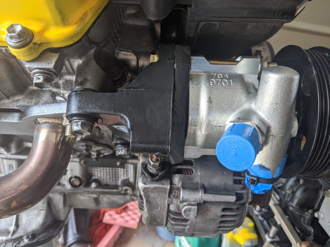

    And there you go, I'm still waiting for my pulley to come in but lining up the old 1uz pulley it all looks good. I will update the thread once pulley comes in.
    Edit/Update
    Bit of an update. Once I got the pulley in I found I needed a 1/2" spacer so I used 1/2 plate steel and some extended bolts (m8x1.25 x 100mm). Now the pulley is aligned properly.

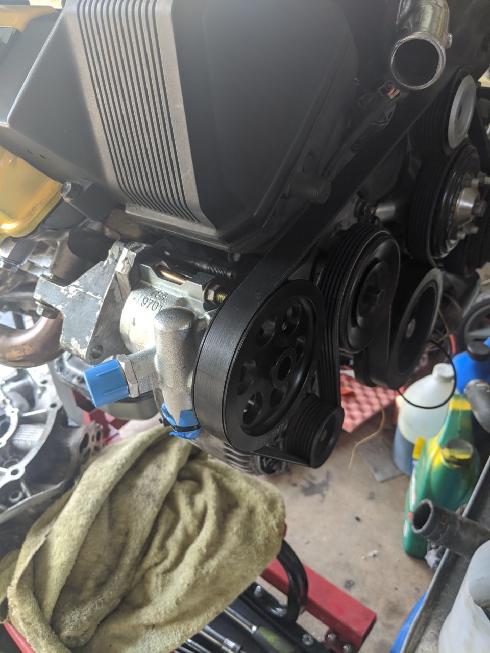

    Sorry to bump an old thread, adding the same pump to my 1UZ. Since its a smaller pulley, did you have to run a different belt?

    What vehicle did your uz come out of? The belt I use is for a 96 sc400

    98 LS400, mine is a vvti. But the mount looks identical to yours.

    Ah that explains the difference in pulley size. You will probably need a smaller belt luckily those aren't hard to get and it's totally worth the upgrade.
