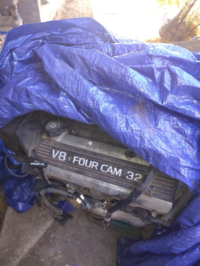

  20. Mar 27, 2025 at 8:29 PM
    #20
    LilSmokE
    LilSmokE Member
    Jan 1, 2025
    #463364
    24
    Reynaldo
    2001 prerunner turbo
    2inch lift turbo
    My journey to building a spicy taco has finally begun
