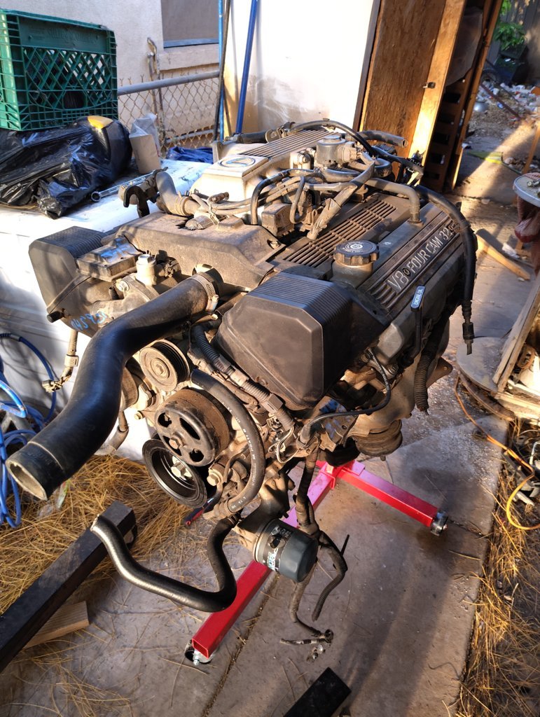

    Well she on the stand getting ready to tare down the top redo all seals. But I was looking at something, can I use Tacoma throttle body on the 1uz

    #1. You may wish to start your own build page or thread this was started by another member.
    I have no idea if your Tacoma throttle body will fit, suspect not due to bore size also the 1uz performs IAC in a different manner. I highly recommend you buy volume 1 of the factory service manual for the year SC400 that engine came out of, tons of knowledge and great information and better than getting tribal knowledge from the internet. Also remember 1993 last year of OBD I, 1994 and later OBDII, also on the right hand side of the block there is a data plate with the vin# of the car the engine came out of you can take that to Lexus and get service history of vehical. GL

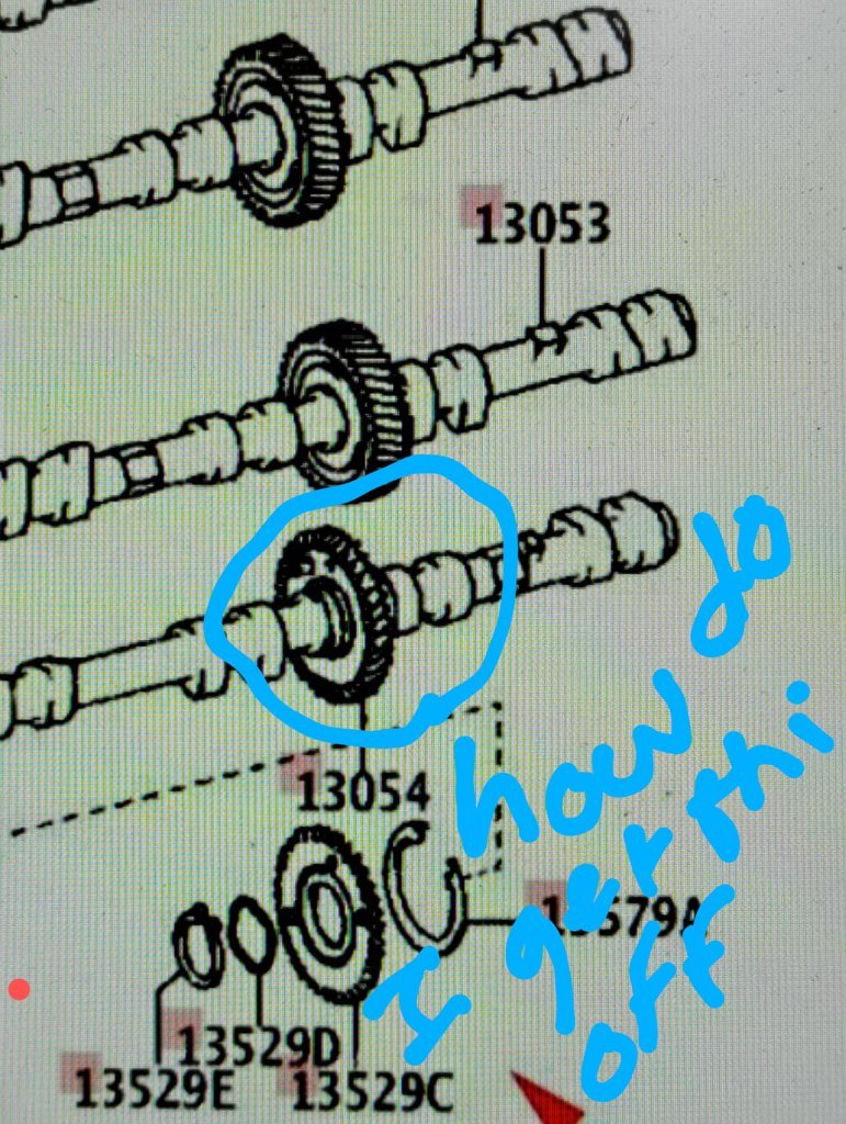

    IMG_1709.jpg IMG_1708.jpg IMG_1707.jpg In the service manual.
    R/
    LilSmokE likes this.

    Omg I didn't think the had these steel awesome
