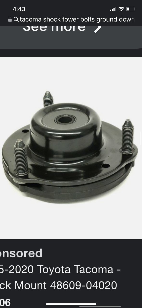

    When placing a 1” block in top of the shock tower, the factory bolt sticks out about 1/4” (it’s a cone shaped). They had to be ground flat for the newly placed block to seat flat. Then yes, about 2-3”’has to come off the too long rear u bolts.
    see pic, imagine a 1” block setting down on top of that, the little cone piece sticks out
