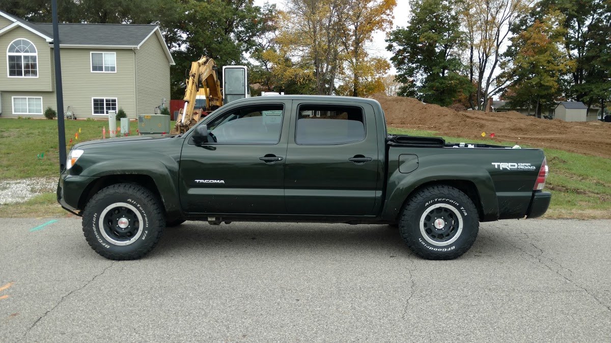

    It won't be quite as extreme as that picture lol... but it will be pretty level eventually just through sag on the springs.
    This is mine with an empty bed, albeit on a slight incline, but just look at the front fender gap vs the rear. It's essentially level.

    Is that with a 2.5” or 2”? A friend of mine put the 2” on his Tacoma and it looked level to me that’s why when 4wheel said to go with a 2.5” I was torn and eventually went with the 2!

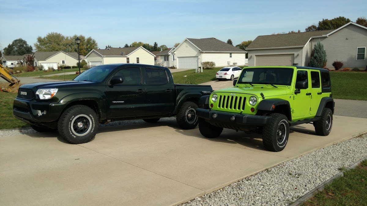

    And this was stock suspension with a bed loaded with stuff... so if you ever intend to use the truck as a truck and load up the bed, imagine yours basically doing the same, except sitting 2" higher up front.

    That's straight up stock suspension, no spacer.

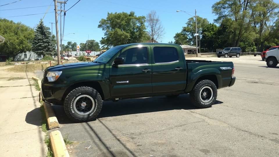

    That's what I was thinking... This is another shot of mine on level ground with 100% stock suspension. Its basically perfectly level as-is with a 2-leaf+overload stock leaf pack. It had been loaded up near it's max payload several times in the past, which may have caused it to sag some compared to when it was brand new.

    Well hmm I don’t see a sag in my rear end. It’s higher than the front so I’m keeping my fingers crossed on this one!
