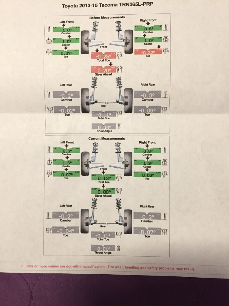

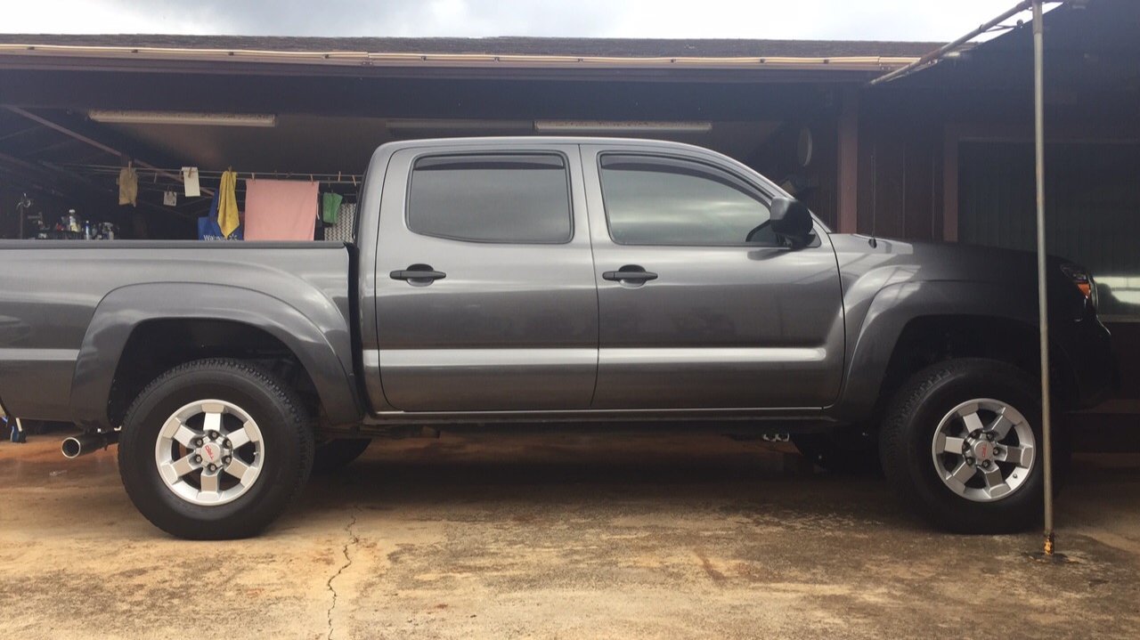

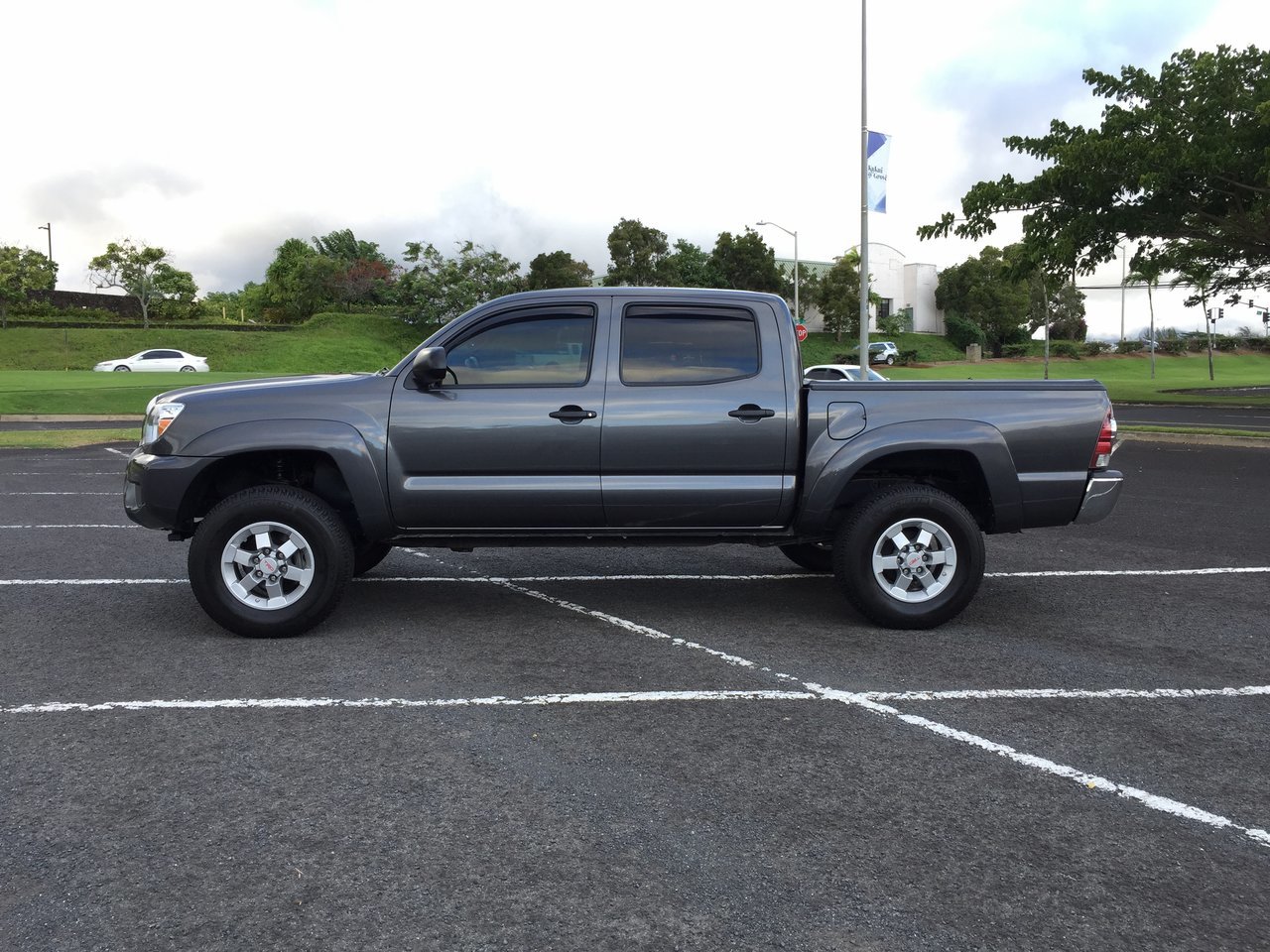

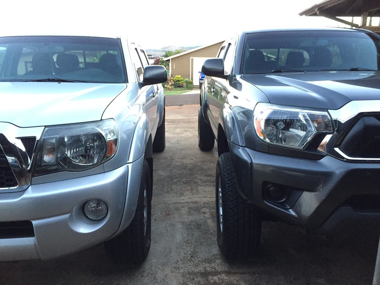

    After lots of bad words and frustration the work is finally done and here is the results to my 2” front strut spacers and rear 1” blocks that were so called not needed!! Lol wasn’t sure if I should have gone with 1” or 1.5” for the rear but I was afraid that the 1.5” would bring the back higher then the front and I’d be right back where I started! :rofl:Got the alignment done today and it’s all finally done! Next project is to put in the fog lights! :goingcrazy: Lol.. here are some pics, first pic is before the rear blocks went in, sorry that picture isn’t that great. :)8CA36CEC-C749-4FB1-A9D1-D777CE6FC973.jpg F6CB0A89-15E4-4415-A303-09799F1A9DCE.jpgD54A5F67-ECE7-43F8-9277-75B2A28D5D4A.jpg 09D043AC-7B98-4767-AB25-FA8541FFA9FC.jpg

    Looks perfect. You even got a damn good alignment and not just a toe&go. :bananadance:

    OP your truck still looks higher in front.

    Yes, it is a little higher in the front still but that's as close to level as Im going to get I think! If I put 2" blocks in the rear I think I'll be higher than the front.
