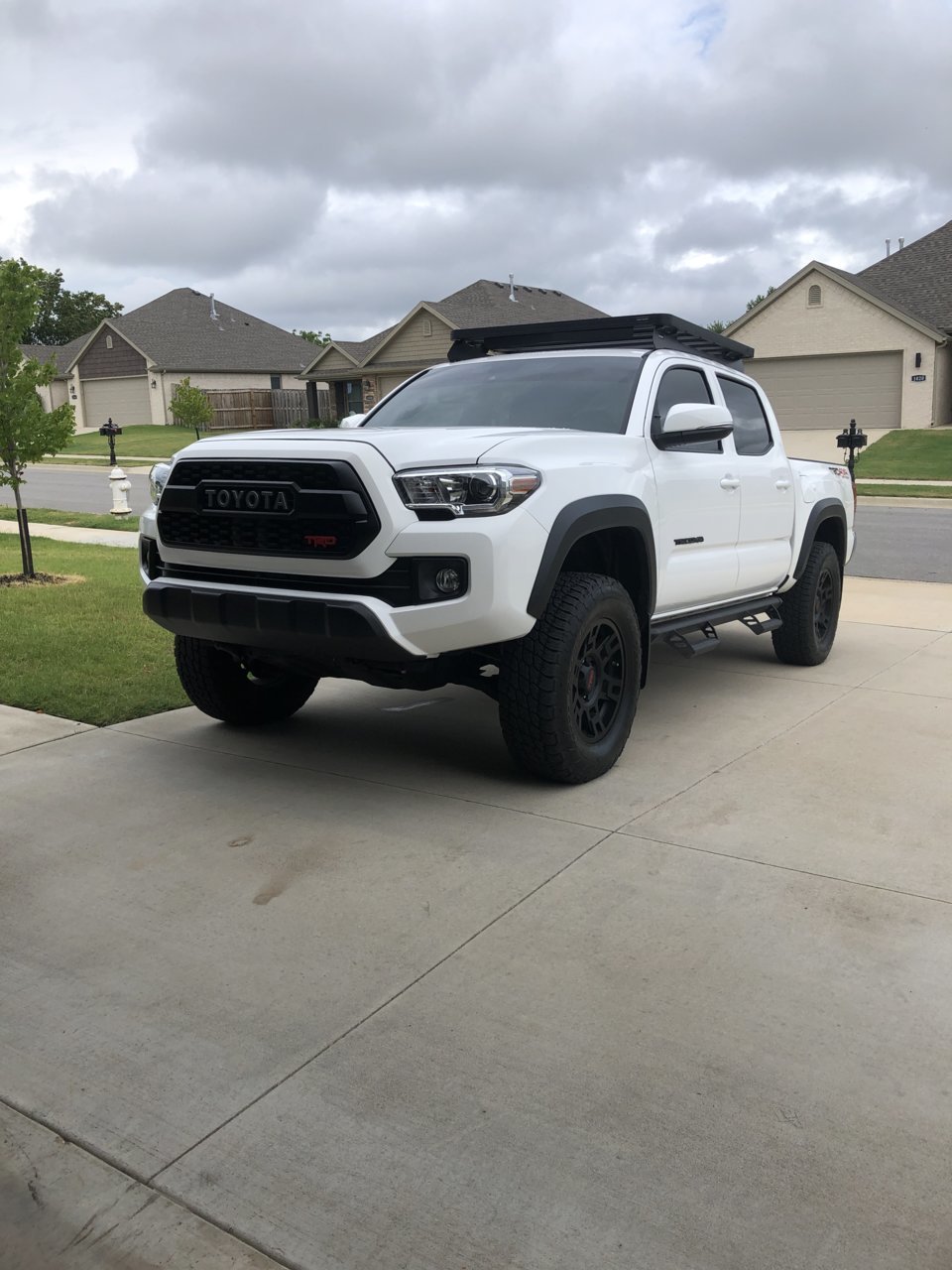

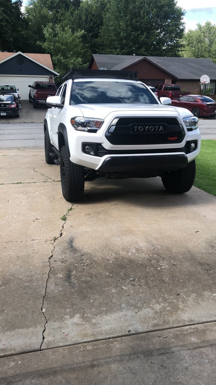

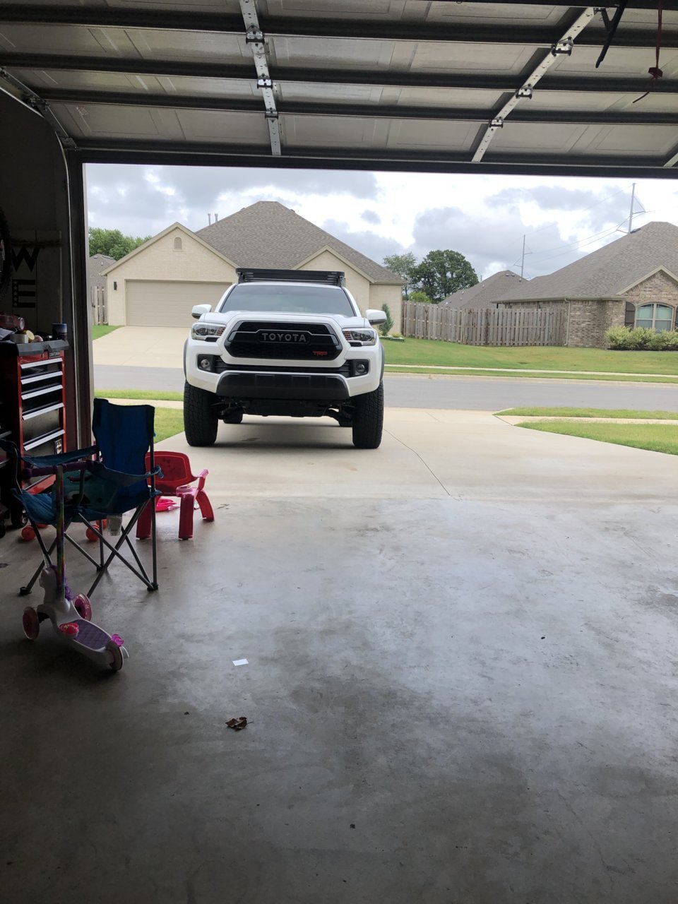

    Post some pics so we can check it out. If possible
  11. Jul 30, 2020 at 3:04 PM
    Jrive01a
    Jrive01a [OP] Well-Known Member
    Mar 6, 2019
    #285664
    98
    2019 toyota tacoma
    Here it is. I’ll take a shot front straight up front view when I get a chance
