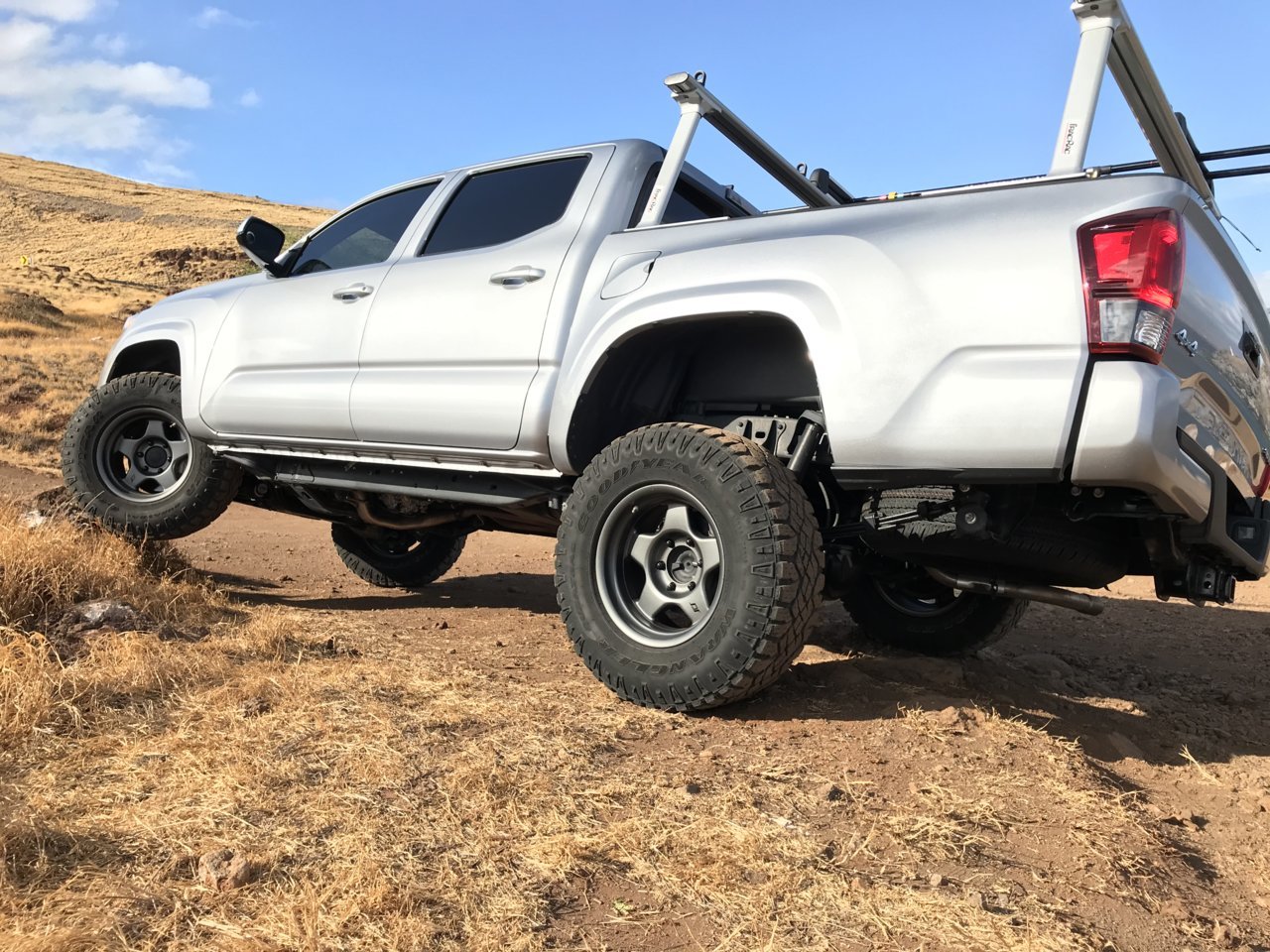

    Yes Spacers have there limits, if ur blasting through woops at 50mph of course with any cheap lift will ride like shirt. And yea u will need king$ for that style driving. This guy on youtube can expalains it better https://youtu.be/_68Hc8GtLko
    My style is jus lo speed mild trails jus to get to fishing spots in hawaii. We worry more about lava rocks cutting tires and getting battle scars at under carriage. Pic stock suspension with 4runner trails

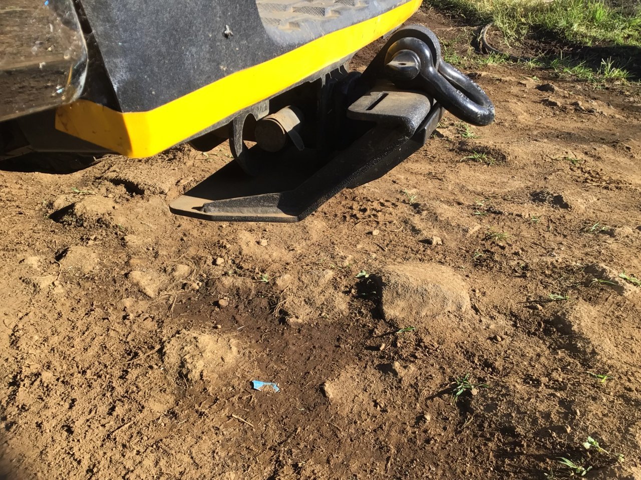

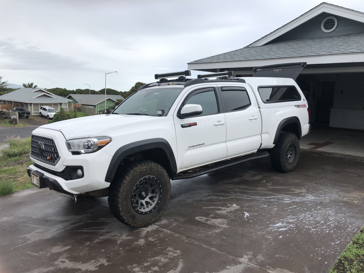

    Most of my fishing spots is on lava field trails, like the load range E , thicker side walls. Gas tank skid plates, trans & transfer case skid plates, lower control arm skid plates, rear diff skid plates, and a trailer hitch skid plates. Beside the factory front skid plates. 11C22916-B699-429C-965E-CAF26D2522E6.jpg
