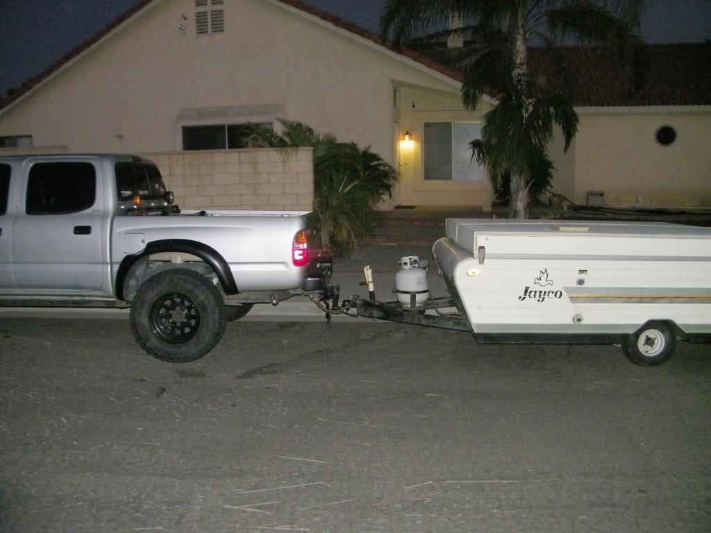

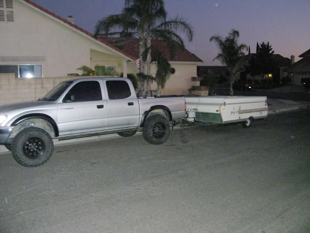

    I picked up the pop-up this evening and I'm definitely glad I got the adjustable hitch. Hardly any sagging in the rear. I had to use all 7 inches of drop. I was quite surprised how my 2.7 handled the weight. It brakes well and I can still get up and go.
