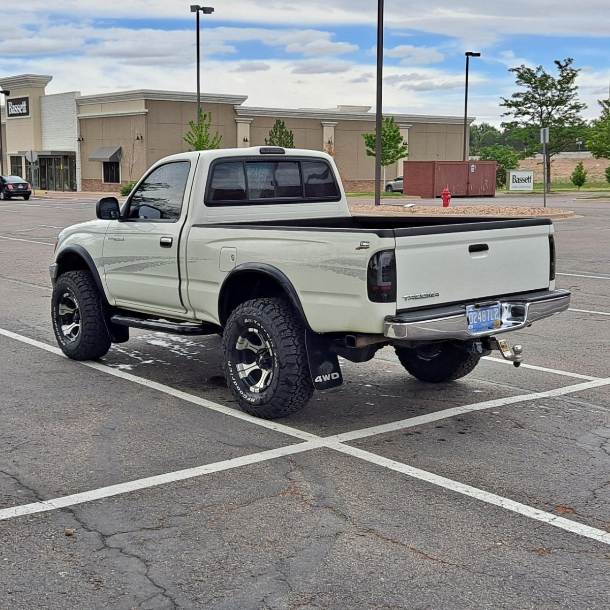

    Yes with helper springs added because I haul a double axle trailer every once in a while,
    The helper springs make it very rough and I will be removing those unless there’s 200 pounds in the rear then it rides smoothly with the helper springs
